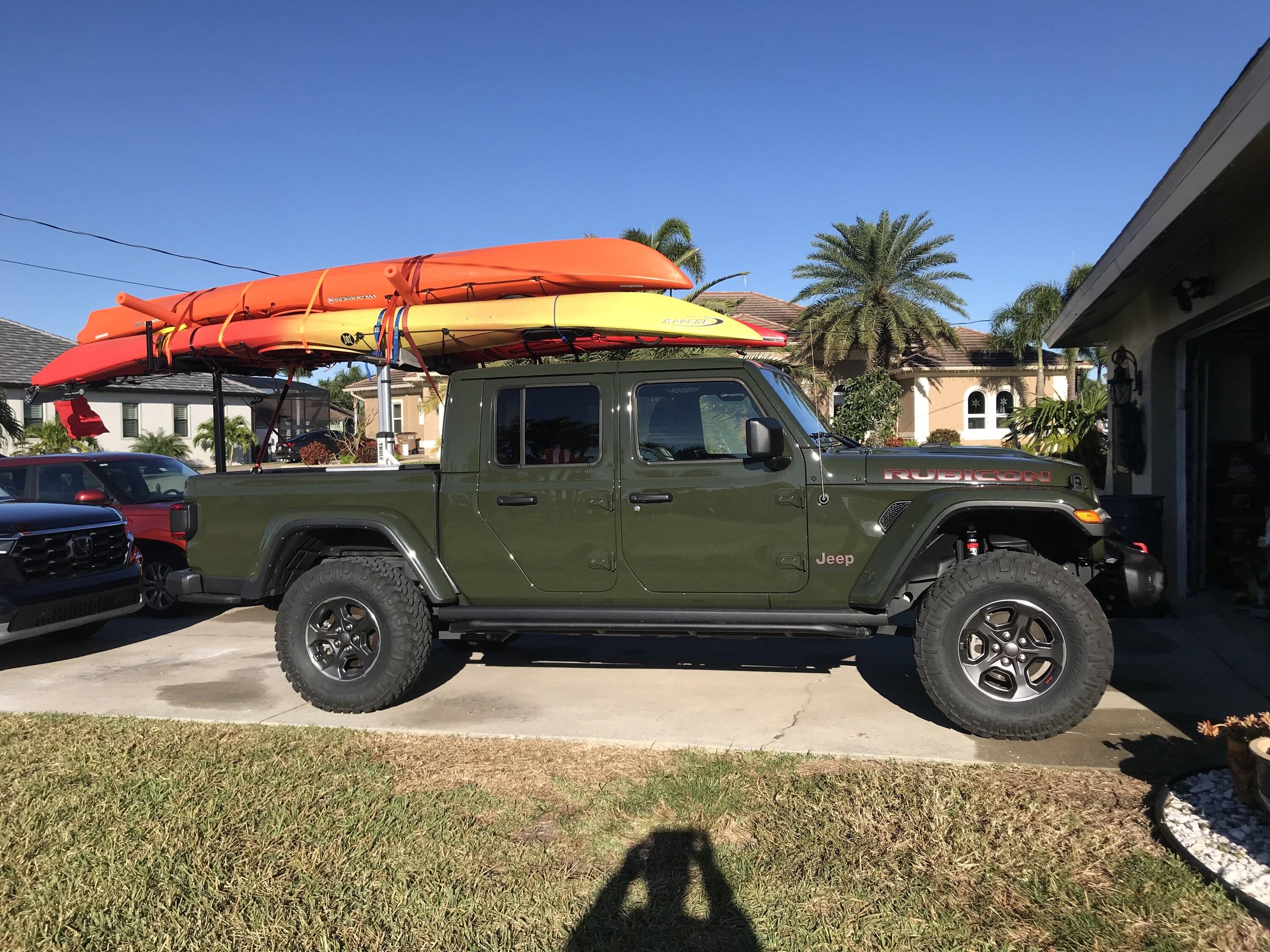

I have 35x11.50X 17 Nitto Trail Grapplers on my 2022 Gladiator Rubicon with stock Rubicon wheels and it drives great. I use the Tazer mini for re calibrating the speedometer and TPMS (Nitto says to run those tires at 32 psi vs the stock Falken widlpeaks which were 37 psi). I did notice a drop in mpg to around 15 mpg on average. That wheel/tire combo may look a bit skinny to some. I like the Rubicon 7.5 wide wheels which is within spec for the 11.50 wide tire. I may eventually get a wider wheel to accommodate 35x12.50 tires.
