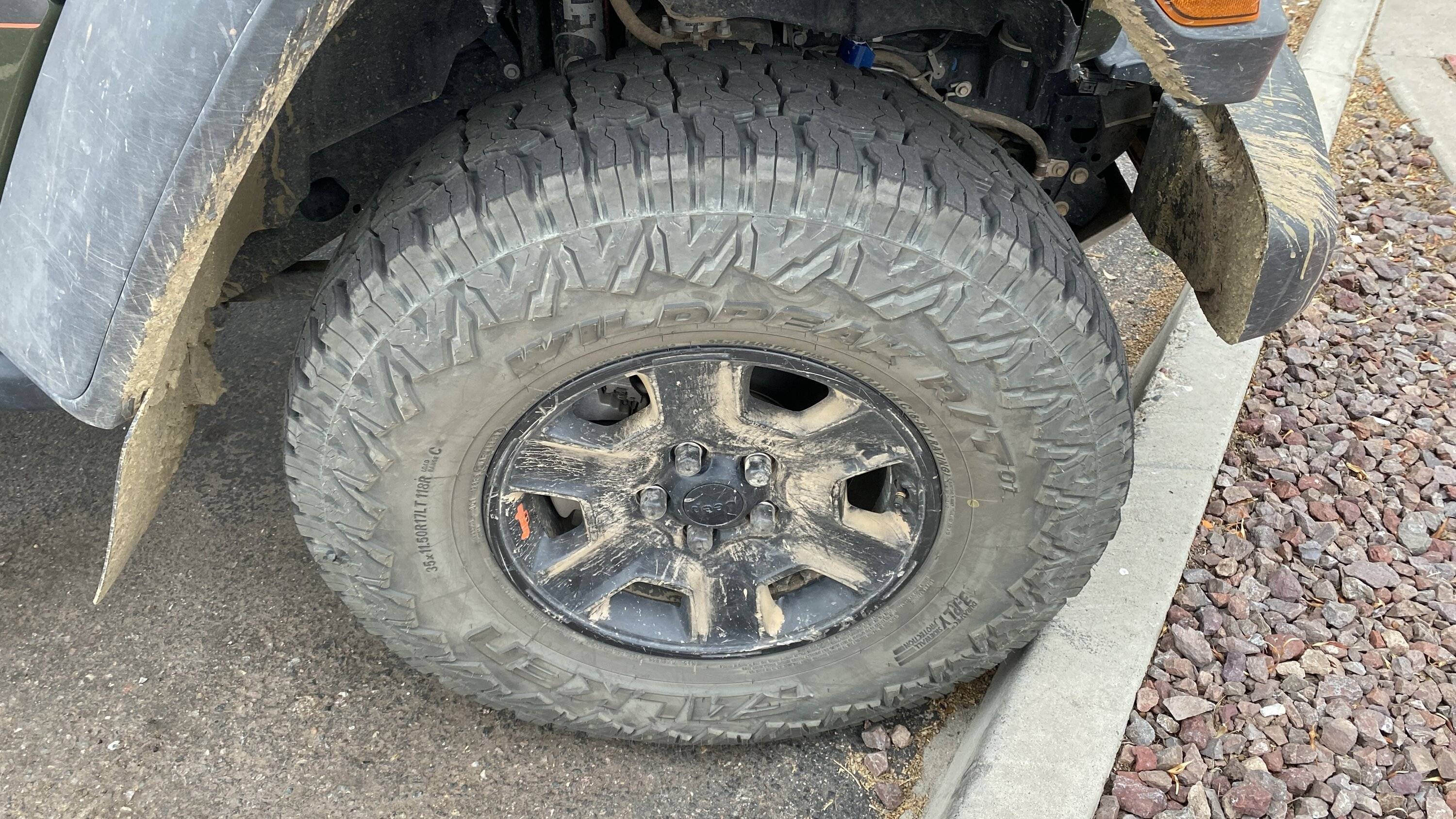

Ridge Grapplers are good but I just got Falken Wildpeak R/T and love them. C rated.
Looks like a cross between Wildpeak M/T and A/T.

That’s why I like them. R/T (or hybrid) tires are the best of both worlds
Have you driven in the rain yet with those tires? I’m interested in hearing how they handle in the rain…the Wildpeak AT’s do pretty well in the rain but if I bump up in tire size I like that the R/T’s are available in 35 x 11.5 size. Also on my last Gladiator I put on 35 x 12.5 Mickey Thompson Baja Boss AT’s on my Mojave and they did fine with the 4.10 gears.
