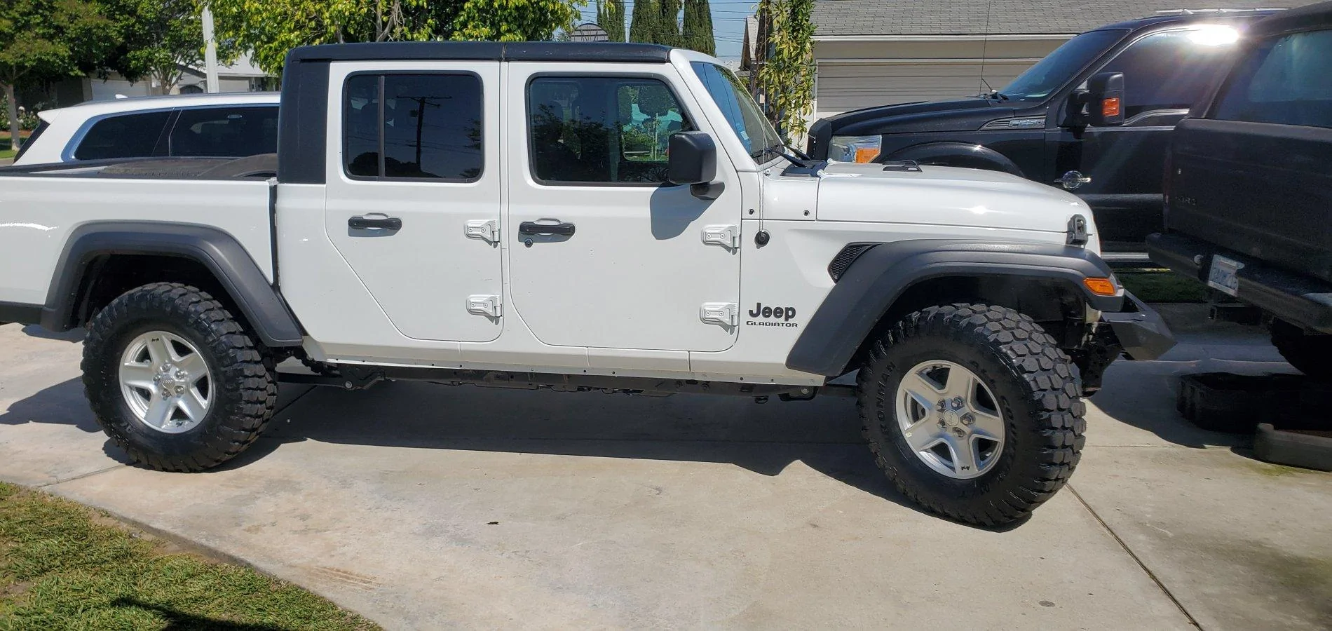

this is my sport s no tow package with 35s I dont rub at all took it offroad with track bar connected no rubbing the only rub I get is at full turn the tire barely hits the track bar.
Thank you. Now I won't be needing to take the shop's word about adding wheel spacers because "it will definitely not fit/rub" without them.

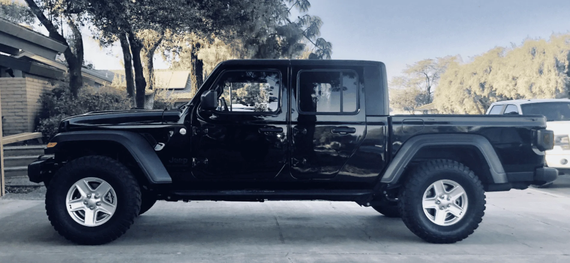

Ran my Sport S max tow with bfg MT 35x12.50s no lift but did remove the air dams (looks much better) and did NOT rub fully flexed. Eventually did a 2” leveling spacers which actually is 1.5” since you have to remove the factory spacer 0.5” spacer, but mainly for aesthetics but also gives to a slightly better approach angle. For the last 1000 miles have been running rubicon take offs 33” (will swap on the 35”s for trail rides). Although a nicer less highway tracking drive, No MPG difference 18 hwy, 15 city, round up, same as every Jeep I’ve ever owned.
Jeep Gladiator 35's, no lift? 20200422_151838
So we are looking at 33s here?

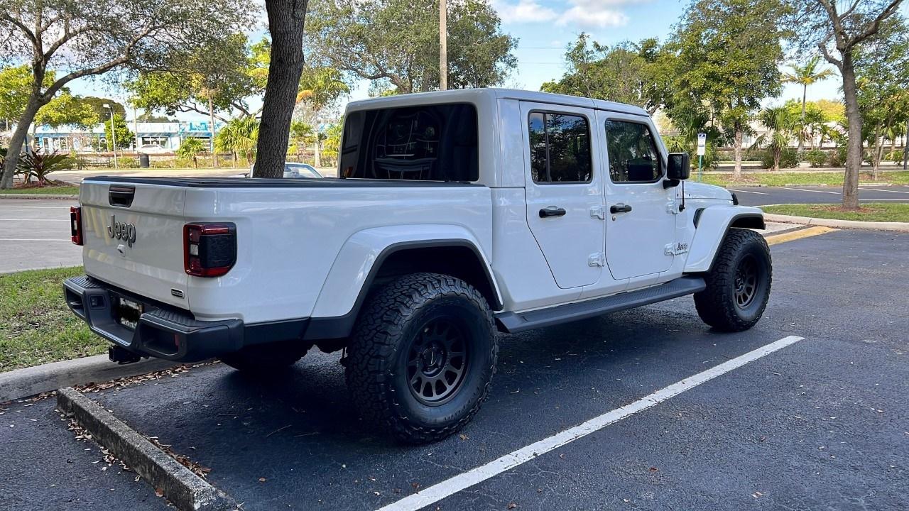

Just got 315/70/17 (35s) BFG K02s installed on Method Race Wheels 703 with stock overland suspension. No rubbing at all and they drive great!
Considering how well it fits stock, I decided to move forward with just a leveling kit.

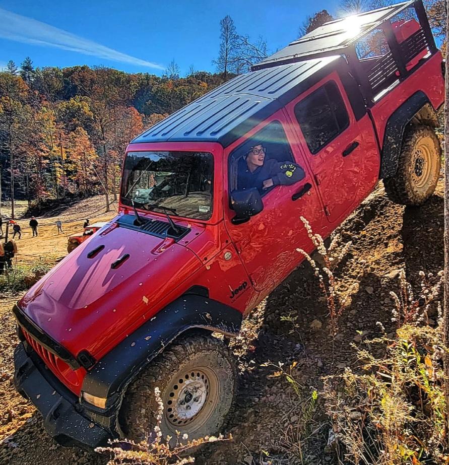

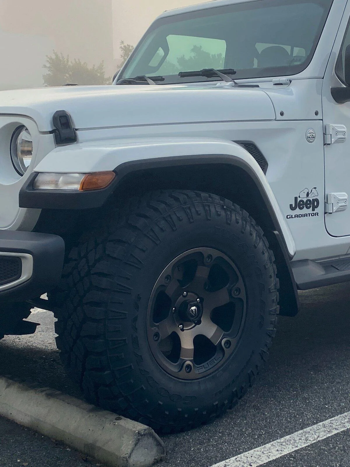

I did 35" tires on Sport Max Tow with no lift.
Modification was cutting a small amount of plastic off the bottom of the front air dam where the tires were rubbing on full left or right steering.
After that 0 rubbing anywhere for street driving. Took it to Hollerwood off road park intermediate trails and with stock sway bar still engaged it only rubbed when the tires were already stuffed and you had to bump it over something. Afterwards damage check there was no scuffing/damage of either the tire or the wheelwell liners.
Wheels were stock spare wheels and tires were 35x12.5 treadwright mud claw 2.
