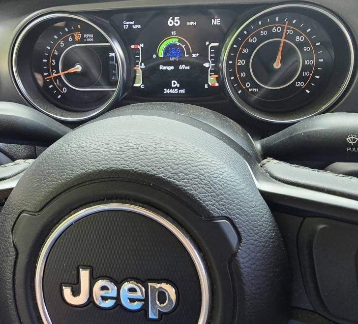

At 55lbs the Goodyear territory 315-70-17 tires haven't affected my daily mileage or power feel over the stock KM3 tires. The extra sidewalks softened the ride quite a bit though.
Jeep Gladiator 35's on gladiator...regear? Screenshot_20250615_225139_Photos

You may have missed the part where I mentioned speed cameras, this is speed limit related, not a fuel savings excercise. The point was I still see 8th at those speeds!
Quite possibly better roads where hes at,
I rarely drive over 115 Km/h in Alberta.
