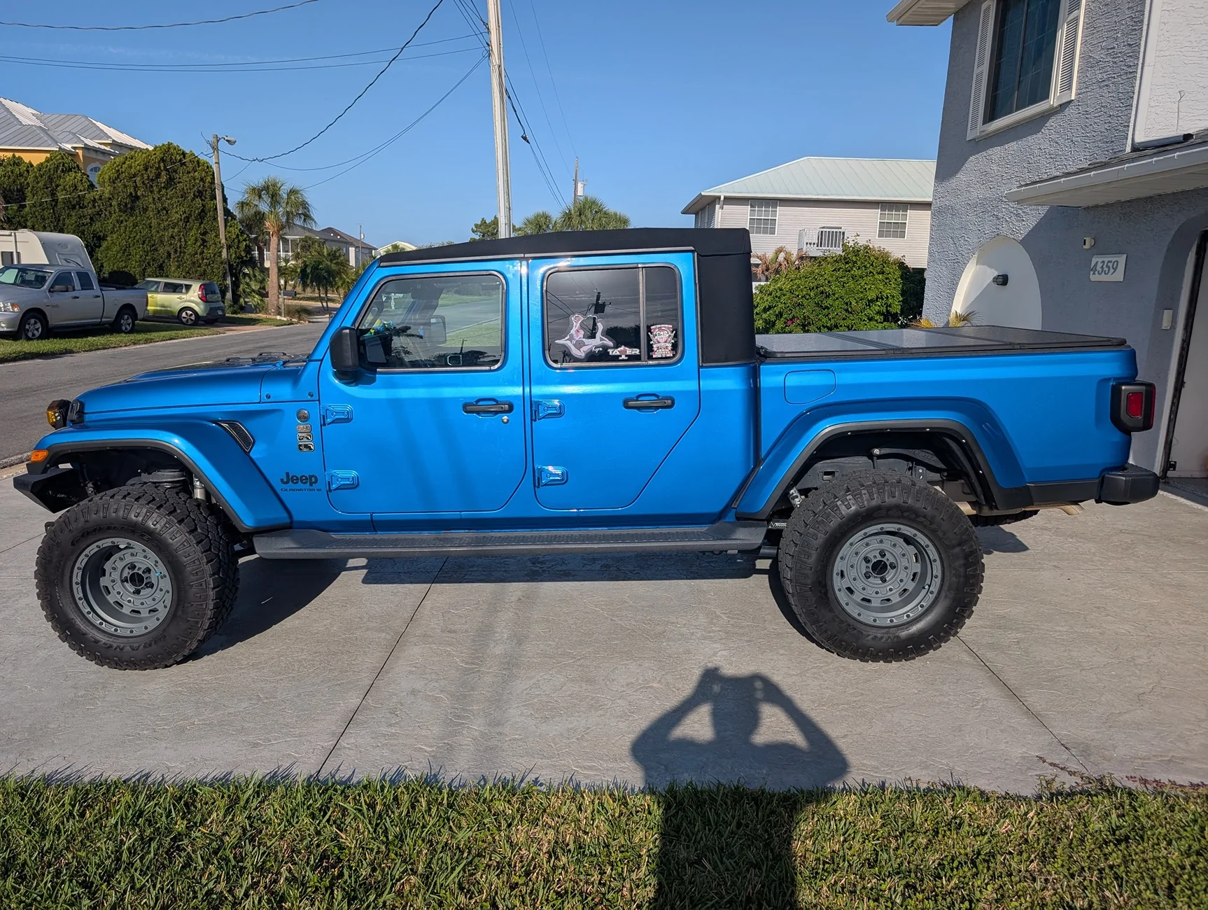

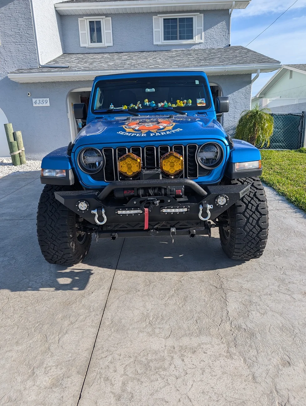

I have a 2024 Gladiator Sport S, I added new Rims with -25 offset, then 3.5“ lift Barricade bumper and open road winch, I used a Tazer Mini to adjust for tire size. I noticed the pick up was a bit sluggish, was hunting constantly for 7 and 8th gears. Mileage was between 15.5 and 17.5, I finally got my regear to .488 with Yukon gears and I added front and rear lockers. I am through my break-in mileage and already changed out the fluid. I used my Tazer Mini to update the gears. I hope to test out the lockers this evening. My mileage has increased to 18.5 to 20.5 combined highway, city driving. I am very pleased with the results. It has more pep now than when stock. If you are in the Hernando County area of Florida, I had all the work done by Brooksville Off Road. They are awesome due quality work and get things done on time. The staff is super helpful and explain everything thoroughly. I think I am done with upgrades for now :)

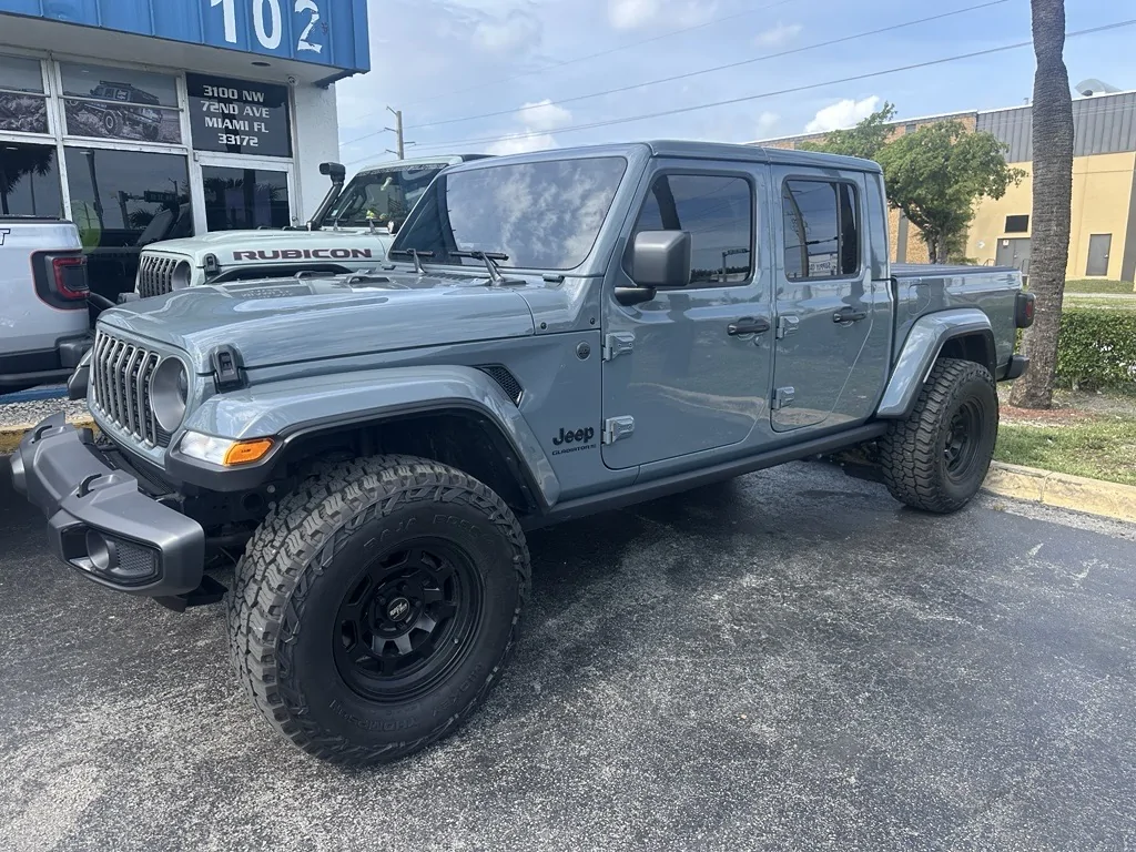

Coming back to the thread. I got the regear done and level. What a difference. Shout out to the guys at Jeep Conversion Solutions in Miami.
