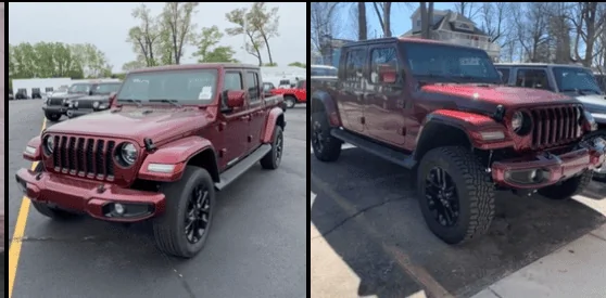

Here's a pic comparing new to now:
Jeep Gladiator 35's on gladiator...regear? Gladiator Before and After

I have a 2.5" Clayton Ride Right lift that gave more like 3.5"-4" of actual lift.

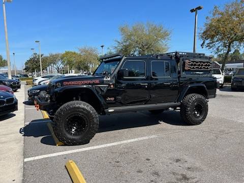

I have just purchased a used 2022 Jeep Gladiator Mojave with a 3" lift kit, 37" tires nitto m/t, and does have rack and a ridiculous amount of lights on the outaide(possible wind resistance. I live in Florida so it is flat and hot. The guy bought vehicle put 3k miles on it, it has 4k miles on it now and spent 49k in upgrades(have the receipts although 6k of it was labor). It was a great deal BUT this thing gets 13 mpg and I never see 8th gear no matter what, and sometimes not even 7th at speed limits. By reading this forum I assume I need to regear to 4.88 or 5.13. Seems like everyone else with 37's are getting MUCH better fuel economy than me. It actually gets better fuel economy in city rather than highway, by like 2 mpg.It does have tazer mini and speedo does read correct. Any suggestions?
Jeep Gladiator 35's on gladiator...regear? IMG_20240227_173502
Nice truck. I'd drive that all day long. ?
How does it run? If you're really concerned about milage, I would start by weighing everything, because that's what's causing your poor economy, dragging all that weight around. At sea level, that truck should run very well. I would find a scale, (truck stop, port of entry, bale fill) weigh the truck, then test drive a new, stock Mojave and weigh it as well.

You are correct it must be very heavy. I will look around for a place to weigh it. It has alot of "stuff" goin on that I am sure weighs alot, 2.5 ton tie rod and drag link Apex, track bars Yeti, Fox adjustable steering stabilizer. The 3" lift is rock crawler and it has these thick control arms that look like they weigh alot. BUT to answer your question as far as holding the road and easy to drive, I do not believe it could be any better. Apparently it was done right as far as the suspension system goes.
Also Fuel economy is more of a by product of the problem. Concerned about at highway speeds never seeing 8th gear and rarely 7th. Wouldnt that be bad on the powertrain because it is working alot harder? That would be the largest concern for me. It is not my daily driver but I find myself avoid taking on the highways because the noise levels, one thing I didnt mention it has a Flowmaster American Thunder dual exhaust which is quite loud which I dont dislike but it is a droner at constant speed, which drives me nuts. I know I will change it soon and that will fix that. Just wanted to explain my first statement.

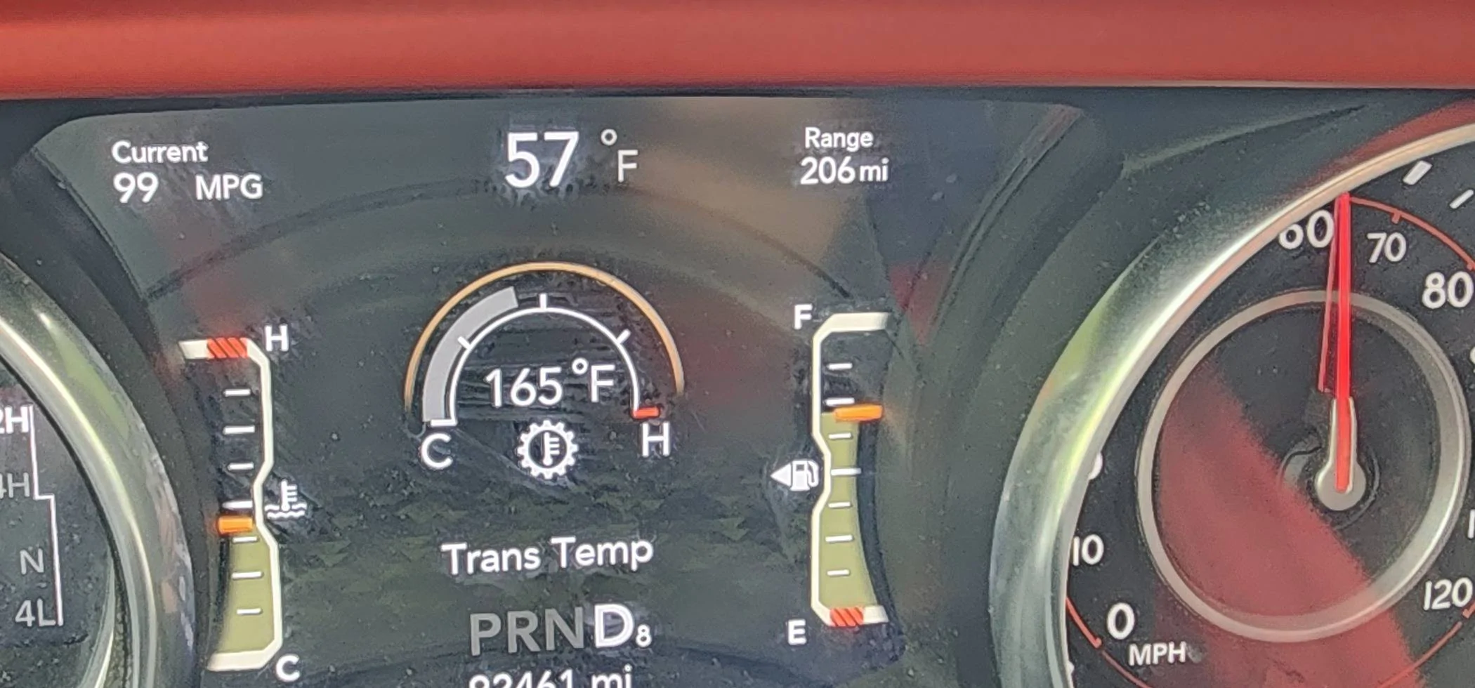

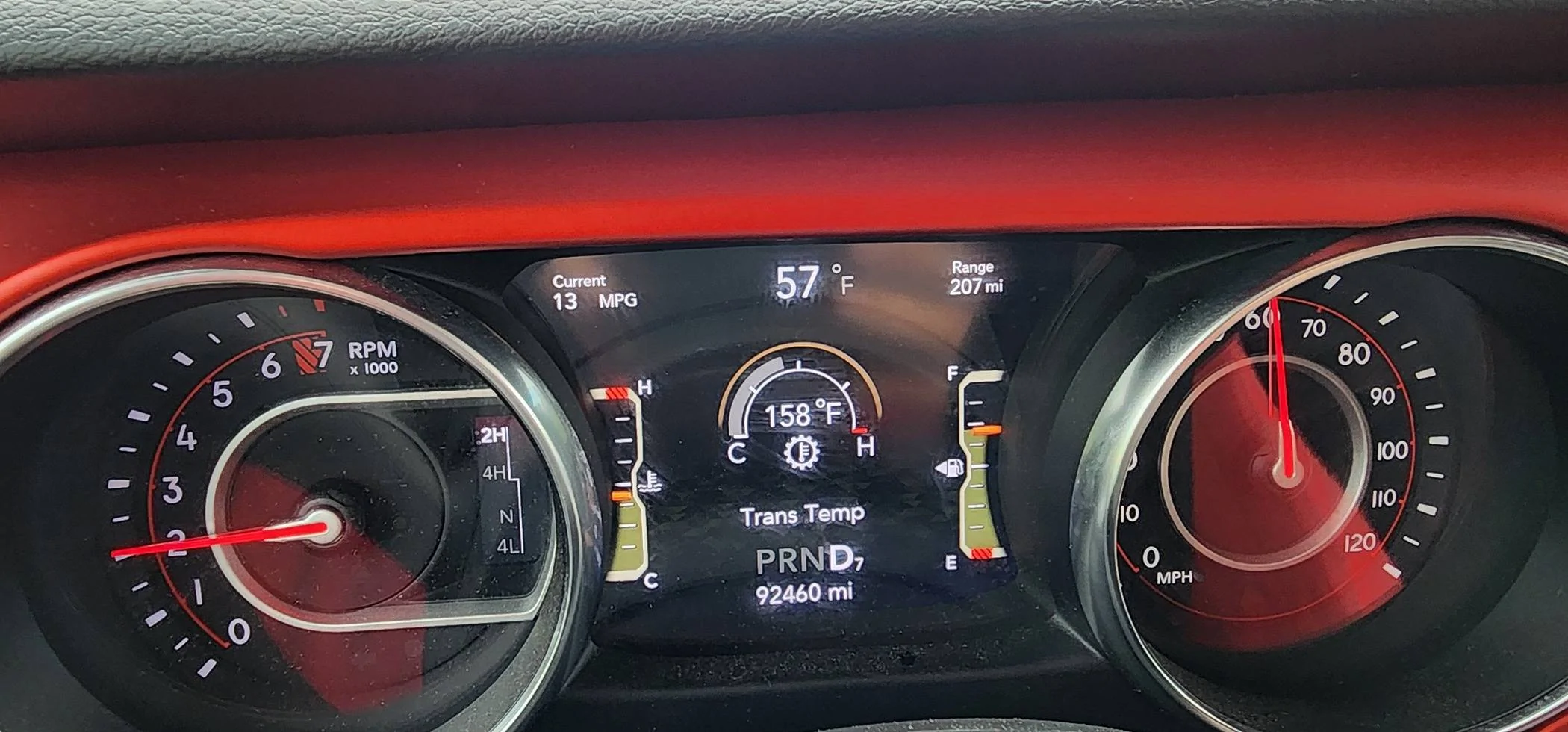

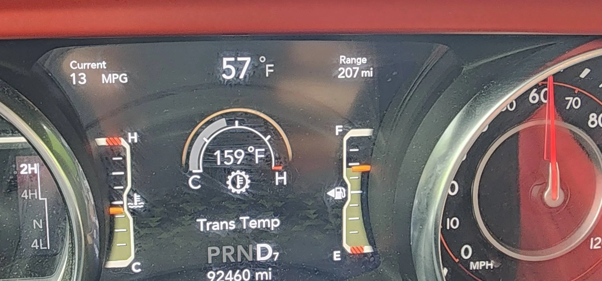

I dont get it. I have 4.10's and my rig sees 7th and 8th all the time. I took a pic today just in case I see another thread like this. I live in WV there are very few flat or straight roads in this state. I say it may be wind drag or power issue. Also remember the more you push down on the throttle the more torque it will give you thus translating into 6th gear on the highway.
Here is the pic I took today doing 65mph. And in no way shape or form was this road flat. In the 8th gear imagine I let off the fuel in the 7th gear image I'm on the fuel.
Jeep Gladiator 35's on gladiator...regear? 20240511_102258
Jeep Gladiator 35's on gladiator...regear? 20240511_102151
Jeep Gladiator 35's on gladiator...regear? 20240511_102145

I actually tried today. On fairly flat road at 65mph I set cruise control and manually shifted to 7th and it was fine BUT shifting to 8th, it will not maintain speed, it slowly creeps down from there. I am sure it just all the "stuff" that has been done to it, has made it very heavy and maybe all the rigid light bars and floodlights on it and don't forget the rack as well. Going to have to regear.
