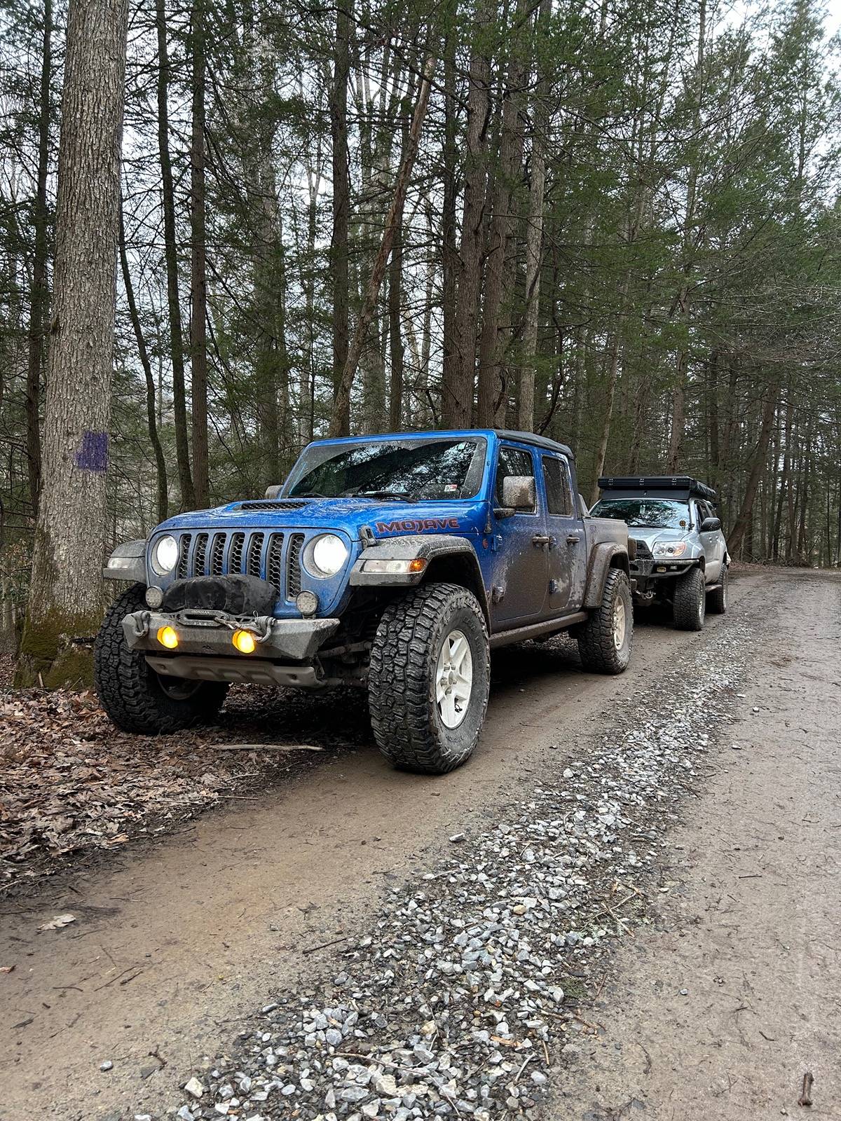

It is a security module and for many reasons Jeep doesn't want it bypassed. But for the most part they are very easy to remove. There are a select few of us that just got the middle finger for no reason. I took off my door, took out my seat, pulled the under steering panel, and then had to proceed to pull the light switch assembly, radio, AC controls, dash trim, and all the knee kicker area. After i finally got it unstuck. Its super easy to deal with now. I can just reach up in there and swap everything around one handed if i want. It was just a dick and half the first time for no reason. personally when it comes to tire size. If you have Rubicon highline fenders, I feel you need 35s min to make the truck look "fitted". I stuff 37s on mine, Looks sick AF if say so myself. But with non highline fenders, 33s look great with just a little more offset. At least that's how i see it in my eye's.
