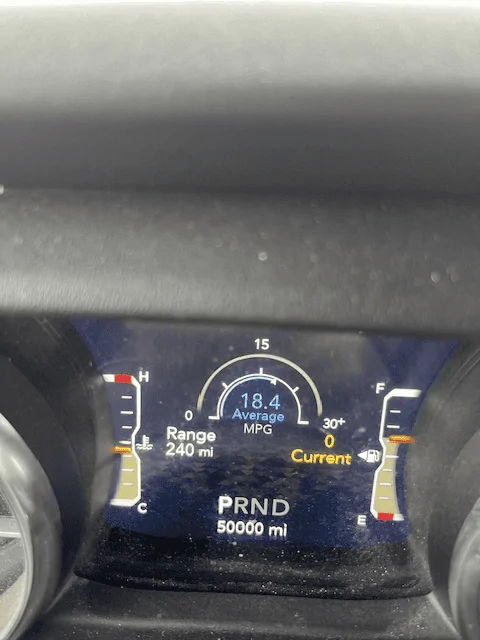

Just wondering, what kind of highway MPG's you get with that?
Sorry, I don't know the highway MPG. I've honestly never measured it.
The dash is currently showing 18.4 MPG, but most of the miles are at 60 MPH or slower.
