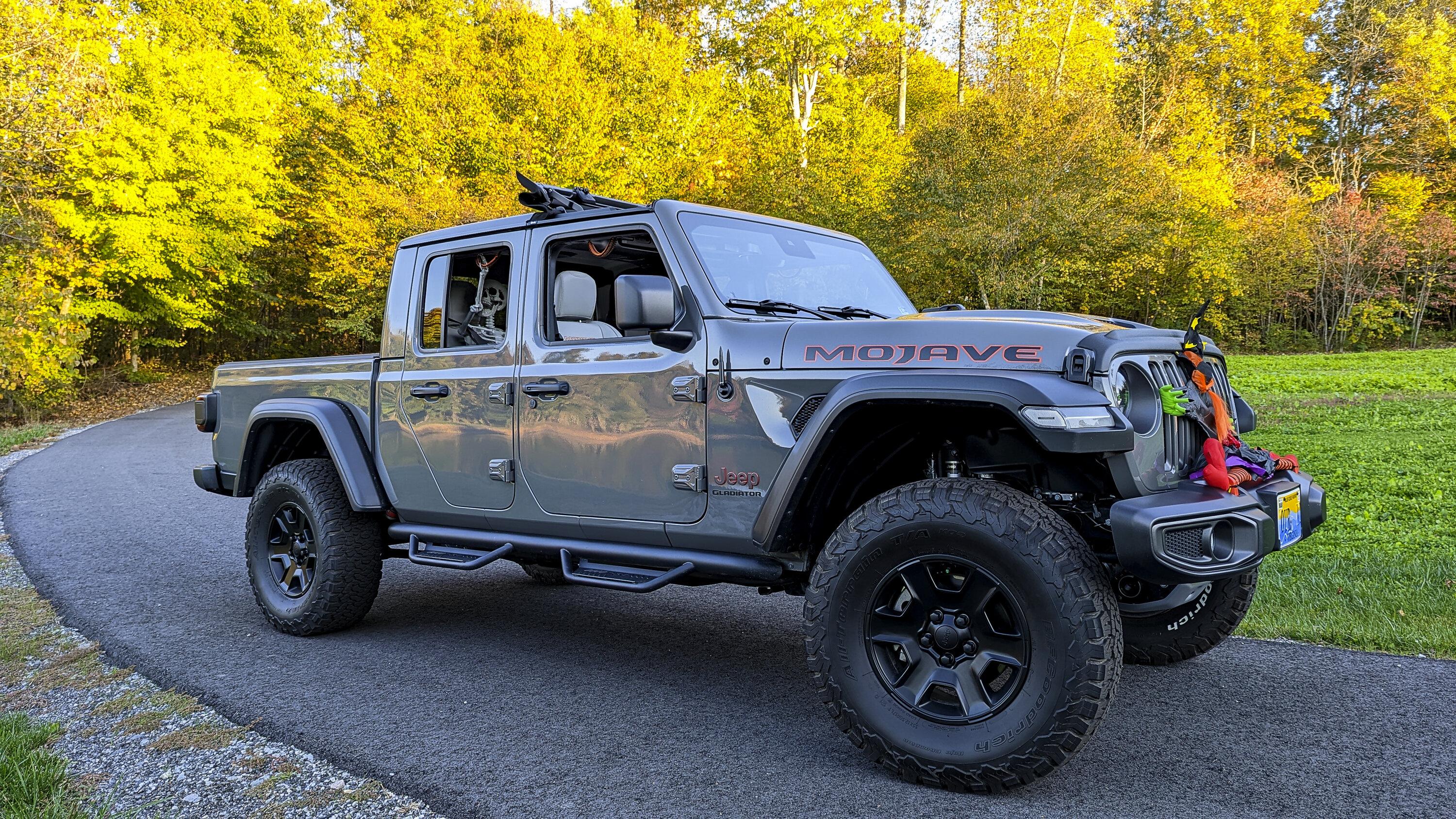

No need to cut, well maybe drill. I drilled a 1/4" hole in the fender liner and zip-tied the liner in about 1/2". Did not pull the tie tight no liner rubbing. It is still possible to rub the LCA at locked wheel, since that is at very low speed I didn't even worry about it.
Nitto Trail Grappler M/T 315/70R17
