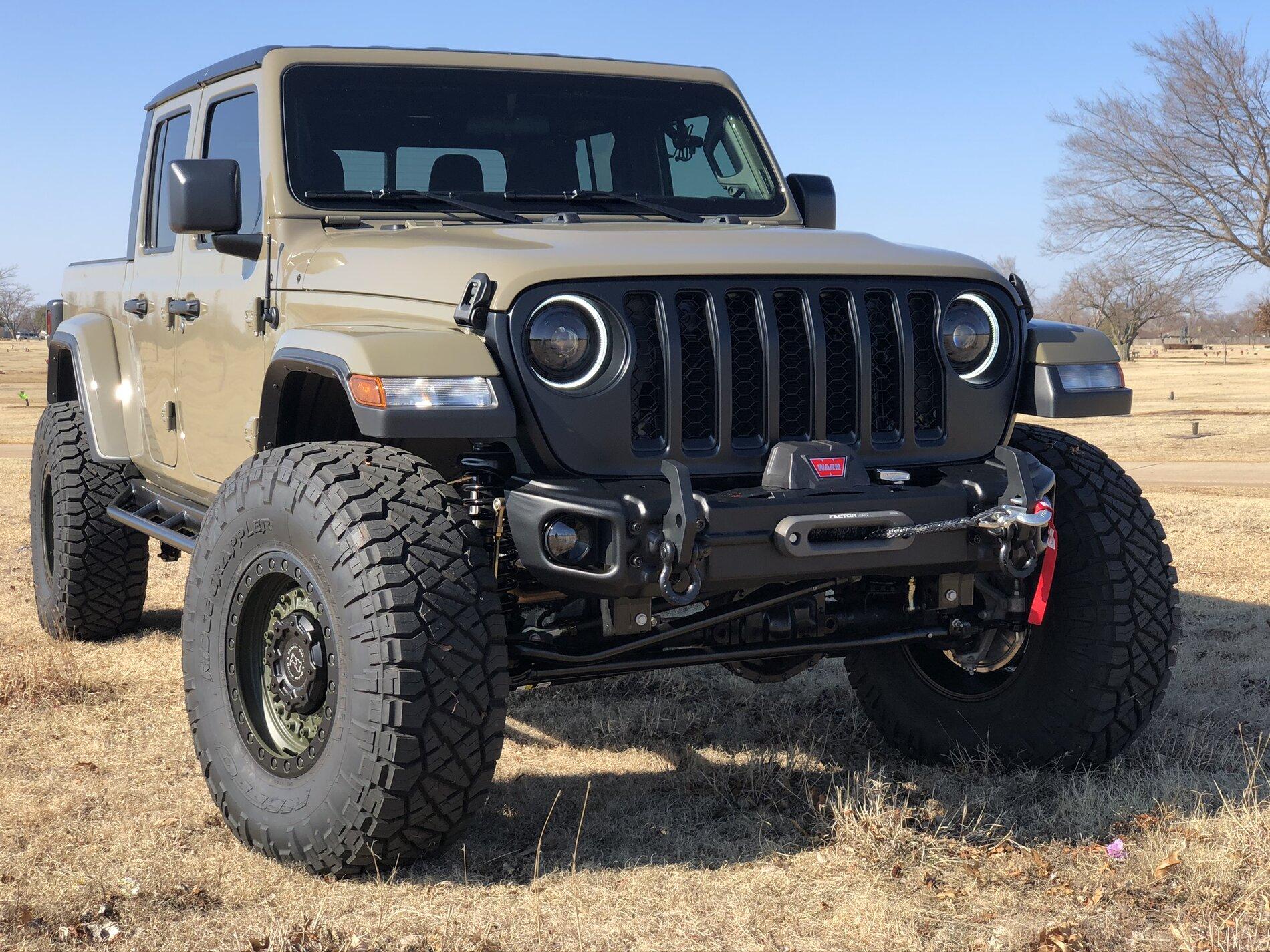

Doc Mike, what bumper are you running?No. I have a Sport S. I am running Rubicon take offs and a Terraflex spacer.
With 35s I regeared to 4.88. I am 6,000 feet above you. I rubbed at full flex and I wheel a lot.
You may be able to live with 35s in Florida.
33s were very livable.
I love the Rat Patrol theme. Here is A jk I did with RP in mind back in 2018No. I have a Sport S. I am running Rubicon take offs and a Terraflex spacer.
