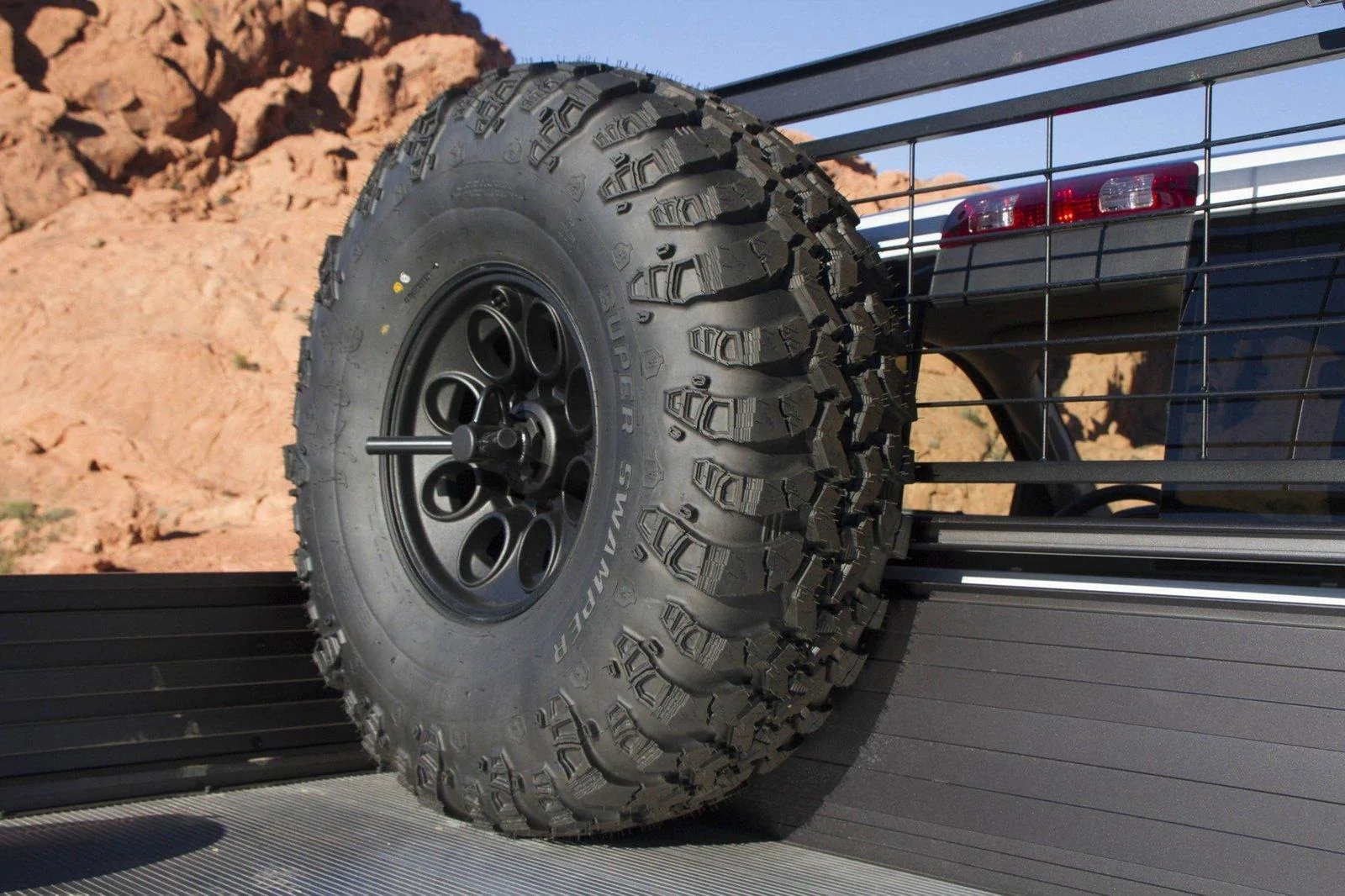

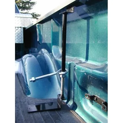

One option is to get a bed mount. I know you say you don't want to drag your spare in your bed but this way it is stood up so it takes up not as much space as throwing back there (not much space in general when stood like this) and stays in place. Some land rover pickups have mounts like this.

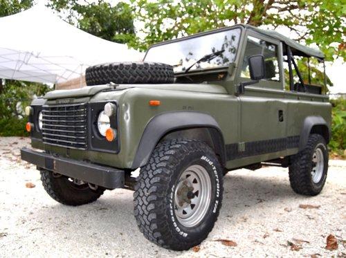

Another option is to mount on your hood, this will however obstruct your view. I wouldn't do this personally. Also used on some land rover pickups.

Also running a tire on the hood is novel but you've got to not only reinforce the hood but find a super skinny spare. Many LR Series owners with tires on the hood hate it from a lost visibility perspective.

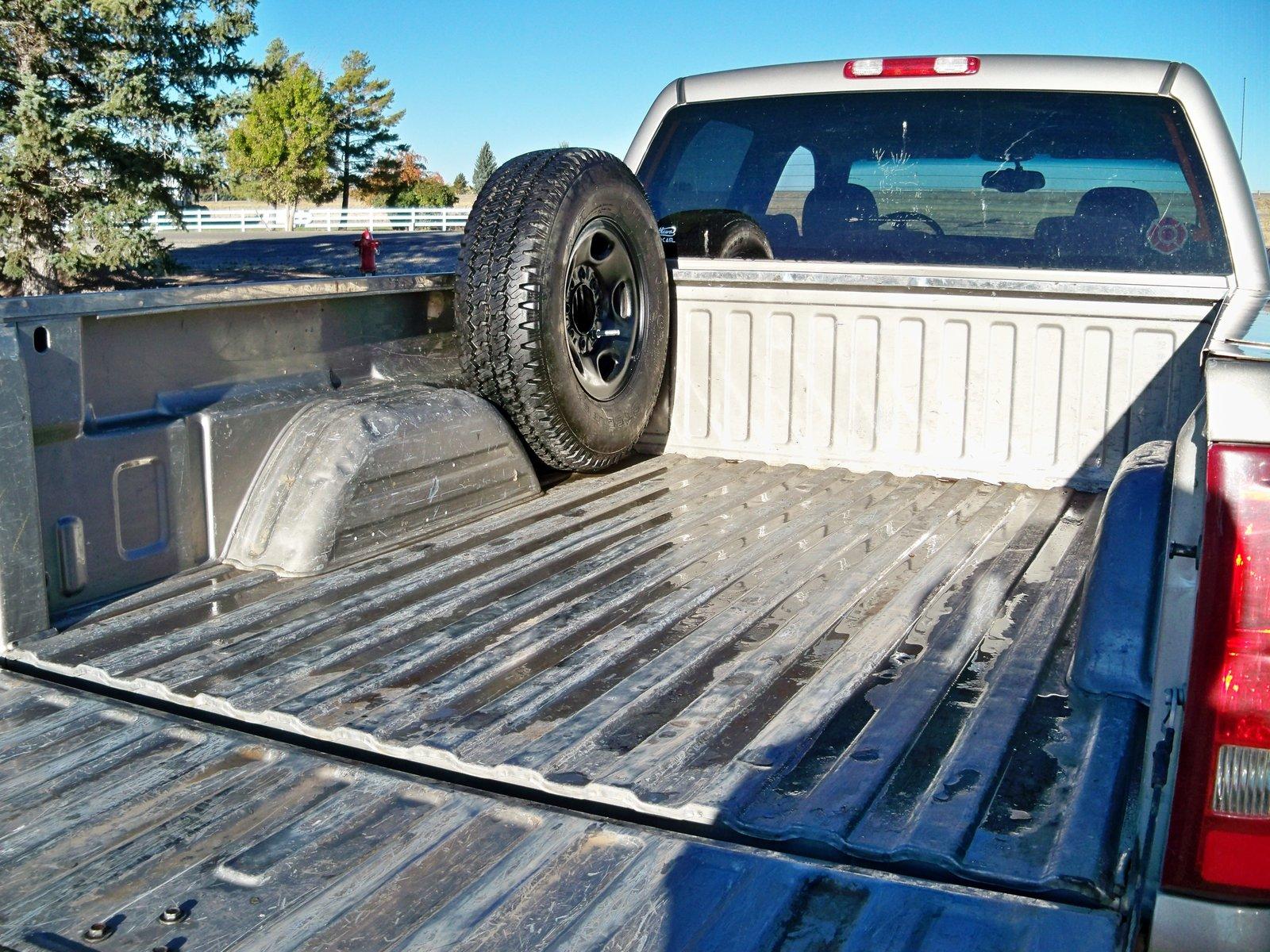

3) Baja truck style spare tire mounted to bed floor. But defeats the purpose of having a truck if you are going to take up 38" out of a 60" bed for the spare tire...

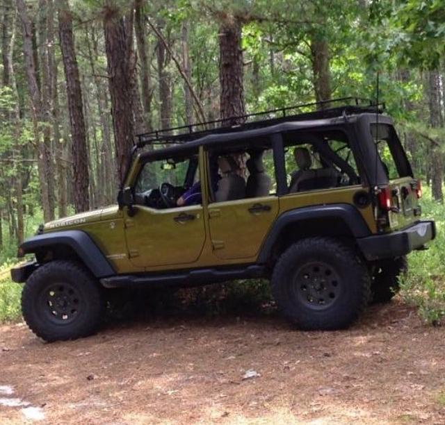

I got a spare tire mount for my JK roof rack and now understand why the limit was 33”, if I recall. After managing somehow to get it on my roof one time, I realized how crazy it was and never tried again.

As you can see below I don’t like to carry a spare on the tailgate of a JK either... I love the visibility and access to back without it. So the idea that it can be under on a Gladiator is awesome!!!

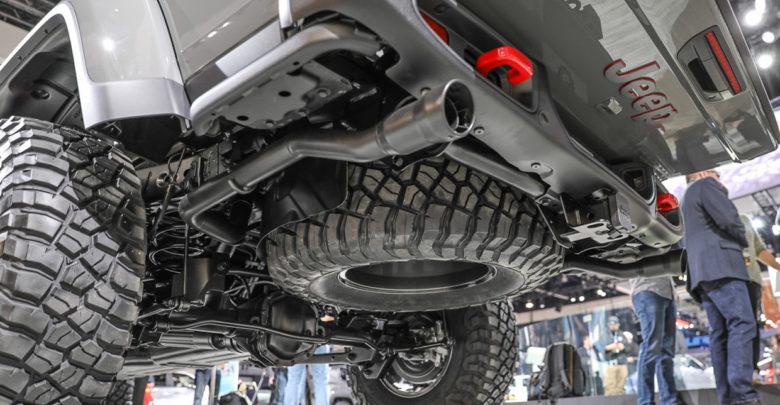

If you look under the JT it looks like the exhaust and rear axle and other parts are in the way. So it would be difficult to put a mount down there.

The amount of space the baja carrier takes up because of the way it sits in the bed makes getting a pickup almost useless.

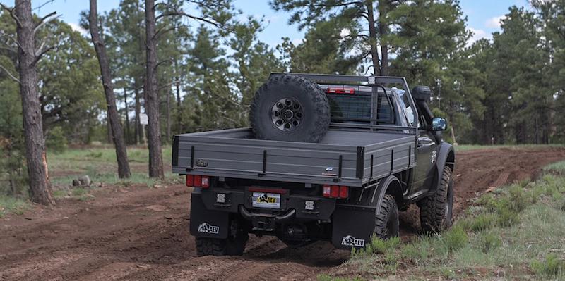

My plans are to run the spare mounted similar to what AEV did on the tray bed rams they built.
I was thinking about that, it still takes bed space and blocks the rear view mirror but will get the job done. I have to think things thru really well before I drill mounting holes or cut anything this time. My old TJ wasn't so lucky when it came to my drilling and cutting. lol.

Thanks. I saw that pic on another thread, but now that I think about it, mounting the tire parallel with the bedside instead of the cab, would really cut down on the loss of rear visibility. I would need a tire mount that can be easily removed for home depot tips. With a bed packed full of camping gear, I may just be able to use the tie-down points along the bed rails instead of a permanent bed mount, possibly make a simple frame/cradle for it.
The way these things mount it wouldn't be hard to remove.
