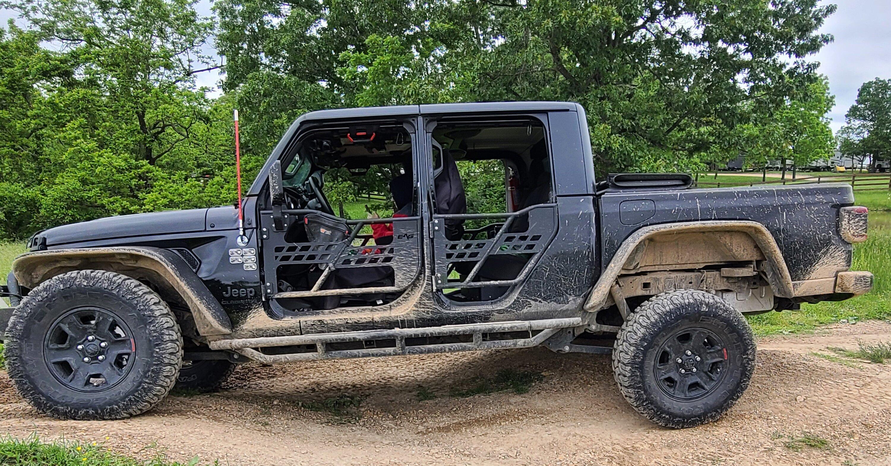

35s on my gladiator, traded in at 16k miles, so probably 12-13k on tires. No complaints, but not a lot of wheeling in the gladiator. Ran these at 27-28 psi on the road, 15-20 on the trail.
dude the contrast of the mud against the black paint is so fucking cool. My brain initial thought said 2 tone for a hot sec.
