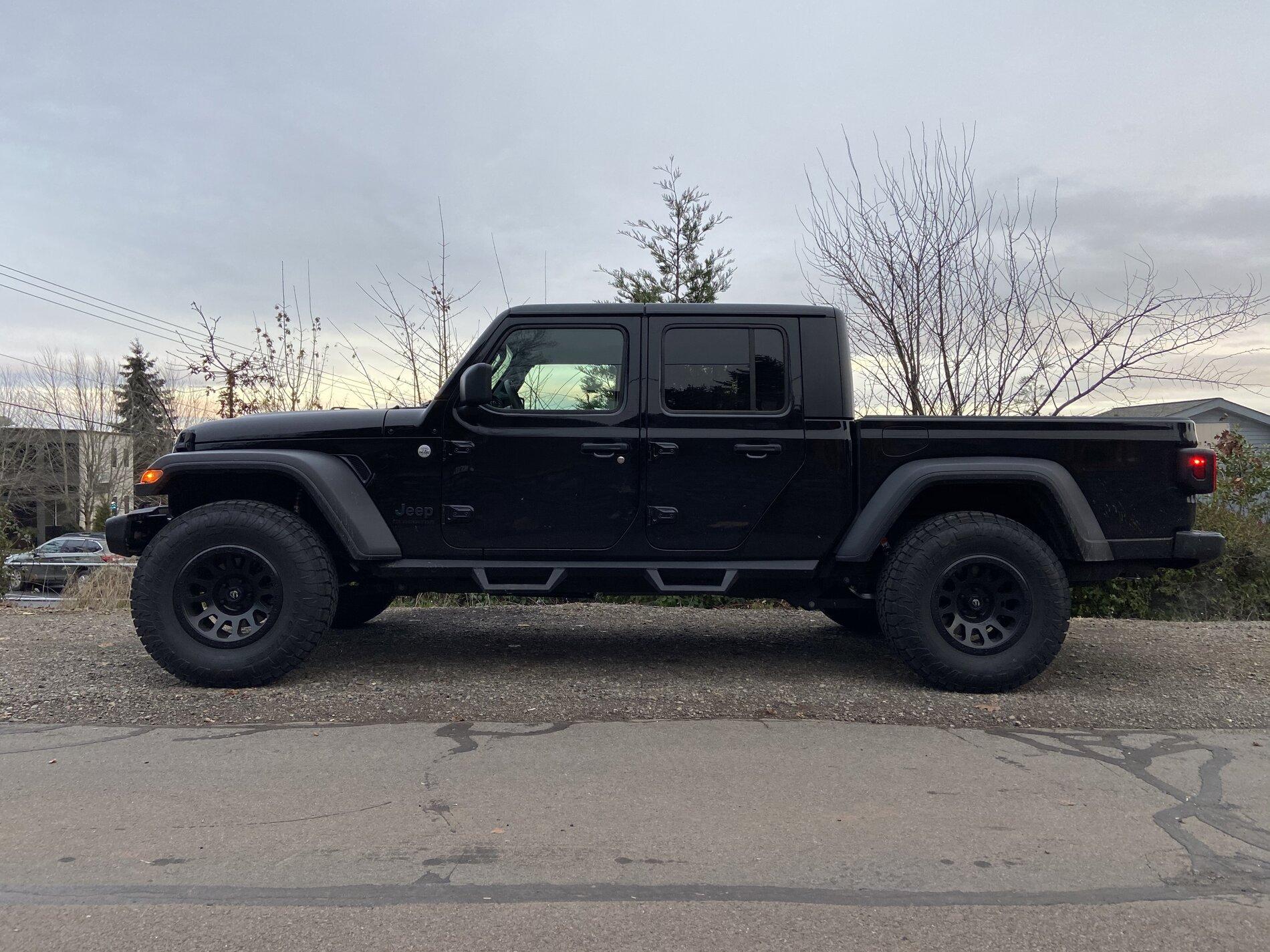

Manual sport. I already swapped to 4.88. 35”x11” tires. Swapped in rubicon springs and a .5” puck in the front to level out a bit. I’m running 2400rpm at 70mph which is what I wanted.
Jeep Gladiator 37s or 35s on Manual Sport BA215856-1329-4033-AACC-C788A7A98C85
