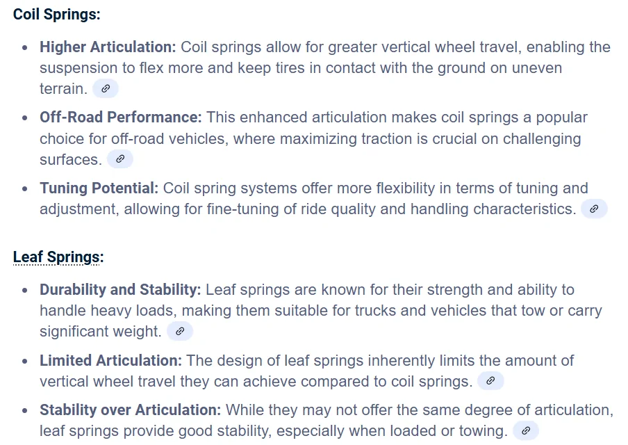

Here's a really good summary, and since these Jeeps are aimed at those who off-road and need articulation (thus the solid front axle setup), leaf springs on these would be a step back by decades.

So - who here would buy a Gladiator with LEAF SPRINGS.
Be honest.
