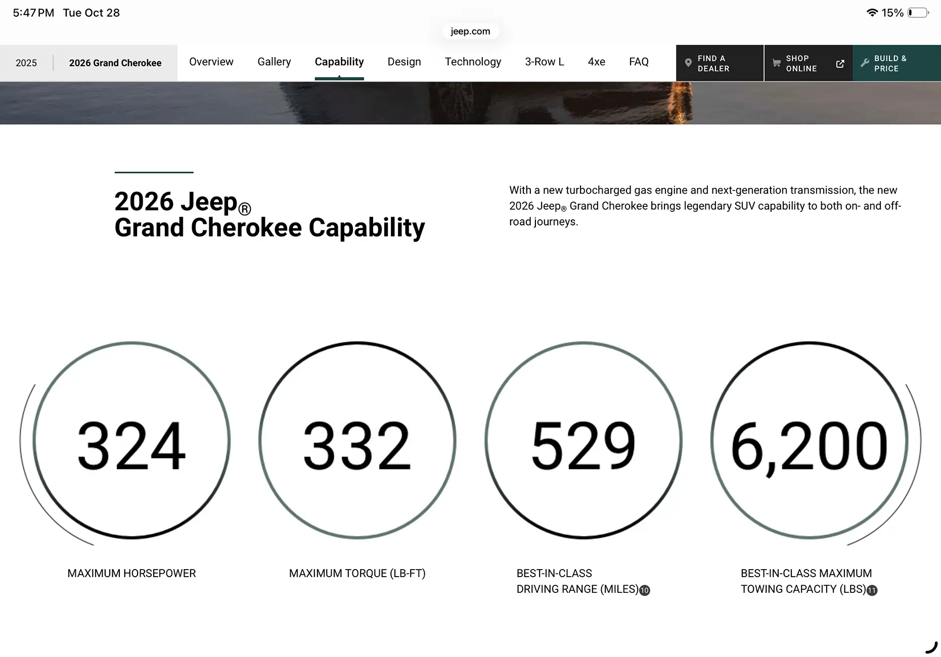

Jeep just released the info. On the 26 Grand Cherokee and the engine lineup which is what I’ve been waiting on.
Just saw on another utuber that the 2026 Grand Cherokee will be offering the Hurricane engine….
but
it will be a 4 cylinder Hurricane engine…that still makes more juice than the 3.6.😡
smlobx
Eddie
Jun 28, 2018
87
2,658
4,543
Mid Atlantic
Semi retired consultant

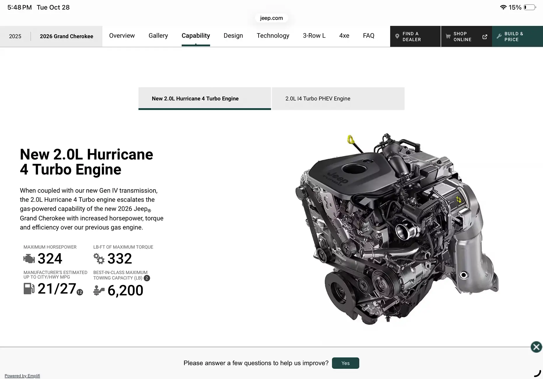

And here it is on the Jeep website..
jmr
Jim
May 25, 2024
213
419
Wentzville, MO
'24 JL Unlimited Rubicon, '25 JT Mojave
Software Developer
Is the new EVO Hurricane still a DOHC or Multi-Air the 2.0 Turbo Alpha Romeo?
40,496
54,010
If you can do an image search on the forum, you'll find the first half of that image was in another post last week. Apparently the thing has been in the works for a while in the Grand Cherokee, and it was show to have a far better torque curve, coming in sooner than the 3.6. Makes sense - a turbo can generate more low end than a NA engine

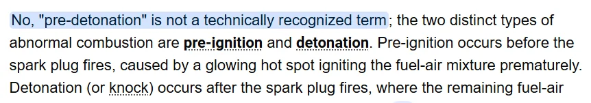

pre-detonation,
There's no such thing. There's that term again that keeps getting repeated.
It's either pre-ignition OR detonation. They are two different things although pre-ignition can lead to detonation.
I suspect that was written by someone at hemmings or one of the car blogs.
These car blogs and magazines dumb down the auto world..
