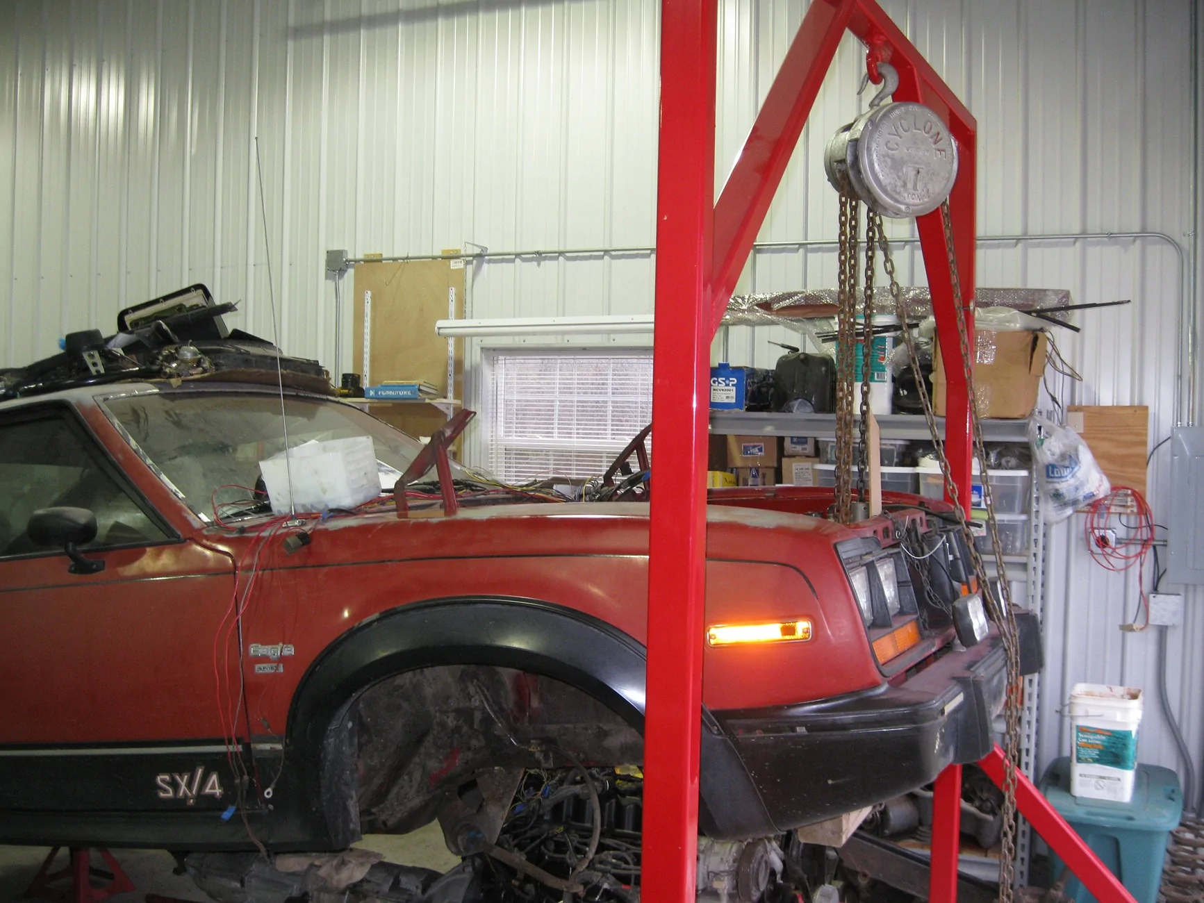

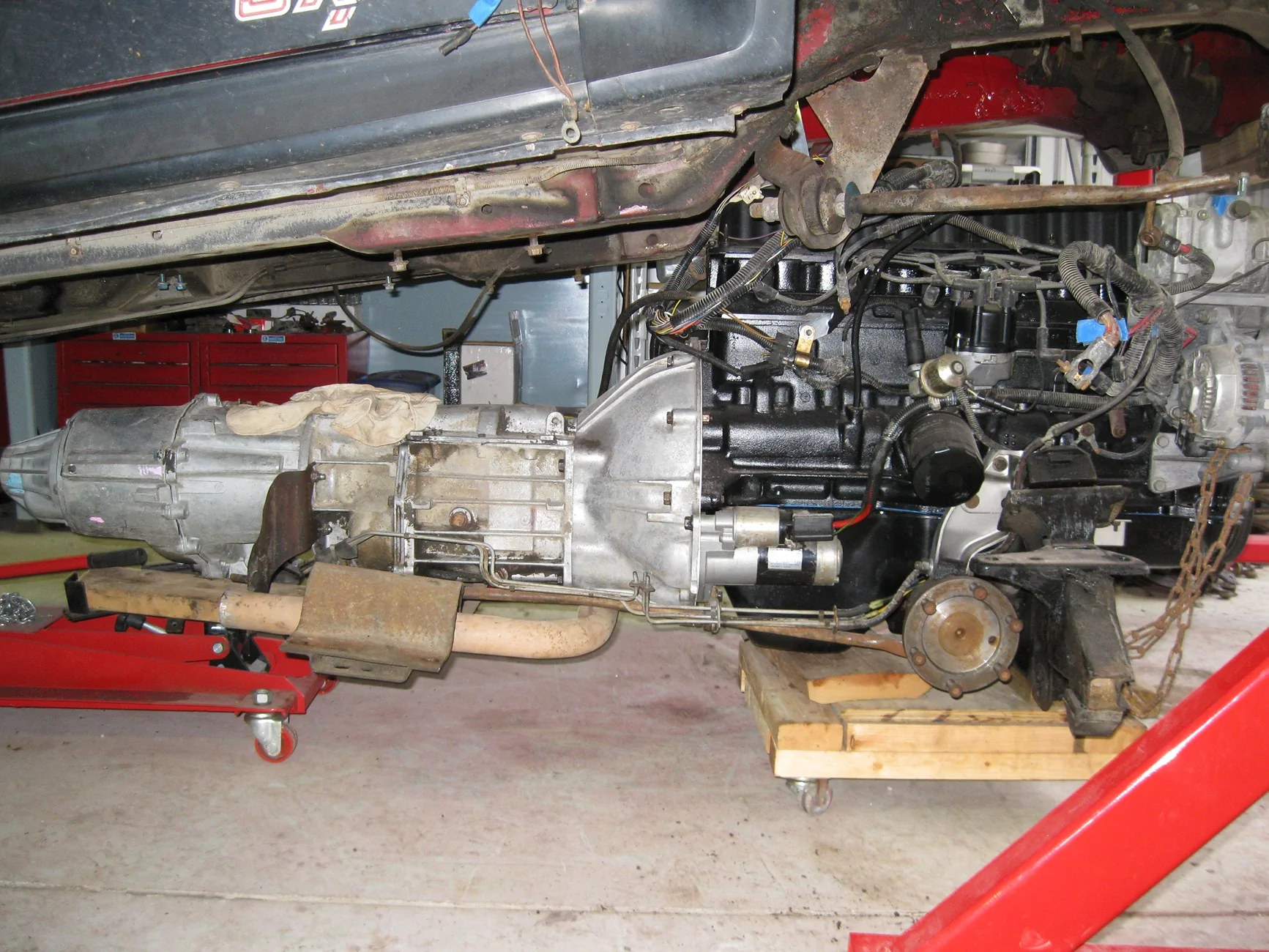

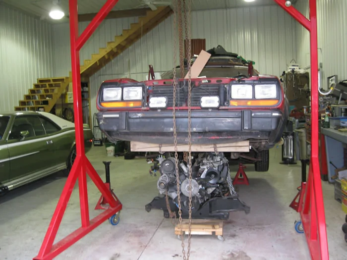

I don't have a lift and really wish I did.. I can no longer lay under a vehicle to work on it. My inner ears, and Meniere's, have caused me to get sick and a massive headache when I try to lay under something to work on it. Even changing oil is a real challenge these days.
I actually used a gantry crane and chain hoist. It allowed almost complete assembly, including most wiring, installation of the front differential, front driveshaft, transmission, transfer case and more.

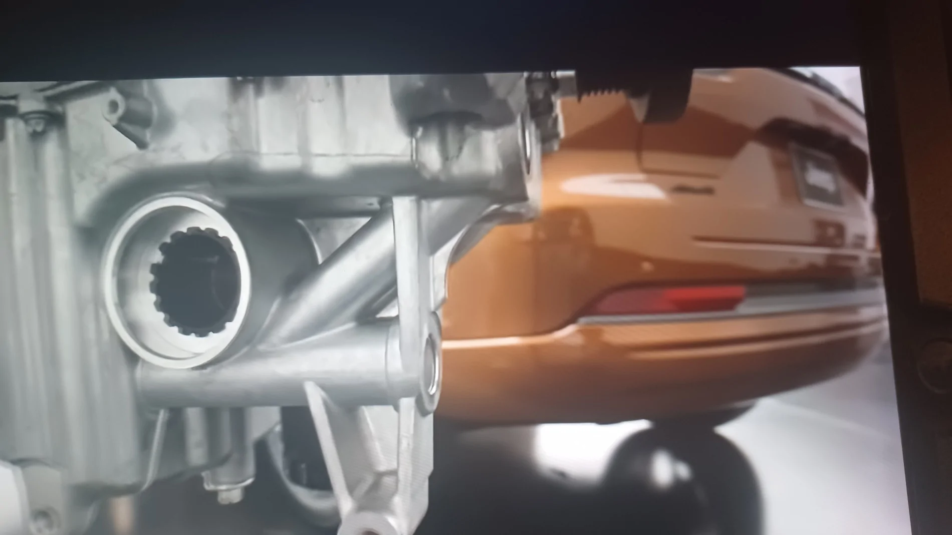

The 4.2L I6 that Chevrolet used in the Trailblazer in the mid 2000s was like this. I believe a stub shaft for the front differential had to pass through a hole through the oil pan to get to one of the front tires.
So yanking the engine required tearing that apart, too. Or dropping all of it out the bottom in the cradle - like it was built.
Ive heard of designs like this, never seen one. Gotta say it sounds like a pain in the arse. What’s this look like to you?
