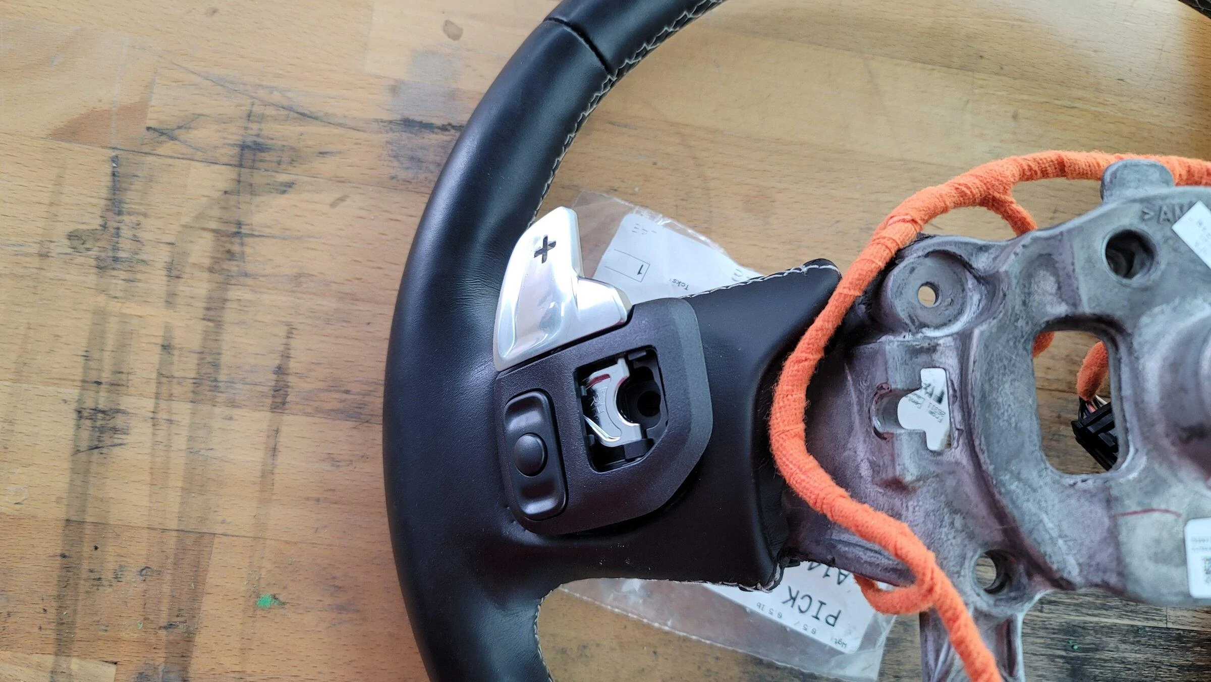

Actually, it turns out I was wrong. The back of the Mojave wheel is not the same as the back of the 392.
Jeep Gladiator 392 Steering Wheel Retrofit 4D0C8D42-9076-4D16-A96B-A262E3A618E9
This disappoints me a lot. I really want paddle shifters, but I don’t want to replace my orange stitched steering wheel for a bronze stitched wheel,especially when they’re nearly identical otherwise.
Edit: Looking more closely at your pictures it appears the inside of the steering wheel is basically foam. I wonder if I could do some careful surgery to make the openings in my Mojave wheel fit the paddle shifters. I guess I should probably wait until someone confirms they work in our JTs before I spend the time and money, and potentially ruin my steering wheel.

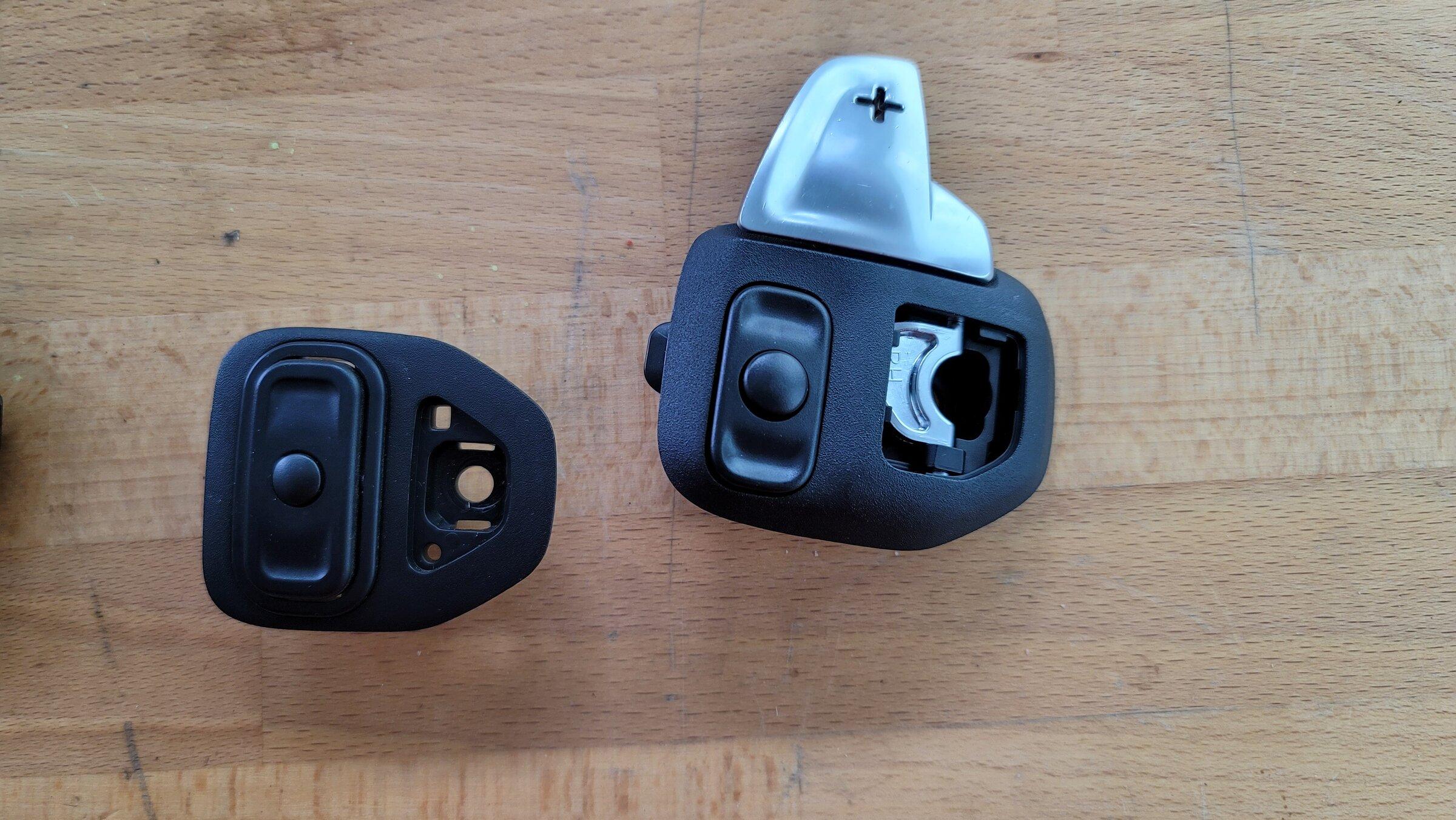

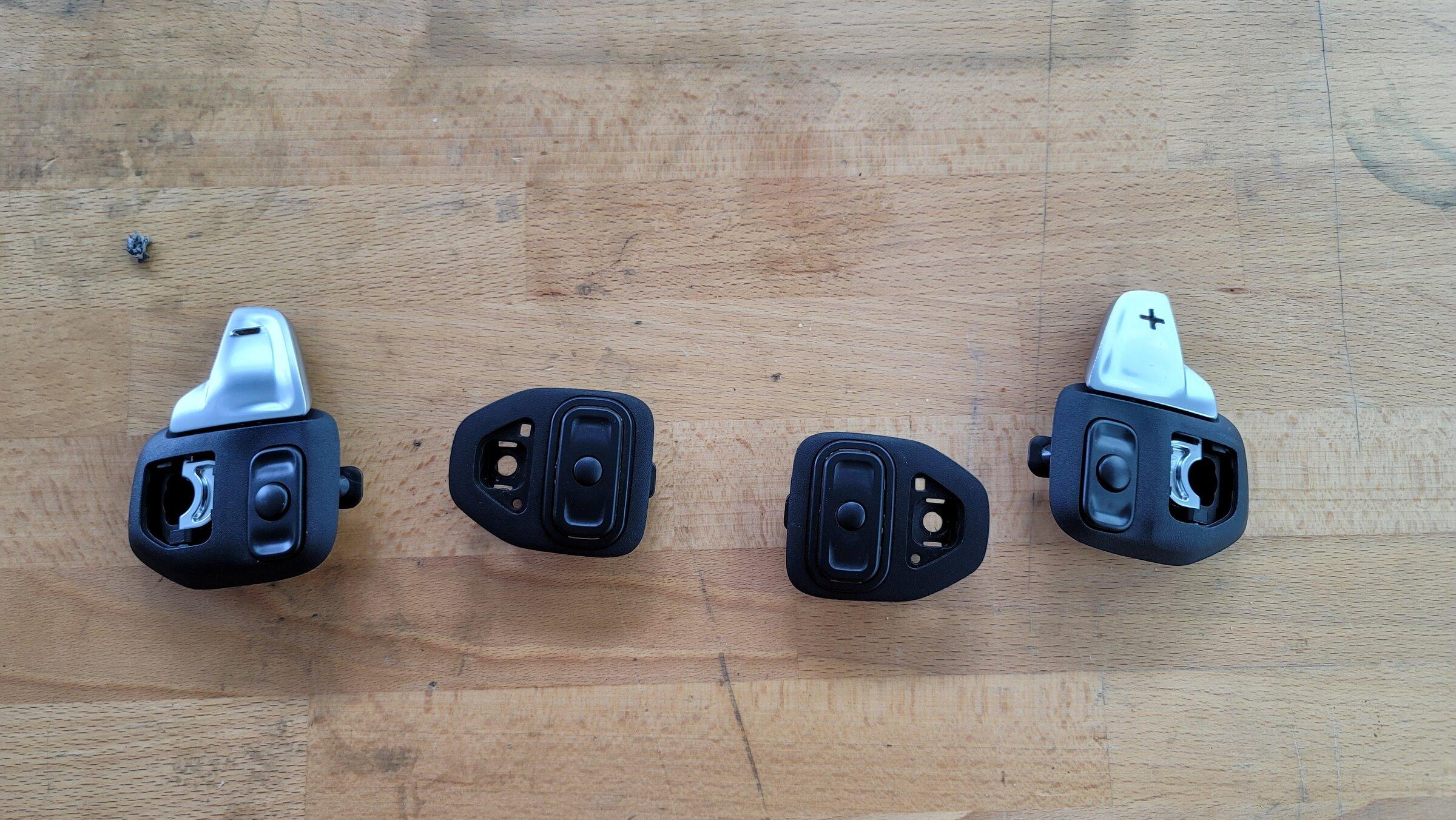

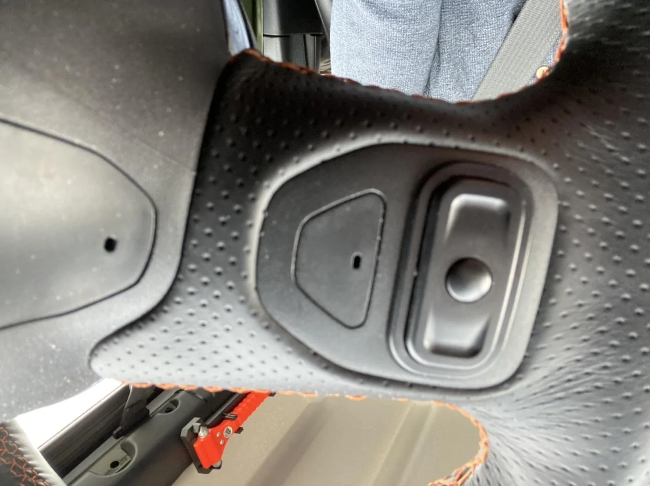

I have been contemplating retrofitting the Mojave steering wheel for a while since it is much thicker. Additionally, I have wanted paddle shifters since first purchasing the Jeep to augment the tuned shift points for towing or other purposes. The paddle shifters are more to fulfill a habit than a necessity.
I was intrigued by the 392 wheel and shifters so I took the plunge. The paddle shifters should arrive next week but I have installed the steering wheel and new wiring harness. The clockspring connector had all of the necessary pins, so I hope the adaptation will be as simple as coding the option at this point.
The new steering wheel is awesome! The increased thickness is a major improvement. The button pockets on the rear of the steering wheel are shaped slightly differently than my factory wheel. I assume this is because the switch housing is larger. I will confirm this once the shifters arrive, if this is the case the non-392 wheel will not accept the paddle shifters. Other than the different switch pockets, I observed no other compatibility issues.
I have photos to help share the differences, I always feel like I should have taken more.
The part numbers I used are:
Paddle Shifters: I don't know if these are all I need yet, the parts diagrams are difficult to interpret.
68487852AAPaddle Down Switch Right
68487853AAPaddle Down Switch Left
Steering Wheel: 7FD41TX7AA
Steering Wheel Wiring: 68531086AA

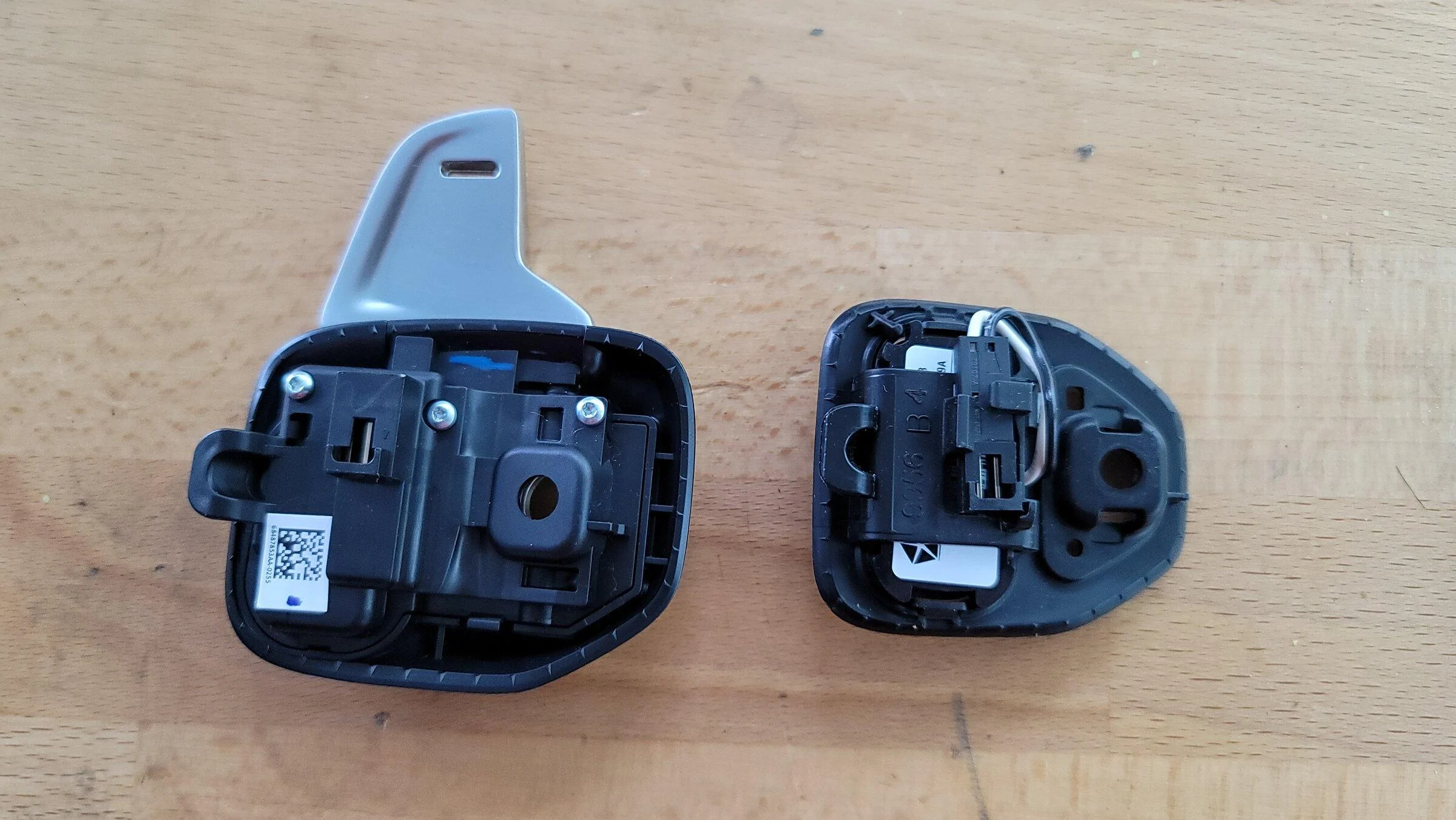

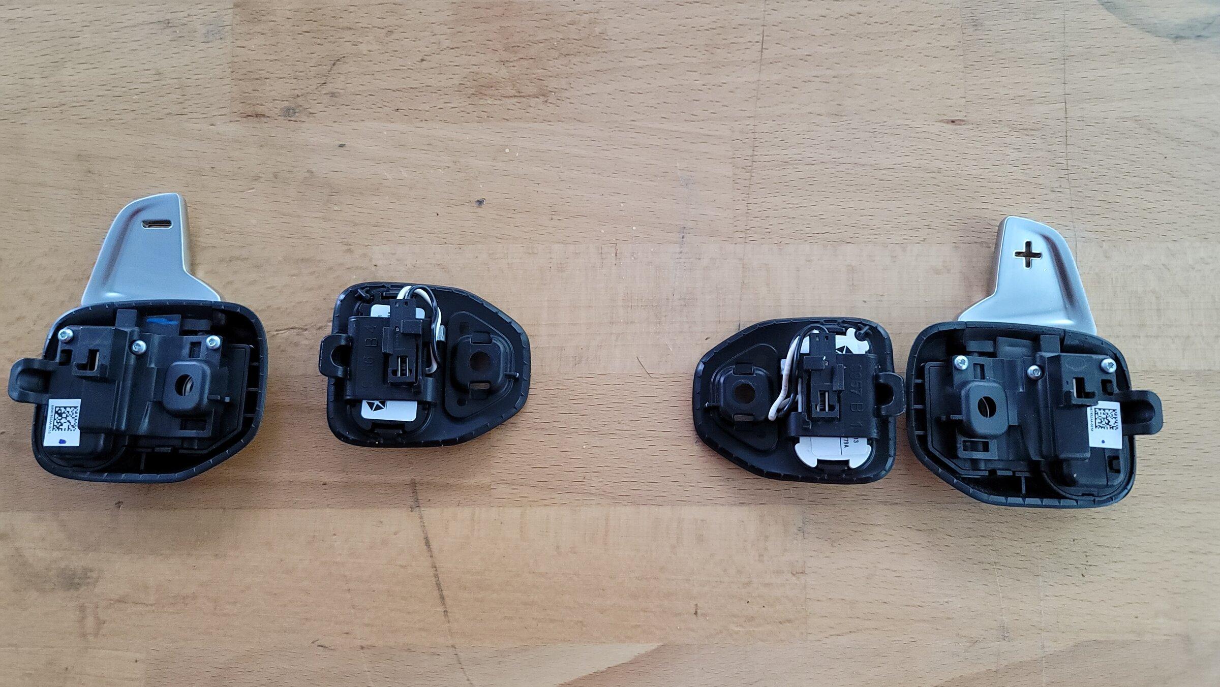

Quick update. Paddles are installed, the switch housing is larger than just the standard radio button housing but with an exact knife and patience, I think you could trim the dense foam to make the housing fit in a stock wheel.
Paddles don't work simply by plugging them in. I will dig into the alfaOBD settings this evening and report back soon with photos.

I love paddle shifters! It's done.
I set the options with alfaobd and the paddle shifters work as intended. This was the first time I used alfaobd so it took a little time to get accustomed, especially with my short patience.
Activating the paddle shifter option made the shifters functional either in manual mode or regular drive mode.
While in alfaobd I made a few other changes and will report back with cleaned up instructions. I also have a few small covers to add to the parts list.
The paddle shifter assembly is larger than the standard radio switch assembly but the paddle shifters could possibly fit in a standard steering wheel with a sharp knife and steady hand.
Now I want the trans shifts more snappy and responsive... hint... hint... to a certain special someone. ;)
