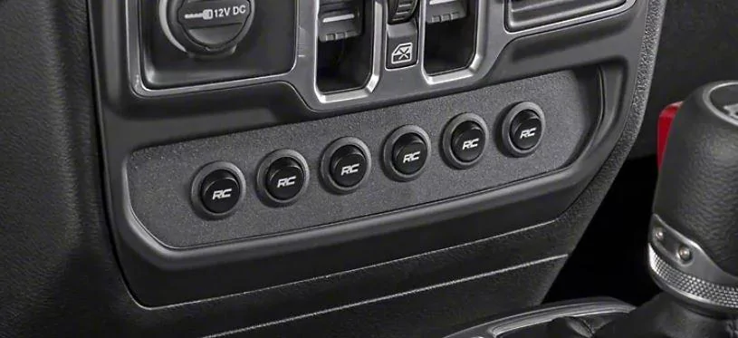

I know of no better place to ask for assistance on this. I have a 2020 gladiator overland edition, and like everyone else here, am always investigating how to better utilize the space around my dashboard. I have a micro GMRS radio (MXT115) that I think would be small enough to fit inside the lower dash panel. However, I cannot find anything remotely close to what I need to mount it there. I have no intentions of cutting up my existing lower dash panel tray. I believe I could use a blank lower dash panel and cut out what I need. I have not been able to find this anywhere. I'm sure a 3D printed version would be perfect. I have included a picture of a replacement switch panel made for this exact location. I need exactly what is in the picture, but with no switches or anything cut into it so I can custom cut it myself. Any thoughts on this?

Why would you need to print that? Go get a blank piece of black ABS and trim it. You could even do a blank piece of aluminum for strength and paint it.

The panel in question mounts a specific way to the back side of the lower dash section. I'd like to use the same mount pattern
Why not email them and see if they will just send you the same panel but pull it from the line before the holes are drilled?
I bet if you hit up someone like Motobilt they would do it too, and create a new product from it, a billet blank. You may even get a free prototype.

This is probably exactly what you are looking for https://www.etsy.com/ca/listing/1047830622/compatible-with-jeep-jl?click_key=e481a80af13a5350f2400ffa9e79ce0e234716b7:1047830622&click_sum=2cc8c6d3&ref=shop_home_active_6&crt=1
It can be configured blank (no buttons). I bought his left panel (I have the AUX switches) and mounted my trailer brake controller there. Here's what that looks like
That is EXACTLY what I was looking for. Thank you for sharing this information.
I ordered mine with 4 switches centered to have space left and right. Same vendor. Will be installing the same Redarc TBC. I wasn't sure if there was enough space behind the cubby area to install the TBC but your picture answered my question. Thanks.
