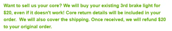

There is a new option since many of these posts were made: https://seequenced.com/products/2020-jeep-gladiator
They also will buy your failed light back, they use the housing to make their product. Even thought I bought an OE replacement, I still sold them my broken light when I found it kicking around my shop.

Great idea! How much did they give you?
$20 bucks. It is a cool light but pricey at $210 for a refurbished one and $275 for a new one.

$25 is what they promised, the package is still on the way to them. Not bad for something I was going to throw out.
Great! That'll knock the replacement net cost to about $50.
Thanks again for sharing this!
