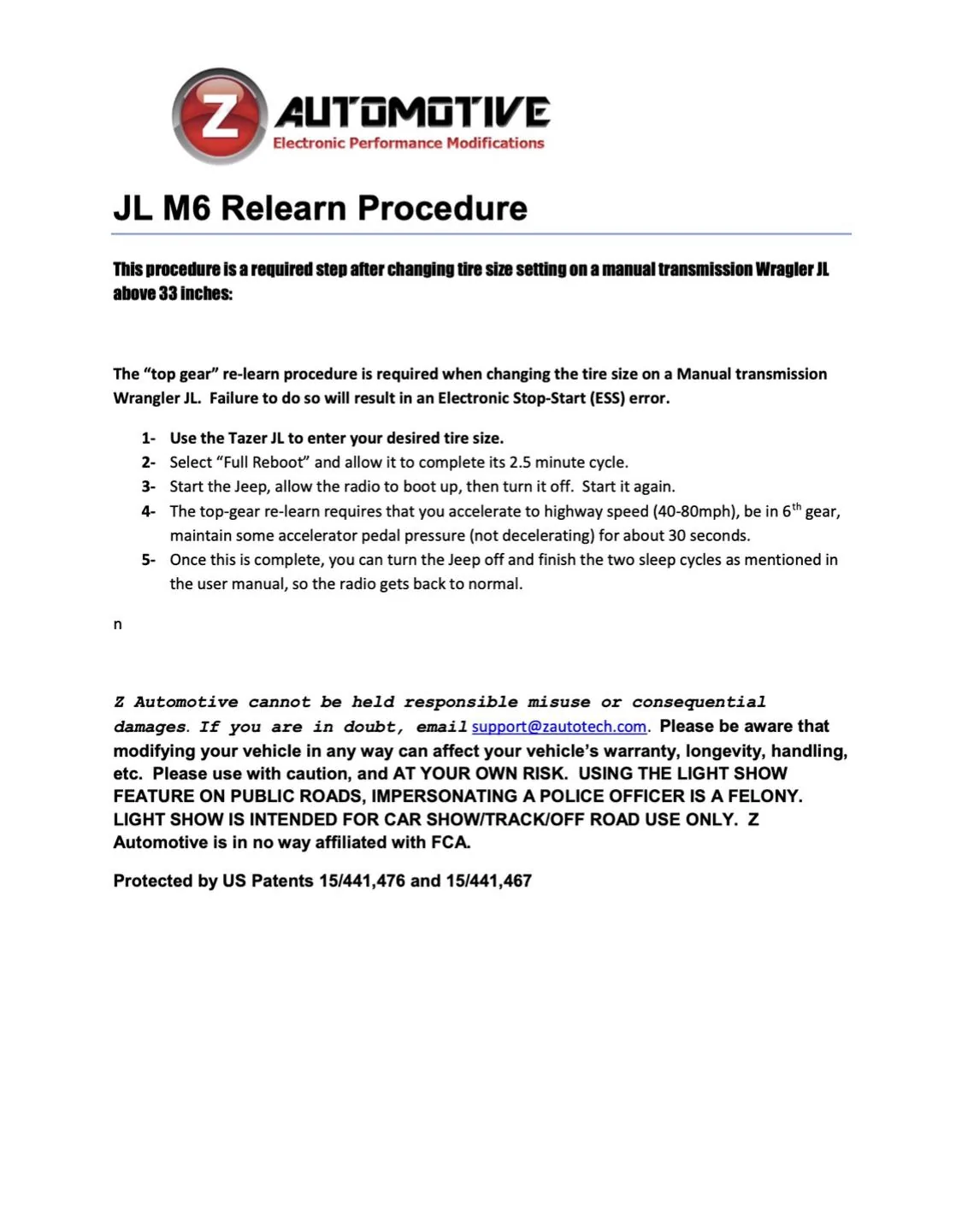

Lastly, my Captain America dash light is coming on and saying the start/stop system needs service, even though i changed the tazer setting to 4.88's when i left the shop. Comes on after each start and get to about 40 km/h. Will have to dig into this, surely it's a simple fix. I have it disabled in the tazer settings so unsure whats up.
I changed my tires and height with a programming tool. Next day the same light came on. Dealer flashed it and It fixed. Im sure I did it correctly with Jscan but oh well. Fixed now.

I did the Tazer 6th gear relearn procedure to adjust for 37s and no issues.
