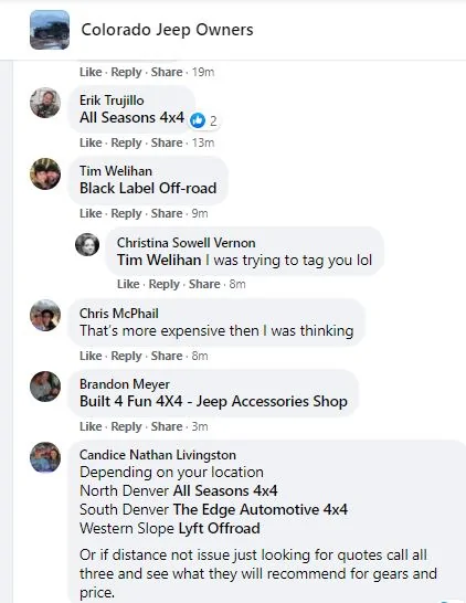

There's a great thread on the FB group = Colorado Jeep Owners. I attached a screen shot below of a lot of recommended shops.
FWIW, I called Tanner 4x4 and CO Axle and Gear... both quoted me ~$2700 out the door for parts/master install kit/labor/tax/warranty. (I believe they were using G2 and Dana gears). I was told by many members on the Colorado Jeep Owners page that was too expensive. That being said, I never called the recommended shops in the screen shot to find out pricing. Edge Automotive 4x4 came up a bunch in that FB thread though and I wanted to call them.
