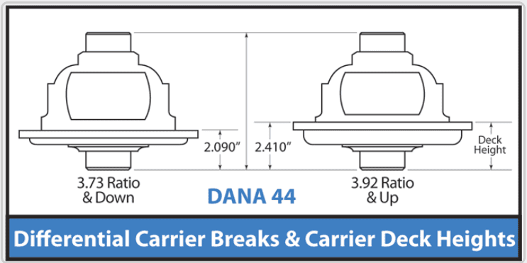

4.10's and manual mode on the trans is definitely the best solution there. Letting it hunt just means it needs to be forced to remain in the lower gear. That'll be easier on the trans and the engine.
True but the charts I find show that the stock Overland axle carriers won't take 4.10s, - which makes sense based on other differentials I've rebuilt. The pinion is larger, the ring gear thinner and the carrier won't work with the fact that the pinion is larger - the carrier ring gear mounting area has to be moved over to accommodate the larger pinion.
I'll have to see if I can find those charts again..........
Here's one example - shows I'm stuck with the 3.73.
I can't afford over 2 grand to swap carriers, too......
