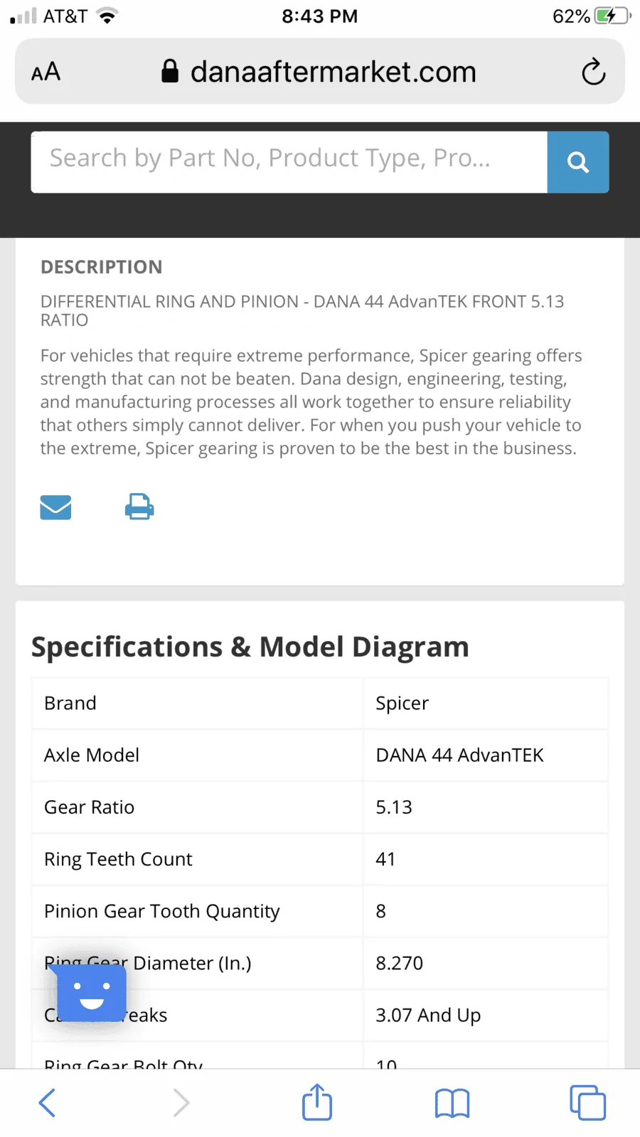

Dana spicer web site says carrier is good from 3.07 on up

Hey i have the Overland and regular tow package 373 gears âš™ had my gears changed to 5.13 HD Dana spicer did not change my carrier or my factory LS . $1650 out the door . This Dana Adventek 44 is a very heavy duty axle M210 front M220 rear.
So you are saying that these JT axles are not the 44s shown in the chart I found and posted where they said the 3.73 was it? That's the other 44 before the JT? Different axles?

Maybe so where did you get that chart from ? These axles are not even close to JK axles the closes axle To it is used in the rear of the titan & it has different features

Yeah that is just the older generation Dana 44 it never mentioned AdvenTEK 44. So yes i didn’t have to replace my carrier
Well that clears that up then. Thanks.
