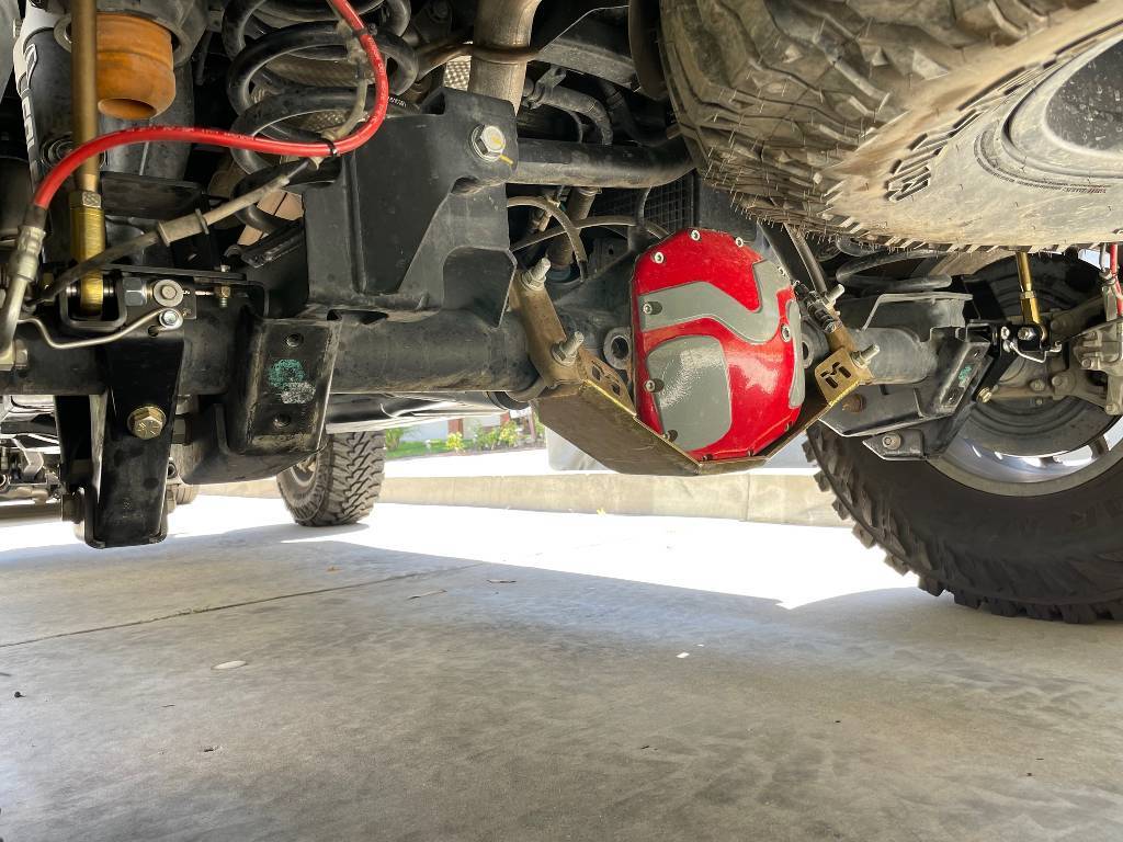

On my stick shift JTR, I have about 35K miles on my Dana Spicer 5:13s with 37's. I live in a hotter climate in the So Cal mountains. I have taken trips to the Rubicon trail (8 hours), Sedona (11 hours) and Big Bear (3 hours). I run the recommended for towing Mopar synthetic gear oil 75w140 in both diffs. with no additive. I have changed it 2 or 3 times. I run metalcloak Nodular Iron diff covers and I fill the diffs with the Jeep Gladiator recommended amount. I have had zero issues, no noise, no whining, no leaks.
This is good to hear. We used to live just outside Death Valley- Ridgecrest so I hear you/understand with the heat. You changing every 15k? or 10k? What speeds are you usually running on the highway for your trips?
Thanks for all of your notes, its appreciated. (Y)
I have not noticed any problem with heat. I had Rebel off-road install the Dana Spicer 5:13 gears at around 20K miles. Rebel off-road told me to use 140w oil. I changed the both diff oil, 500 miles later with Mopar synthetic 75w140. At 27K miles, I changed just the rear diff with Mopar synthetic 75w140. At 44K miles, I changed both diffs with 75w140. I am at roughly 54K miles now. I drive city and fwy, always going as fast as I can without getting a ticket. So, 73- 75 mph normally; 80-83 mph when there is no traffic. I basically drive the same speed that I did with the 4:10 gears. I have not changed my driving habits. I get the best mileage at 65 mph. I followed a friends motorhome back from Sedona, and I got an incredible 20 mpg -- calculated by hand with google miles and gallons filled at the pump. It was mostly all flat run. Normally, with all the hills around me and the aerodynamics with the speed I drive, I get about 15-16 mpg. With my 37 inch tires, the 5:13s helped my gas mileage more than hurting it. I have never towed with my stick shift JTR.
