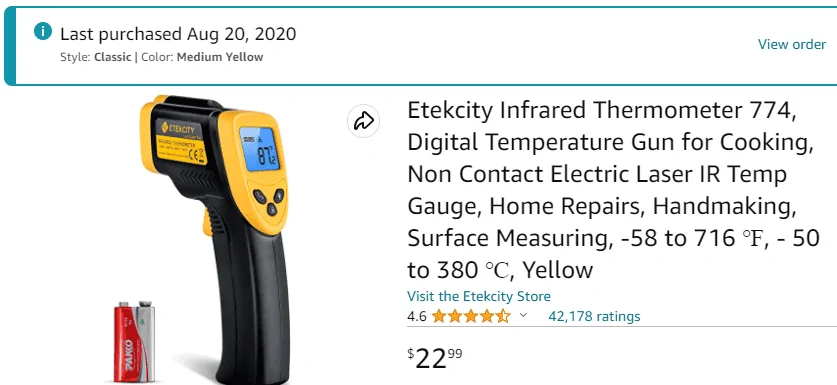

When I arrived at work this morning after a 50 mile trip at 70-75 mph, I crawled under the truck and laid hands on my diff. I began praying and..........lol, just kidding. Seriously though, it was, my best guess about 130 degrees. I could easily touch and leave my hands in contact with the diff. This to me doesn't seem like excessive heat but I'm not sure what a differential normally runs. I would definitely think the oil would be rated for much higher Temps though. I will probably plan to change the oil every 15000 miles although I think that's more than it needs. I'll lean towards the side of caution though.
This is a fun tool to have.
https://www.amazon.com/gp/product/B00837ZGRY/ref=ppx_yo_dt_b_search_asin_title?ie=UTF8&psc=1
Jeep Gladiator 5.13 Gears, My Thoughts and Real Numbers Temp gun
