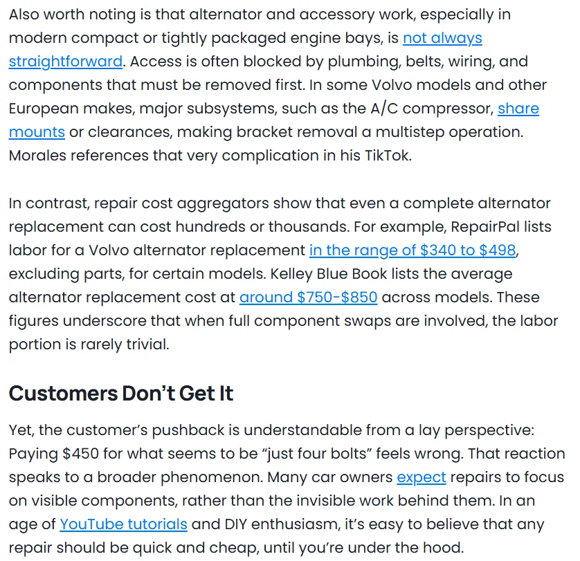

It's a new reality. This link really hits it quite well. While there are shops that will exaggerate costs, others are telling it like it is - gone are the days that "it only takes 4 bolts" to do something that was simple 40 years ago.
This is one of the best reads I've seen in a while, and really shows that social media is part of the problem "everyone is a mechanic"
https://www.motor1.com/news/774264/volvo-alternator-bracket-replacement-cost/
