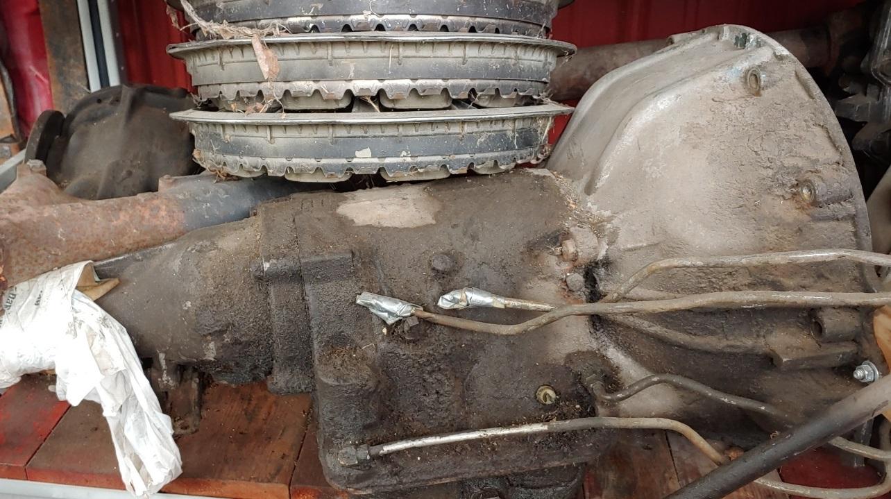

Hardly. There would be no seal at the back like that. They used a 2 half seal in the main like anything else. That's no gen II AMC for sure, I'd say not even a gen I because that also used seals in the main - rope seals.
No AMC used a seal at the rear like that, and that's not a bell housing for AMC. I have some of those.
It's bass-ackwards for any transmission setup. Bell housings on AMC bell or open up FORWARD, toward the engine just like Ford, Chevy or Chrysler.

Here is an early style AMC bell housing on an early AMC automatic (made by Borg Warner)

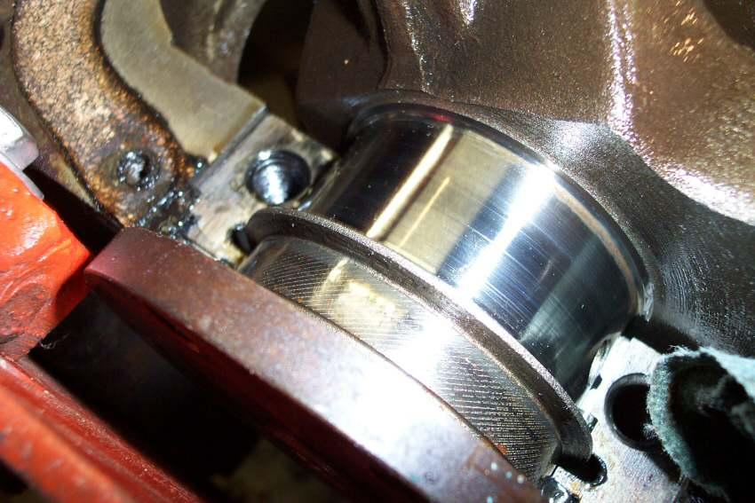

Here's the seal area of any AMC engine, rear main cap is off, the seal rides on the area where you see "knurlin
Jeep Gladiator Blown engine under 12K miles engine-080
g".
