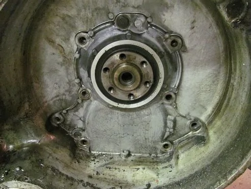

@RedTRex Looks like a cam plug, rear. Not sure on much more than that. Keep the mysteries coming, but maybe another thread for it.

Correct- Small Block Chevy bell housing end. That pic was only up for like a day, good memory Mike....
That was easy for everyone - try some other area of the block, heads or transmission.........
