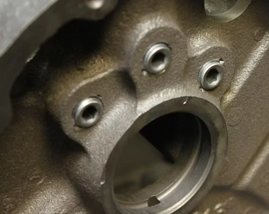

Query - why is everyone so concerned about a machined hole that they obviously saw a reason for in the design, but no one can figure it out?
I know now I need to go out to my shop, uncover a bunch of engines, blocks and heads I have out there and get some photos and post and see if the members can figure out some of those areas.
This hole shown is obviously not hurting any engines, so why such a mystery?
IS there oil leaking out of that hole?
Is there wear or marking as if something was bolted there but is now missing?
Is there coolant seeping out?
Did the block crack there?

Could be for a fixture while performing some process, lifting, manipulating engine or block at some point in manufacture or installation.
Since these engines are also used in Dodge cars and other Jeep products, it could be for some other accessory or some item associated with those other FCA products. Don't they use these in the small Ram trucks? These are not Gladiator-only engines, so it's pretty wide open.
I guess i'd not sweat it since it appears nothing has been bolted in place, there's no mark as if anything is missing or leaking. It's amazing even on blocks from the 60s and 70s you see similar machined holes - used in the production of the engine to align, or machine or assemble at some point.
If it wasn't late I'd go get some shots of the engines and blocks I have in my shop with obviously machined holes in them - but no reason for it as far as the owner is concerned.
So I use to help hold or secure the engine while working on it, or hold a block while boring it. Makes good clamping spots.
More than likely, that's the hole for the block heater.
https://www.justforjeeps.com/engine-block-heater-kit-jl-wrangler-jt-gladiator-.html
