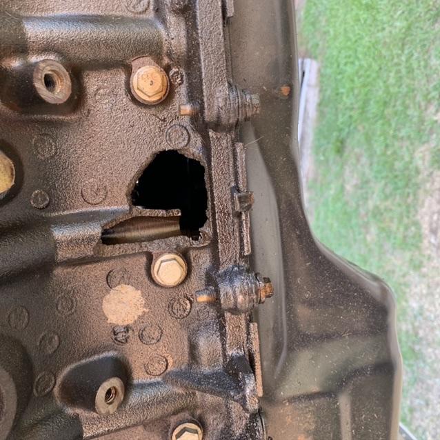

It is entirely possible to put a piston through the block of any gas engine built. It only requires the correct conditions to exist - like flooding a cylinder with coolant which cause a hydraulic lock, a bent/broken con rod and voila!
180
29,422
34,996
It would have to go near-sideways........... you are saying an aluminum piston will go through the side of a block that's several times more thick.
Plus you are talking about shoving aluminum through cast iron in engines built even a decade ago.
Not only that, the strokes on these is short meaning there's very little cylinder wall exposed at any given time.
Show me........... 45 years of experience with racing engines (talk about ABUSE and extreme conditions) and almost every other gas engine.
180
29,422
34,996

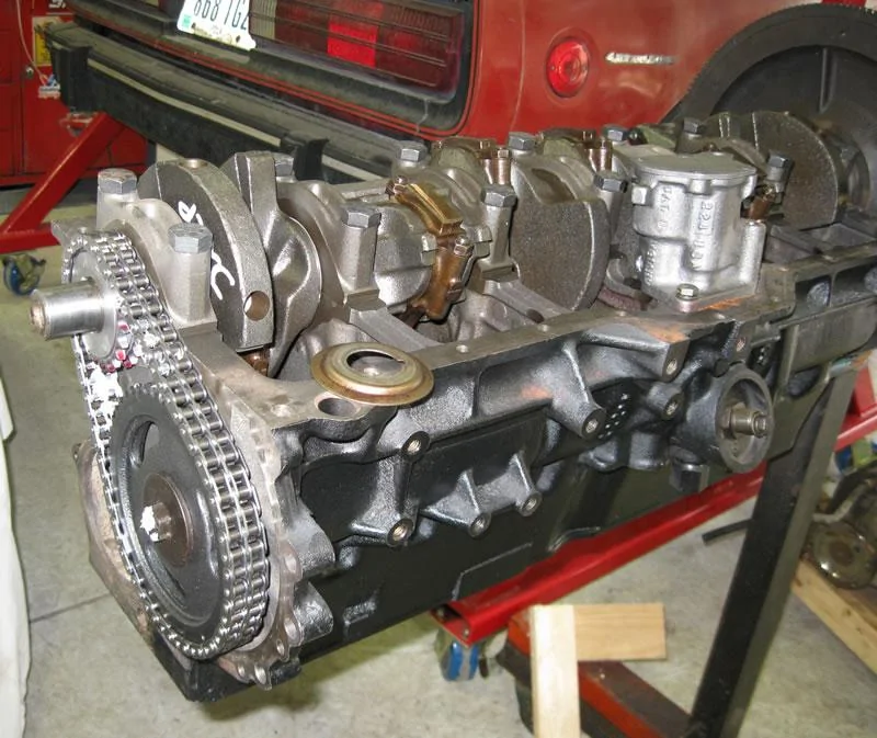

I’ll just put this out there........4.6 Ford............
Rod. That's right in line with the crankshaft.
That hole is a classic rod through block hole - I have seen that more than once.

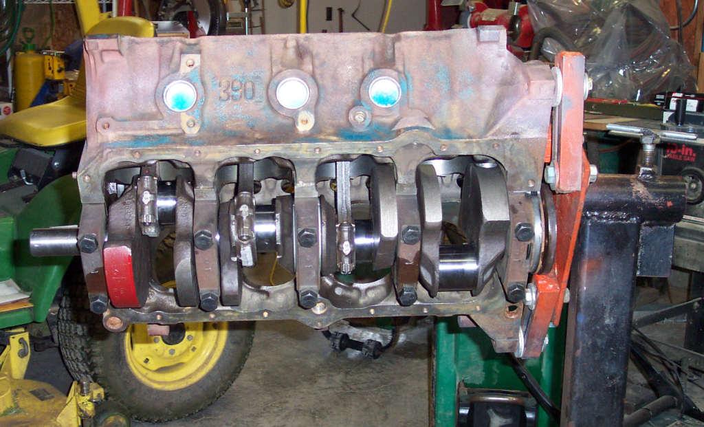

The crank is in the way for the piston to get down that far in a V8, and frankly, if looking at the 4.0 engine I'm building below, you can see how it's a rod flung over and out making a hole about that size.
The piston doesn't even get near that area, it can't possibly (and it's aluminum and soft)
What breaks in hydro-lock - is the rod. You snap rods if you get water into the cylinder. I've seen that when people try to drive through water that's too deep - you take out rods, they bend, they break, and they run at angles and out the side they go.
The piston moves up and down, the rod if it breaks is actually going sideways 90%+ of the time and will go through the block as it's very solid and strong, like ramming a solid chunk of steel through that block.
Jeep Gladiator Blown engine under 12K miles eng-bottom-1
Look at the rod below, sort of a gold color. If that rod were to break, it's SWINGING left to right, not up and down, but swinging. The broken end either still on the crank, or being moved down by the piston, would go right through the block about where the Ford block in the prior post is busted out. That's absolutely rod damage.
The piston can't move down that far because the crank throws would shred it first.
In fact the pistons have notched out areas to clear the throws - and there's precious little space considering rod stretch and rod compression.
