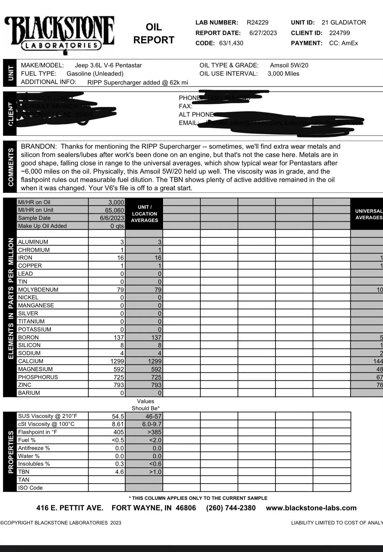

Here is the report in the 5w-20. I will update with the 5w-40 (w 1/2 quart of 5w-30) 5.5 quarts.
Jeep Gladiator 5W-40? IMG_7882
