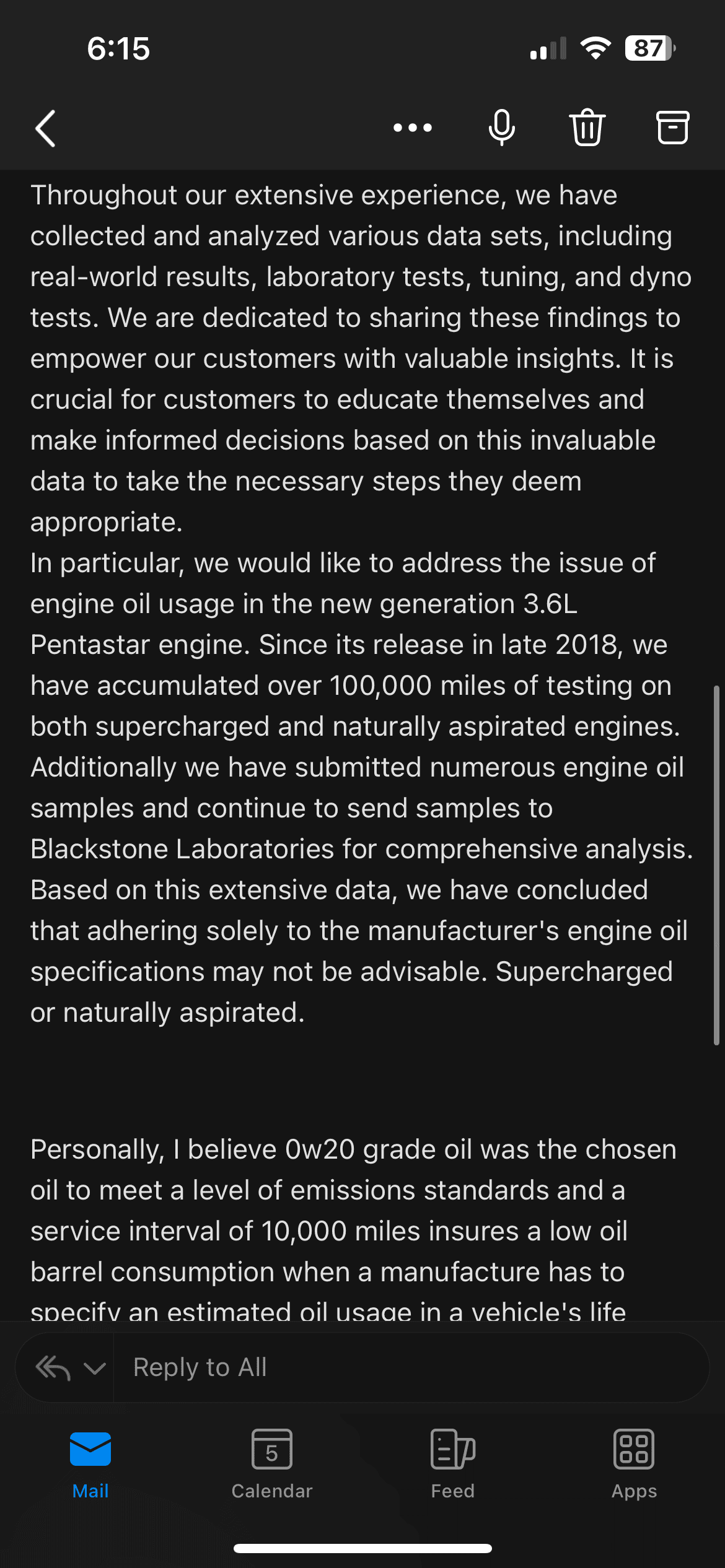

Fwiw here is the response received which seems to mirror the thoughts many have.
Jeep Gladiator 5W-40? IMG_6663

But yet they say you are still on your own if you do follow their recommendations and something goes sideways.
Like @Maximus Gladius mentioned, we would still like the data to draw our own conclusions other than their "Just Trust Us" statements.
Agreed. I would have appreciated it as well.
sharpsicle
Apr 29, 2021
2,772
6,272
Tampa, FL / Milwaukee, WI
"We are dedicated to sharing these findings..."
Great! Where are they?
"It is crucial...[to] make informed decisions based on this invaluable data."
Agreed. Where is the data?
Also, I was hoping to see more than just 100k of cumulative tests across two different configurations. That's equal to just one engine on normal daily usage. Not exactly 'extensive' in my opinion.
I had little to no expectations but I felt like an attempt to see if anything could be provided was worth asking.

OP, there are some that have started running 0/40 diesel/gas rated oil here. They’ve run the gauntlet here and have made it out the other side. We are waiting for their much desired journals and data. Hope that brings comfort that you are not alone.
