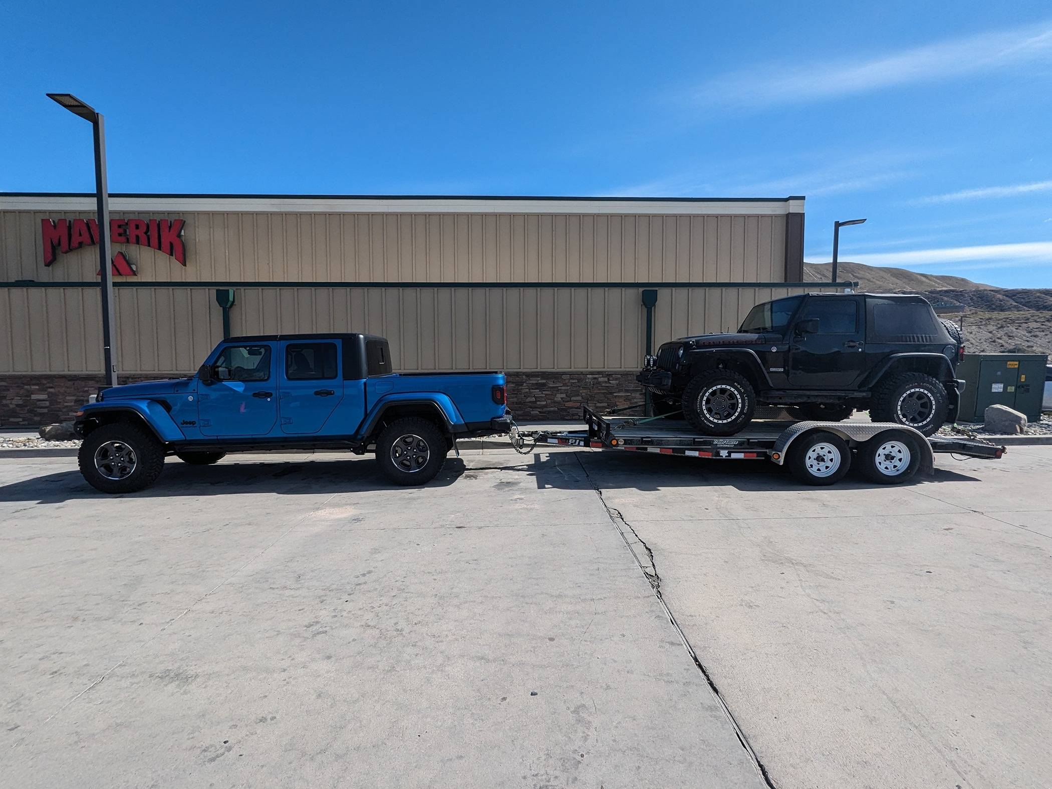

Okay, silly click bait thread title I know, but I figured this might be useful info for someone else. I loaded up my JK on my car hauler trailer and took it to the Cat Scales to do some testing.
Jeep Gladiator 7.5" = 240 lbs 366195-b827bf0fc381a3e0f80480ded052fa13

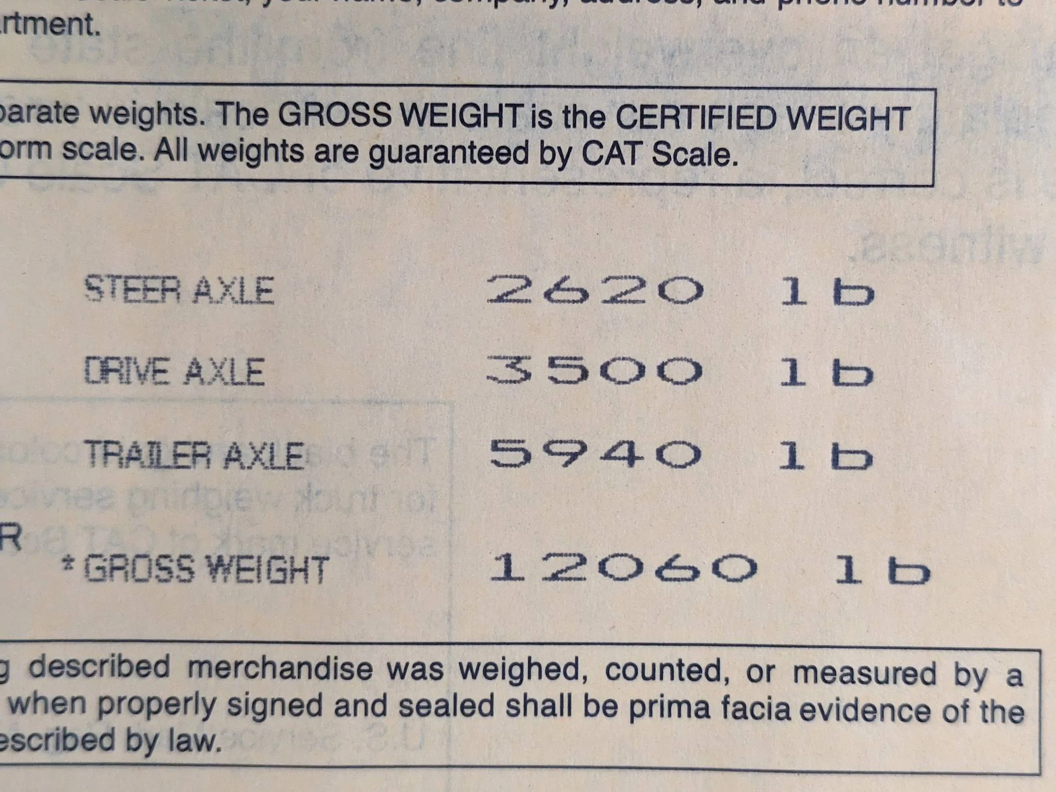

Here's the first weight.

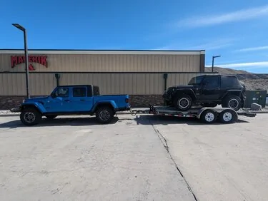

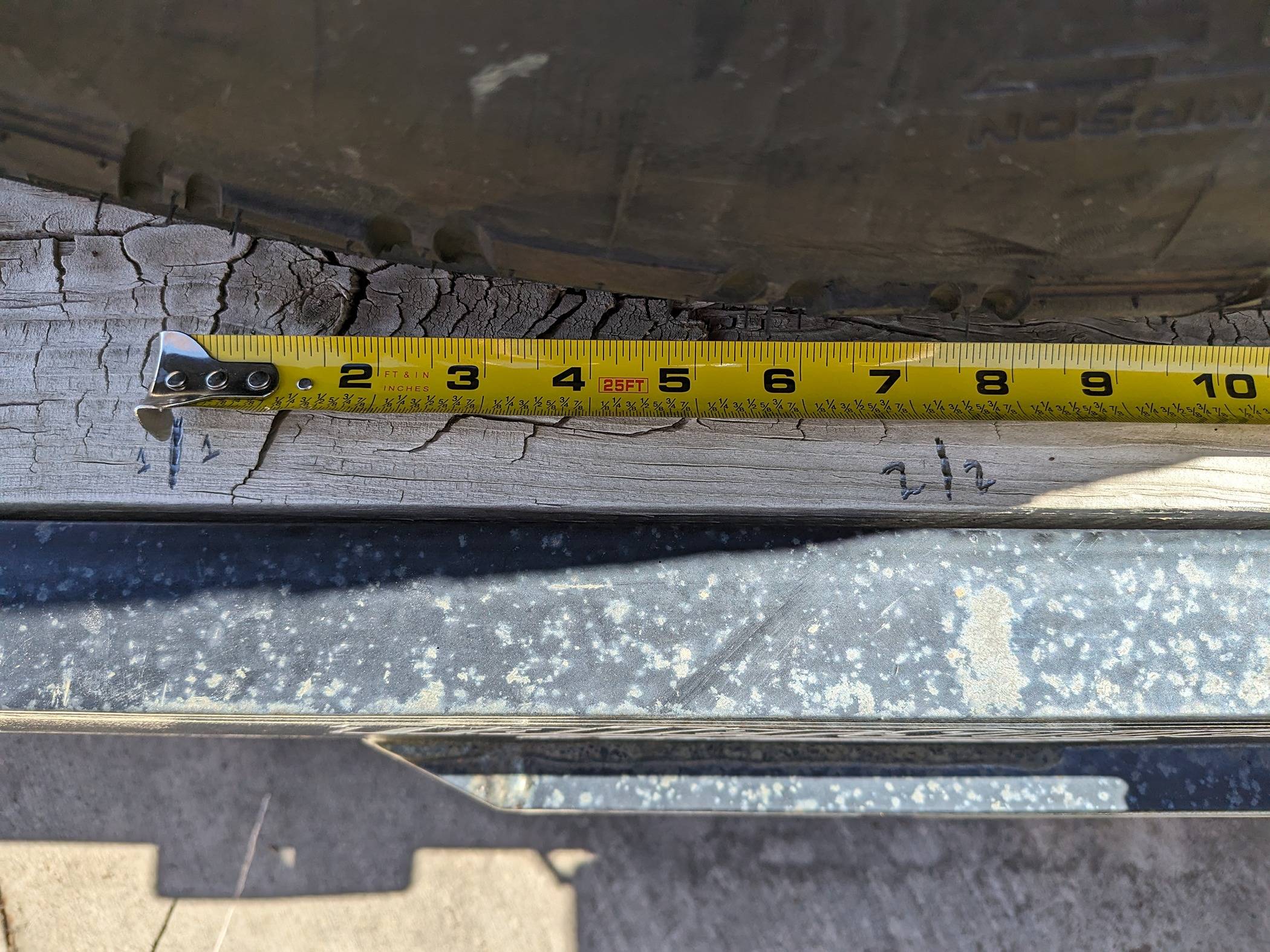

Then I moved it back this far.

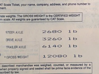

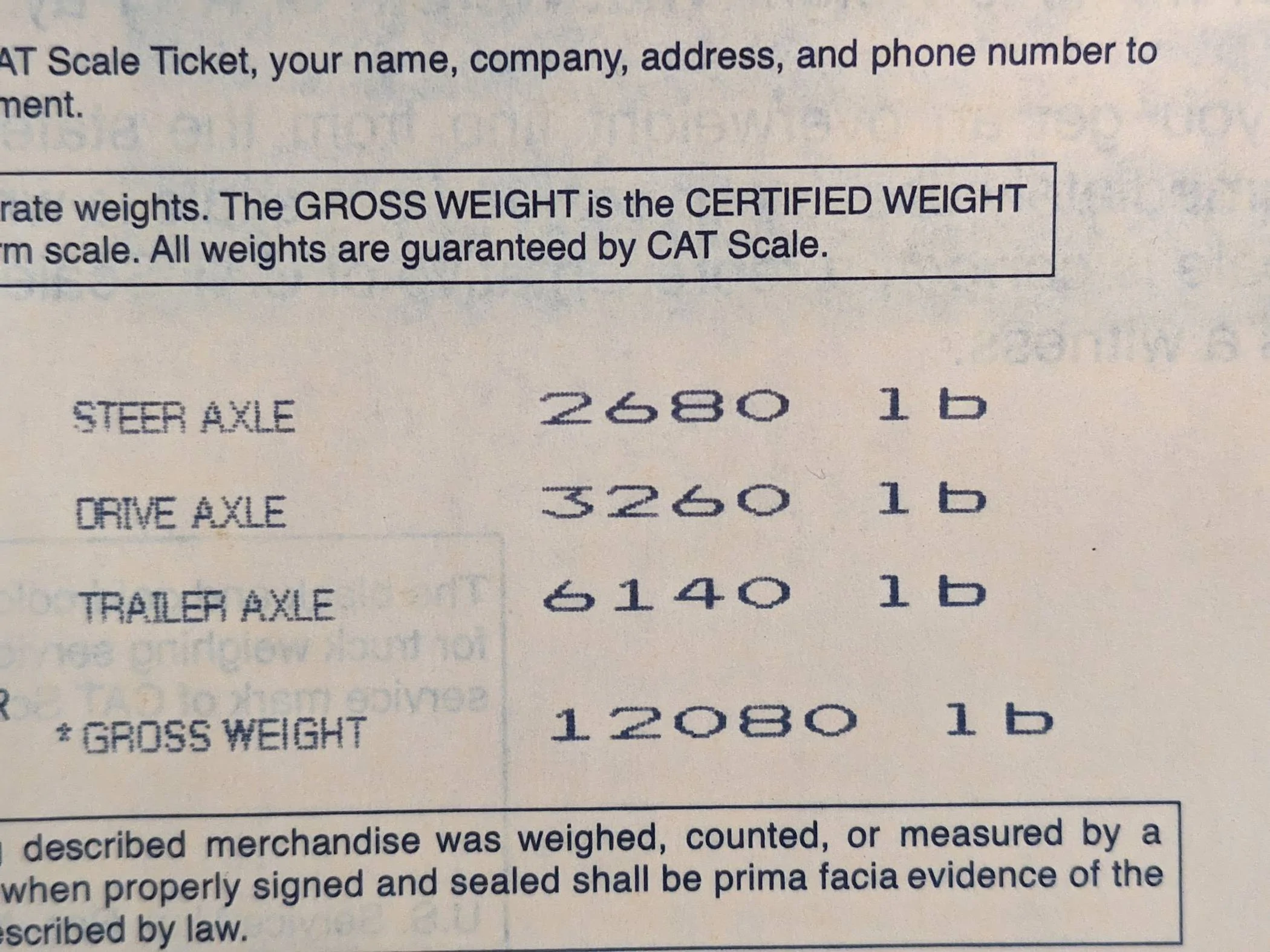

And the weights changed this much!
Jeep Gladiator 7.5" = 240 lbs 366196-44f9672a8352a264e33aa49c19063069
I expected it to change. That's why I was testing in the first place, but I didn't expect that much of a difference with such a small amount of positing difference. It felt a lot better coming home with the new placement as well. It wasn't porpoising at all on the way home, where it was a little on the drive to get weighed, so I suppose someone with more experience (looking at you ShadowsPapa) might have gleaned that from that information. I was also happy that the front axle weight actually went up on the second measurement.
