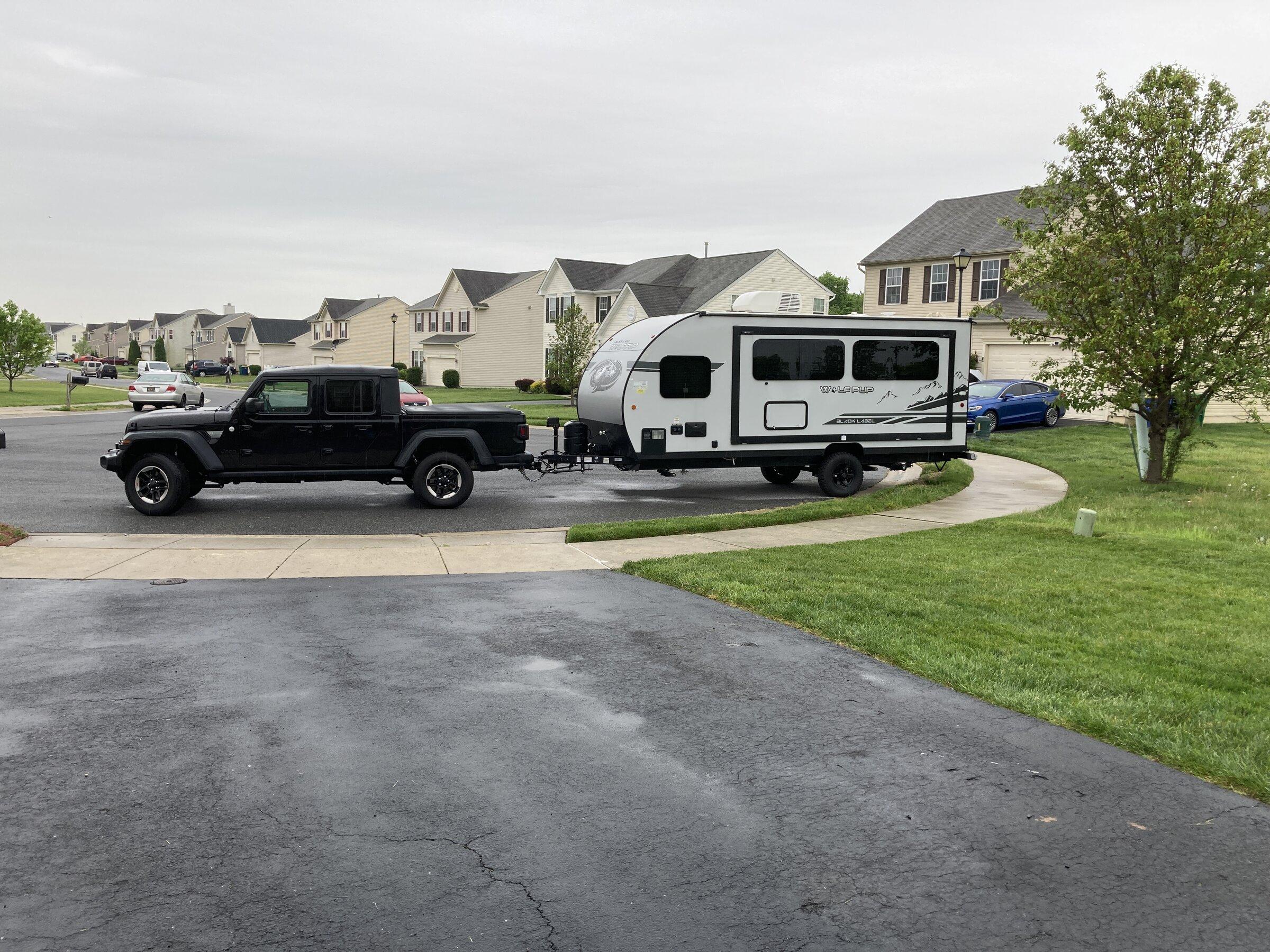

I have a stone stock Overland and tow a 27', 5,300 lb (loaded) trailer. No muss, no fuss. Manual shift the auto, keep RPMs 2,500 or less...around 2,000 RPMs in 7th at 65 mph...I get around 13 mpg with mine. Of course, this is east coast relatively flat towing, the occasional North Carolina. Will hit the Shenandoah Drive and Blue Ridge Parkway one of these years then we'll see what the fuel economy will be ;)
This is my rig...
Jeep Gladiator 2020 Rubicon auto... looking for a travel trailer, is 4,500ish lbs going to too much to reasoably tow or should I limit to a 3,500 lbs trailer? 24C80F8D-1847-454A-85F1-59E4A5B222C8
Can I ask what weight distribution hitch you're using?
I have the BlueOx system...both weight distribution and sway control in one unit. It was highly recommended to me by the place I bought my trailer from. Both the sales person I dealt with and most of the mechanics there who have trailers use it and are very satisfied with it's performance...as am I :)
Thanks, the dealer where we picked up our trailer stocks the camco recurve and that's what they installed, not too sure about it yet. I've been researching the Anderson manufacturing hitch. I really liked their aluminum 5th wheel hitch with our 5th wheel, easy to get in and out of the bed of the truck. Thanks
