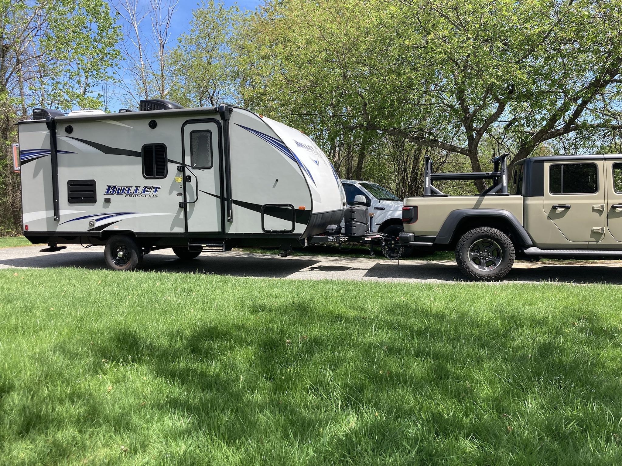

Yup
Jeep Gladiator 2020 Rubicon auto... looking for a travel trailer, is 4,500ish lbs going to too much to reasoably tow or should I limit to a 3,500 lbs trailer? kSOu45

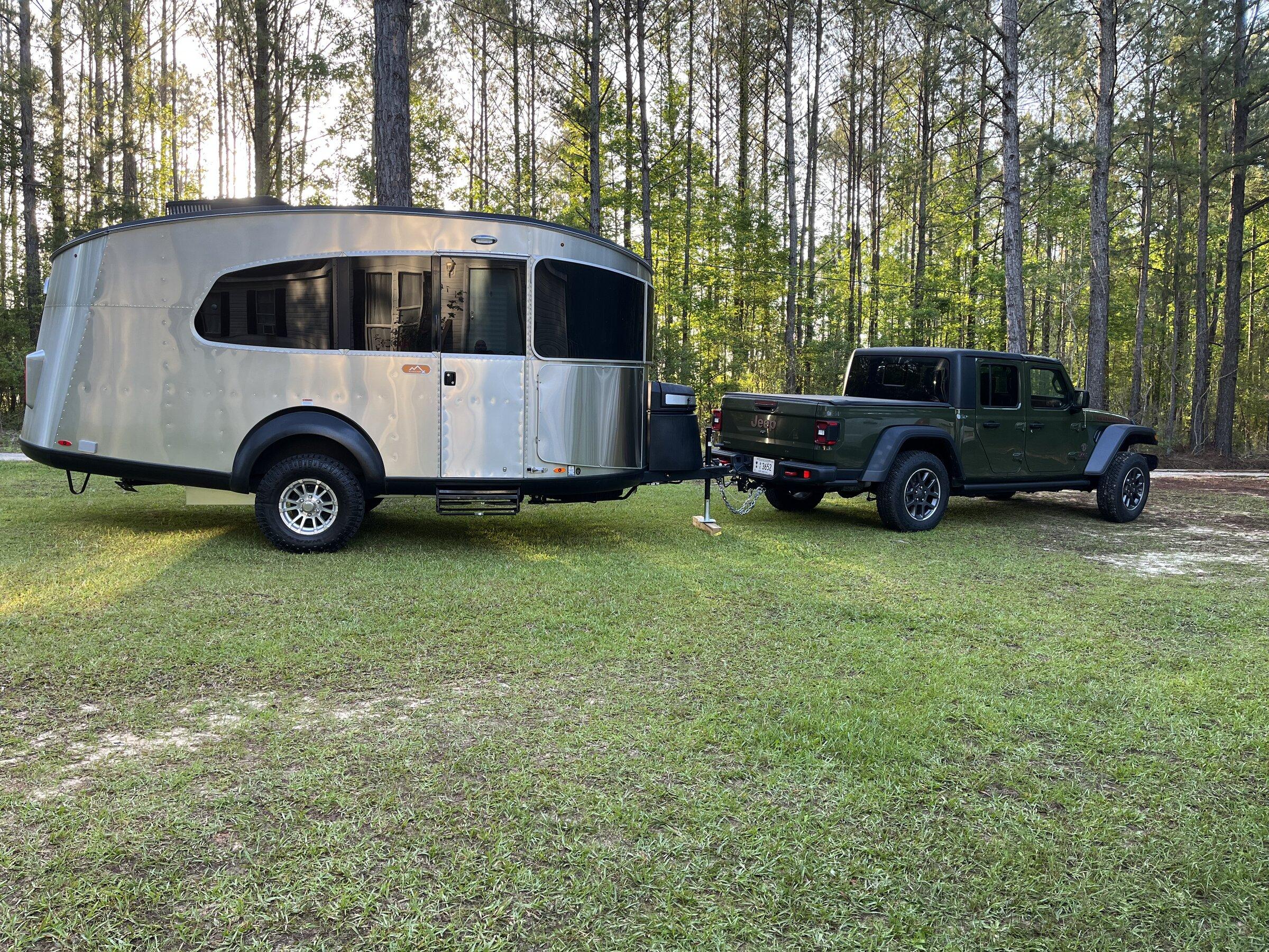

Our first trip is Memorial Day weekend!
The truck and trailer is completely empty, so I'm still not sure if I will need to lower the height of the hitch ball.
My recommendation is to get an adjustable like from B & M. Depending on truck load and trailer tongue weight, I may go up or down an inch. Itā€™s also helpful if you try to detach/attach when on uneven ground. I deploy the jockey wheel or pad jack, pull the adjustable hitch pins, and lower the coupler still on the ball to allow the trailer to be detached or attached. Then raise it on the ball until youā€™re where you want to be for towing.

Looks like cgm has a WDH hitch already, the one with the bars on top looks great.
I just took our camper out last weekend for our shakedown trip, went well. I set my Blue Ox hitch up with full fresh water tank in trailer and empty Jeep and trailer, everything level, when loaded up to go ,everything was still level just a little bit lower evenly.
We had a great timeā€¦.Jack

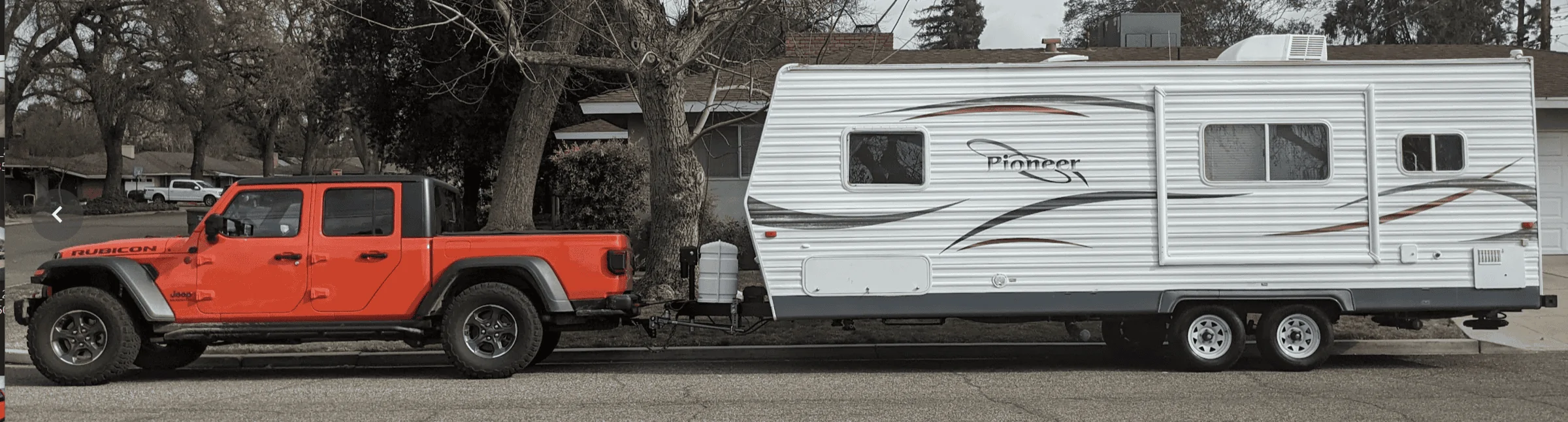

If you run the trailer weight up to 6,500, your hitch weight at 12% will be 780 lbs, which comes RIGHT out of payload. I would say no go, but that's your call.
We've a trailer with a 7,000 lb gross, but never go over 6,000 and actually when we go to Lassen we will take out some cargo (pellet smoker, etc) and re-weigh / re-balance. The 720 lb hitch weight tows fine, but is 20 lbs over the rating on the hitch (didn't know until last month). Our in-Jeep "cargo" is just the two of us, because the payload is 1283 lbs for our JTR and why push it?
Implied in the bunkhouse is four passengers, and that's a long trailer - ours is 24' in the shell but 27' overall. You're not going to make weight on combination like that.

That's a great weight but we looked long and hard for a double axle travel trailer. The additional stability is very welcome. Towing various cargo trailers, the difference was obvious and made it a must. I towed a little Jeep trailer for ages and never knew what a big deal it would be.
The inventories we've seen lately have been back to normal, there should be something out there in that weight range with two axles.
