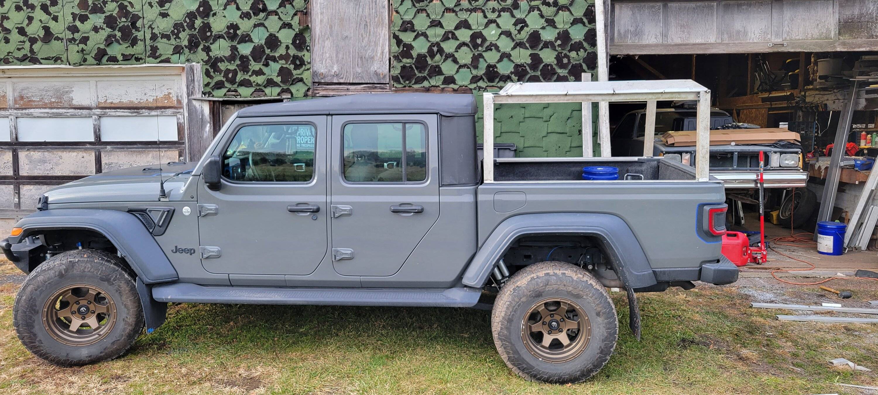

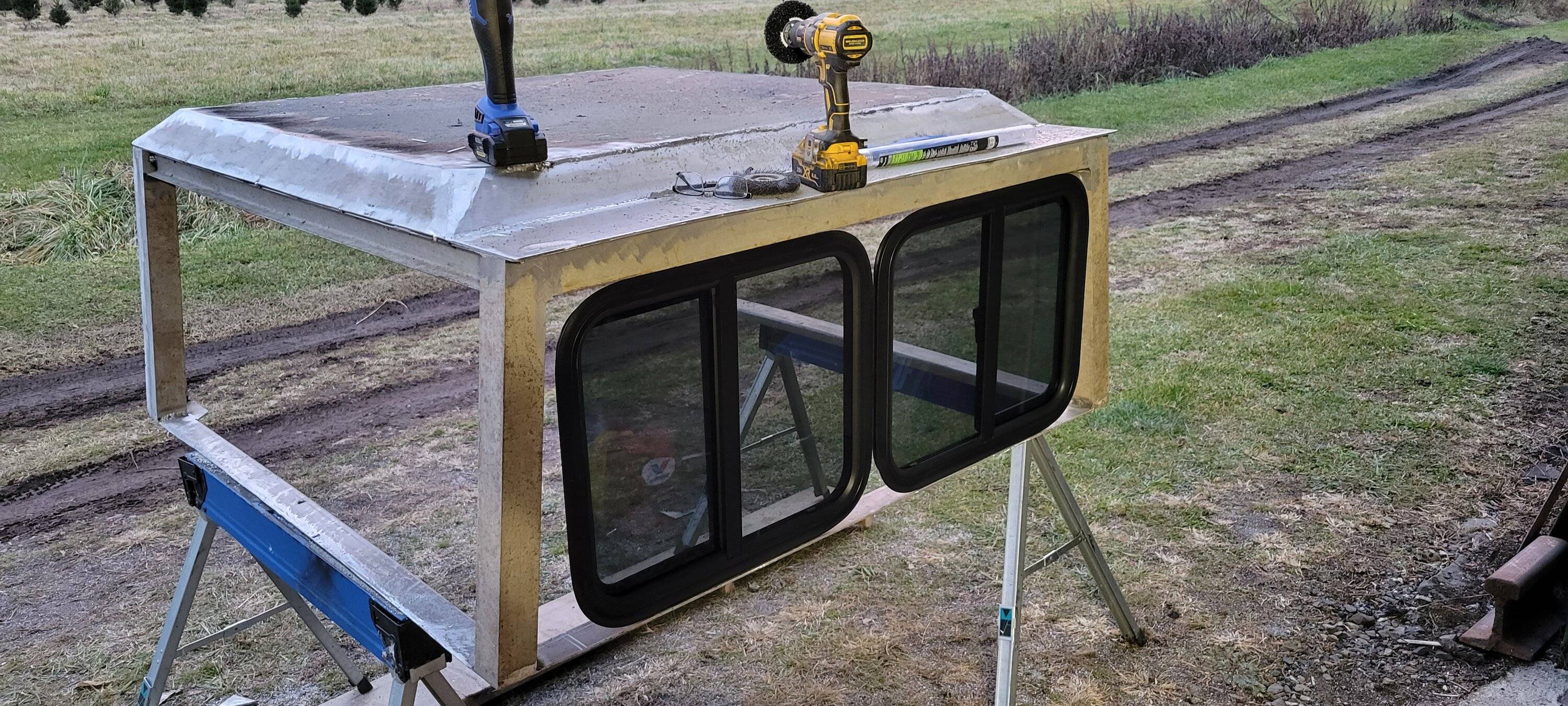

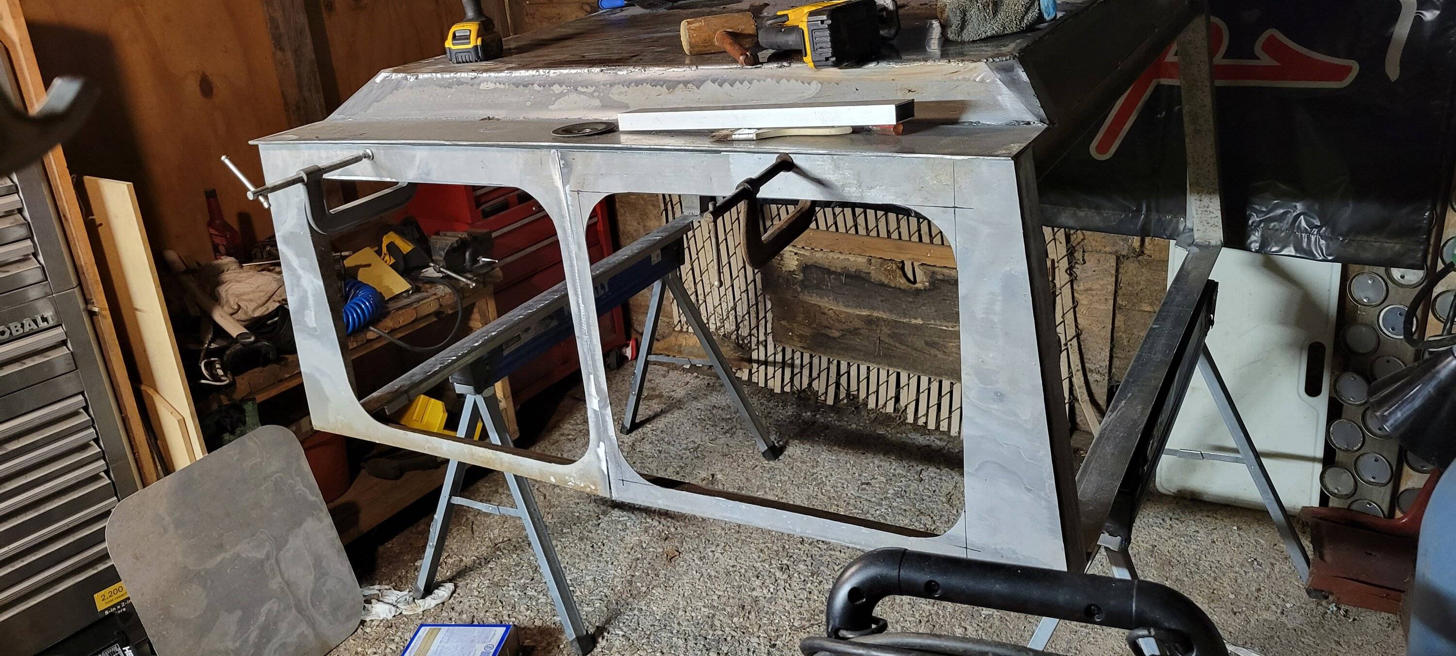

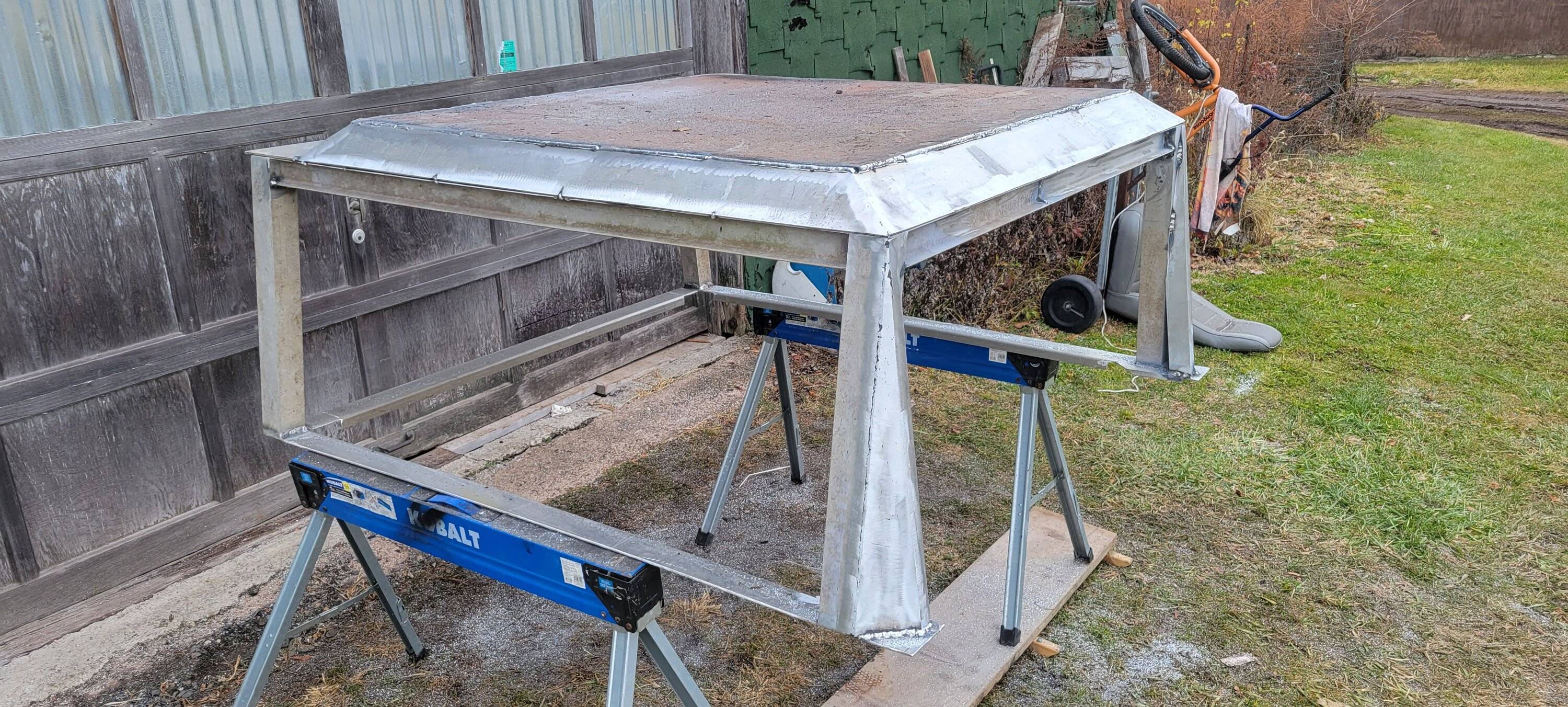

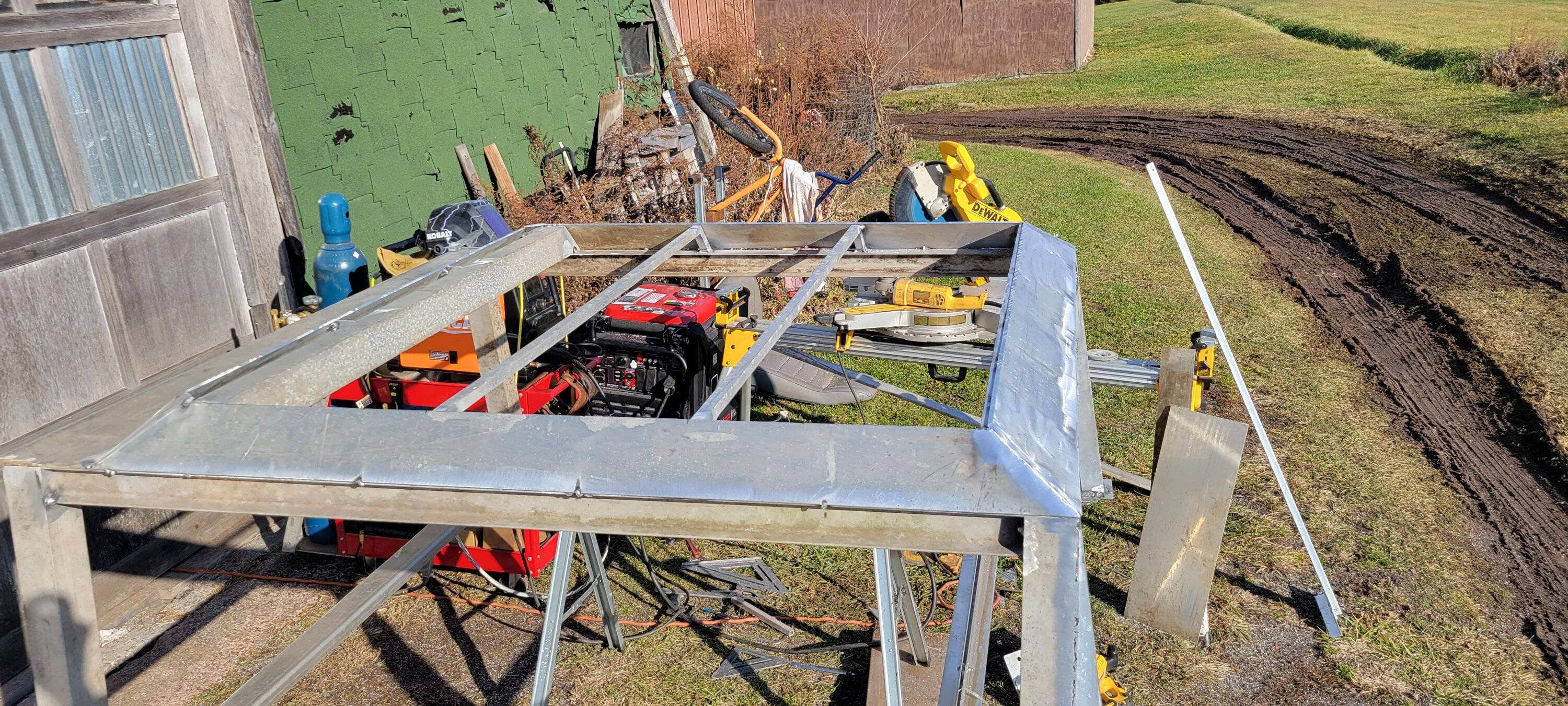

Hello,
As some of you may have seen, I like to build things, mainly focusing my work around Camping/Overlanding and traveling. I built an overlanding trailer last year and we have used the heck out of it since. Since we typically travel with our dogs, I had put a Softopper on the Jeep, and for as much as I love it, I wanted something a little more secure, ventilated, and usable. I decided to build a top for the Jeep myself, as I honestly couldn't see paying what some companies were/are charging for their tops, and honestly I wanted it to be a do-all type of accessory specifically built to my specs.
I am by no means a professional fabricator, so I am sure there could be better ways of building it, but feel free to ask any questions along the way. I'm about halfway done with it, and hope to have it finished (with the exception of the paint/bed liner on the outside) by the end of the year.
Jeep Gladiator My DIY bed cap 20231202_085433
Jeep Gladiator My DIY bed cap 20231202_152605
Jeep Gladiator My DIY bed cap 20231208_133905
Jeep Gladiator My DIY bed cap 20231209_103842
Jeep Gladiator My DIY bed cap 20231209_163632
Jeep Gladiator My DIY bed cap 20231212_171821

It looks like aluminum, what are you using for a welding setup? That’s a lot of real estate to TIG.

It is 100% aluminum so far, and I am using a Harbor Freight OmniPro 220 with a spool gun.

So the HF welder outputs AC? I assume you‘re using Argon. i have seen wire guns used before, but they‘ve always been in either an industrial, or ship yard, setting with multiple guns set to a master machine. Basically. a movable welding stand with the gun, wire feeder & spool and a tank. These are then wired into a bank of controls; way beyond what could be done in a DIY setup. The individual work stations look like the little 220 MIG setup I have in the garage for body work.

The little multiprocess welders pretty much do it all these days. I picked up the Yeswelder 250 on Amazon for $300 and it does steel, stainless, and aluminum MIG, as well as stick, and you can plug a TIG torch into it and do lift TIG. I've been super impressed with it's performance.

I almost pulled the trigger on a YesWelder before I got my HF unit. I chose the HF because I can exchange it at a store and not have to send it out to get repaired/exchanged.
