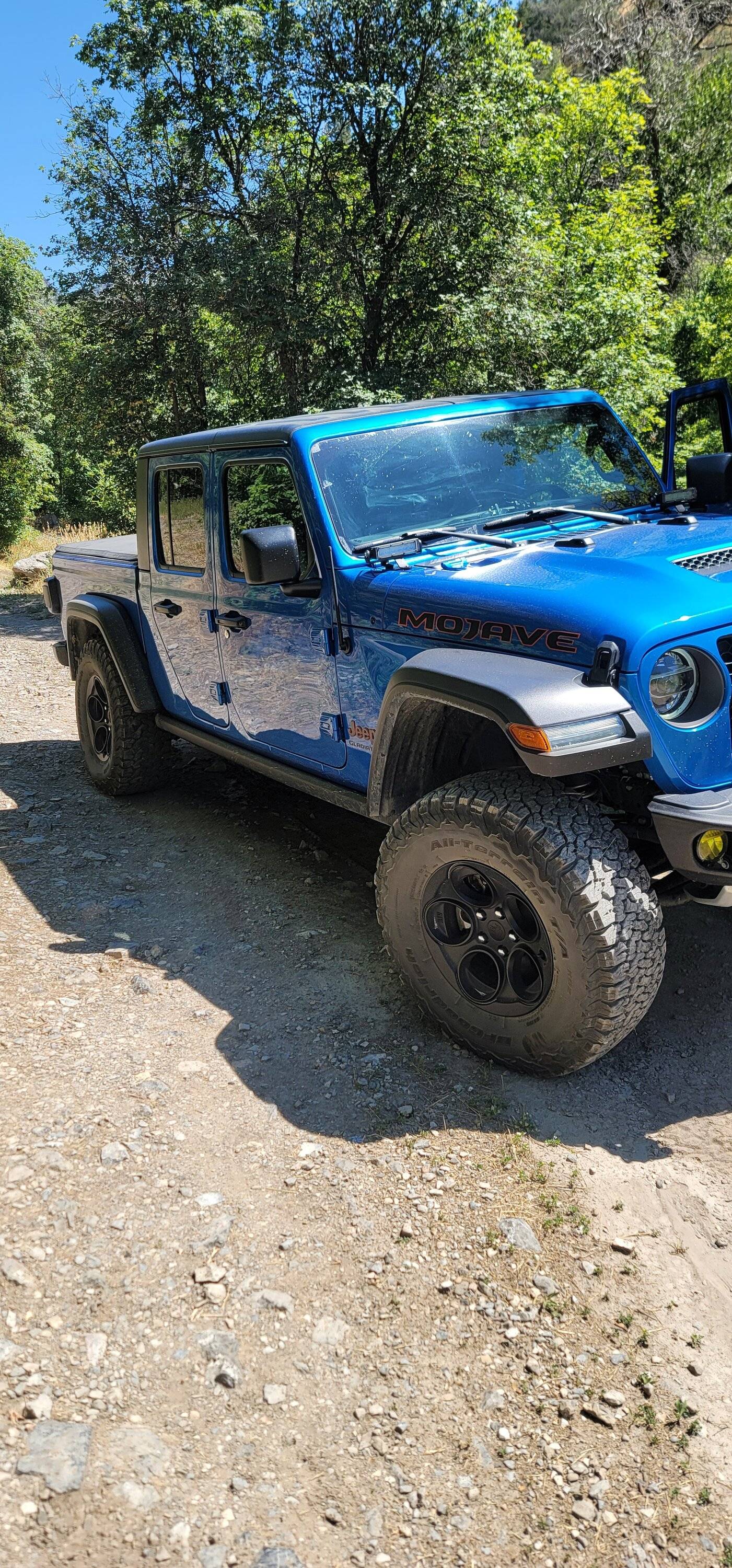

I feel like the truck looks better with the lift obviously. It doesn't do anything extra in terms of Offroad capabilities. If anything the geometry brackets hang a bit lower in my opinion.
Jeep Gladiator ? 20220809_123205

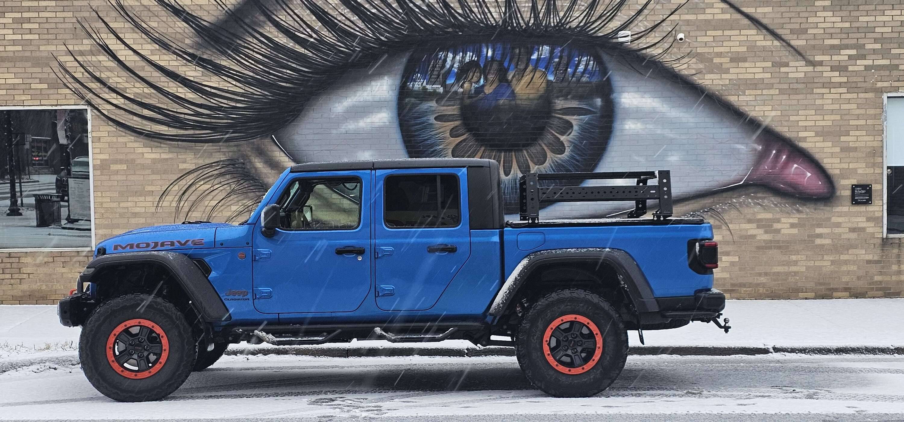

I’ve had the spacers since they came out. I have no correction brackets and it drives great. This is with 37” BFG KO 2’s. Going to 37” Mickey Thompson Baja Boss A/T’s next week.
Jeep Gladiator ? qrdt3Z

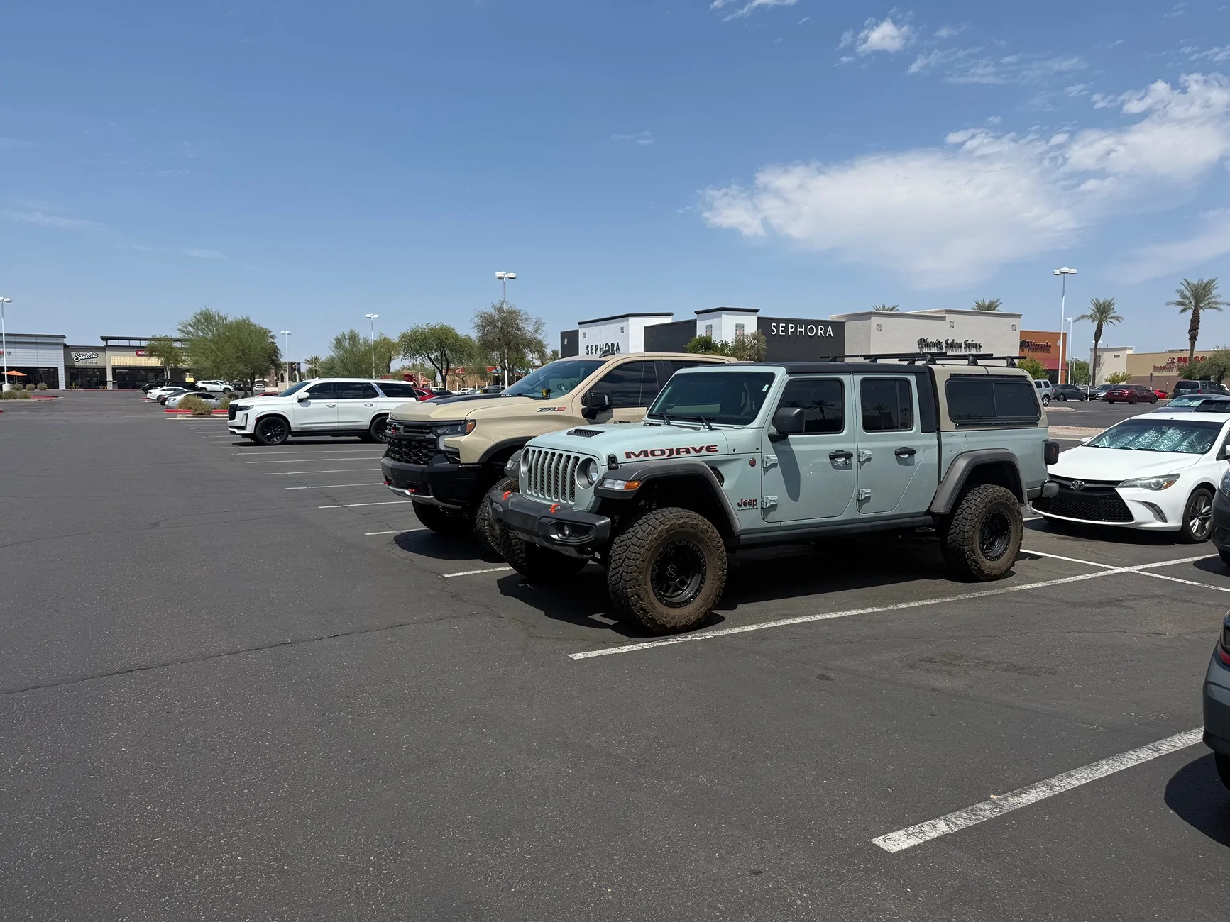

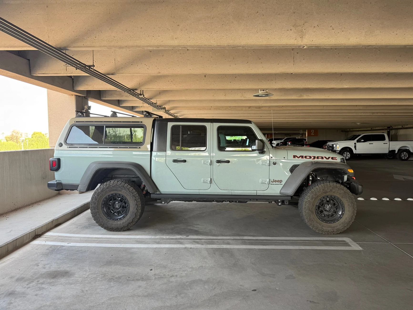

Just posting as others pictures in this thread helped me decide.
2” AEV Mojave spacer lift with geo brackets on opencountry RT 35/12.5/17 on black rhino kelso
