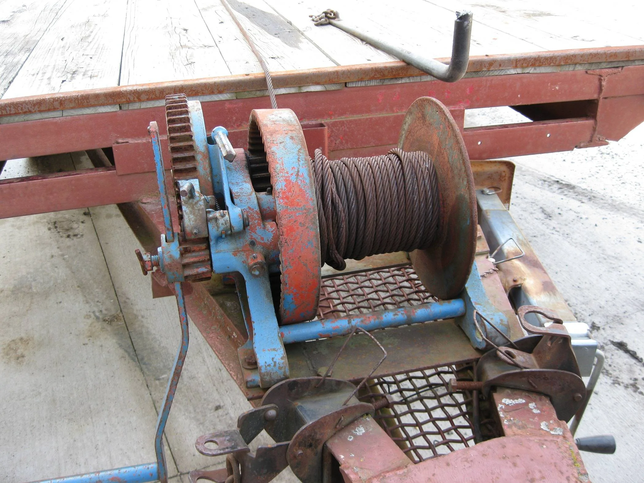

I pulled a locked-up 1980 Eagle Limited station wagon onto my flatbed trailer with all 4 wheels locked. It had sat long enough the rear brakes had enough rust to prevent them from turning, and the guy that had removed the engine left the front differential hanging in the engine bay (it normally was bolted to the engine) and it locked the front axles due to the severe angle so the front wheels were locked up. I backed up to it and used my winch and another guy on a come-along - not even a PTO powered winch, to drag it onto the trailer (watered the ramps and wood trailer bed to make it more slippery)
If I can do it with a hand-crank winch, a truck driver can do it with a hydraulic or pto-powered winch. Heck, some of the Jeep people here pull Jeeps out over worse things with the winch on their bumper.
Jeep Gladiator Don't Get Stranded - Easy Fixes Tips & Tricks (Dead Batteries, Manual Park Release, AutoPark Disengage Etc) trailer 010
So I wonder - would locking all 4 wheels on a Jeep stop them?
Maybe - Eagle = 3,300 pounds, but ordinary street tires. Jeep = 5,000 pounds with larger, wider tires. Maybe it's enough drag and friction?
How does the repo man do it with vehicle for which he has no keys?
Would be interesting to see of any have been hauled away with all 4 wheels locked.
