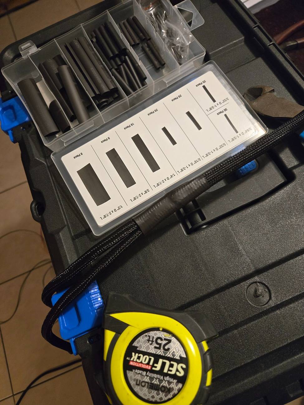

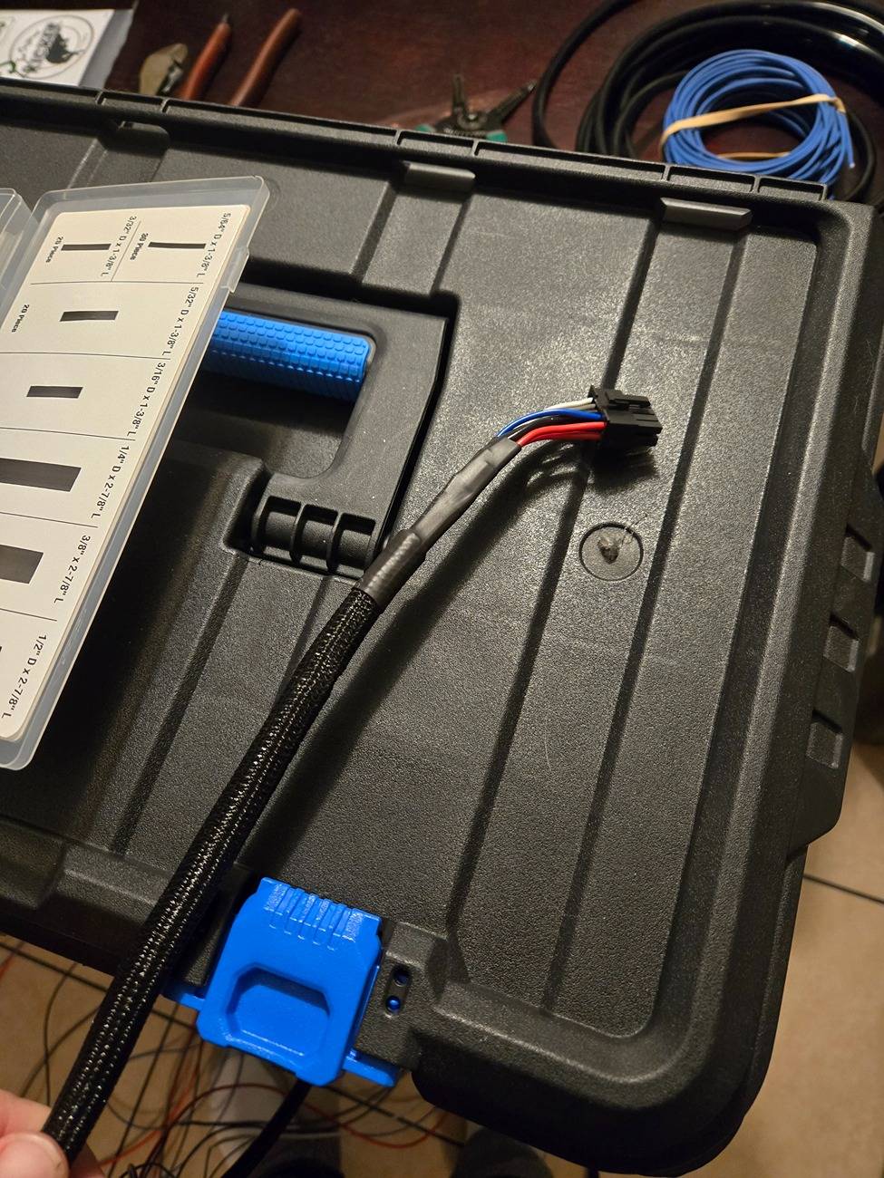

Started by extending the trigger wire and ground wire to be the same length as the rest of the harness.
Jeep Gladiator Kicker 51HS10 Hideaway Sub Install (non-Alpine) 20250717_202821
Loomed it up with some mesh loom - remembered why I hate this stuff and only use it on other peoples projects when they request it. It's harder to put wire in and sometimes the wire likes to puke back out easier. Looks cool though. Not that it matters considering nearly all of it is covered...

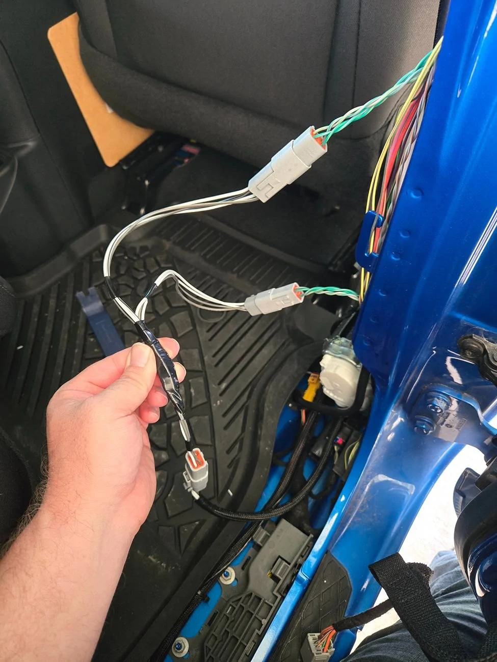

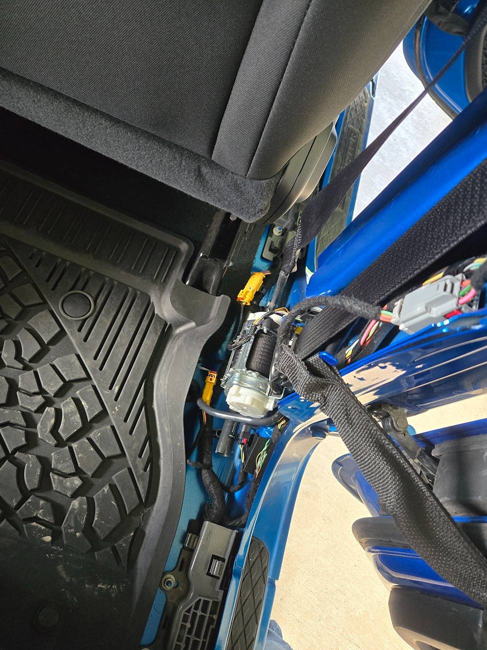

I split the harness here. One part will go up the B-pillar behind the front passenger seat and the other will continue on to other the end.
Jeep Gladiator Kicker 51HS10 Hideaway Sub Install (non-Alpine) 20250717_204453

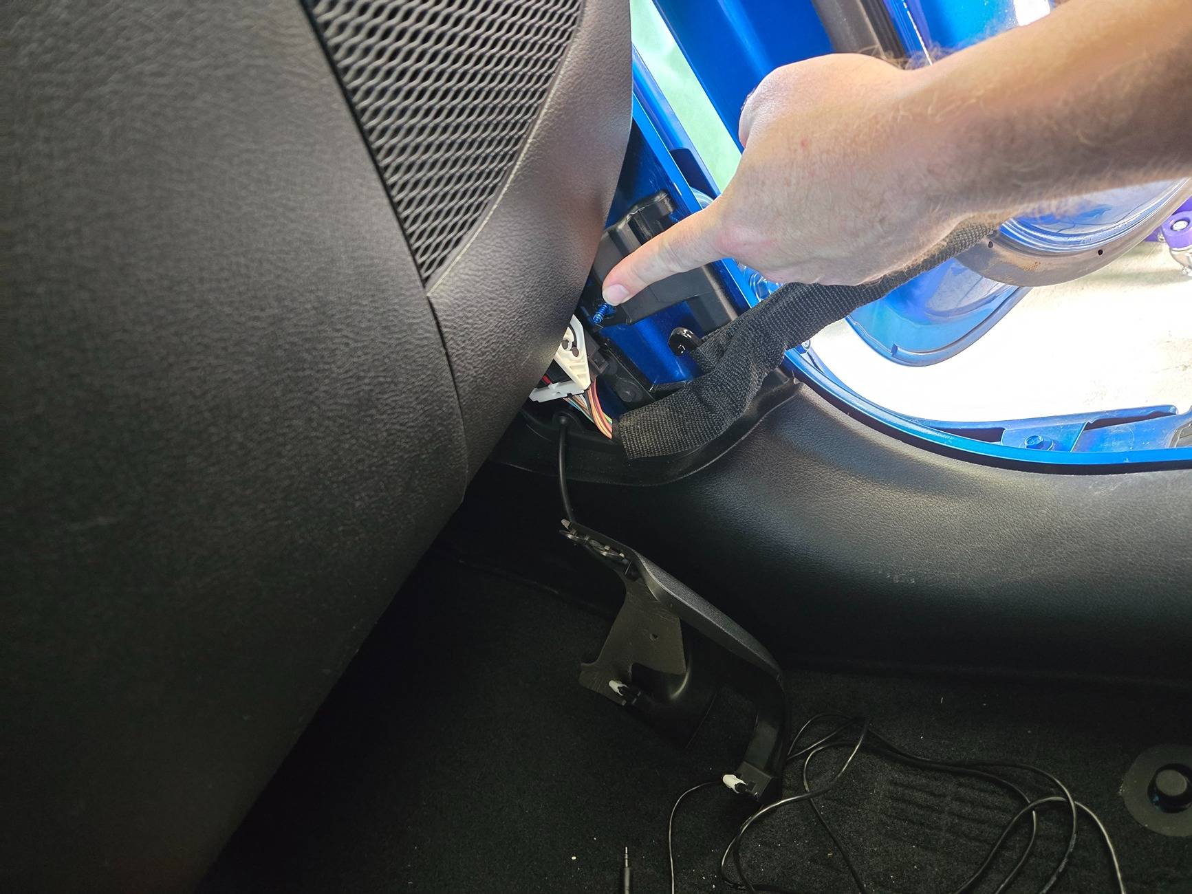

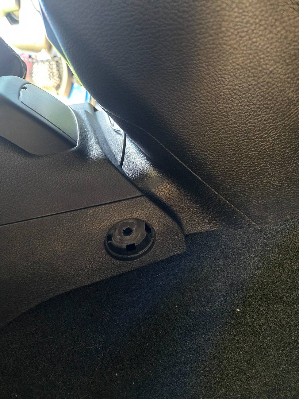

I pulled out the door sill covers and the lower half B-pillar covers. Everything snaps together so just use an interior pry tool and get at it. You could probably avoid this and just shove the wires under the covers. I did everything the overly difficult way. Learned a lot about the truck though.
Jeep Gladiator Kicker 51HS10 Hideaway Sub Install (non-Alpine) 20250718_161709

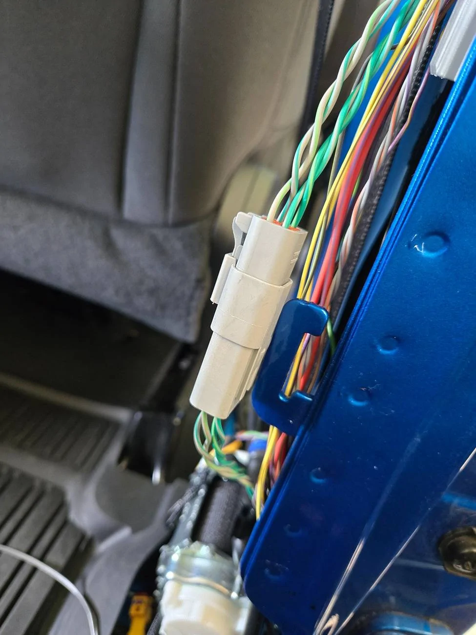

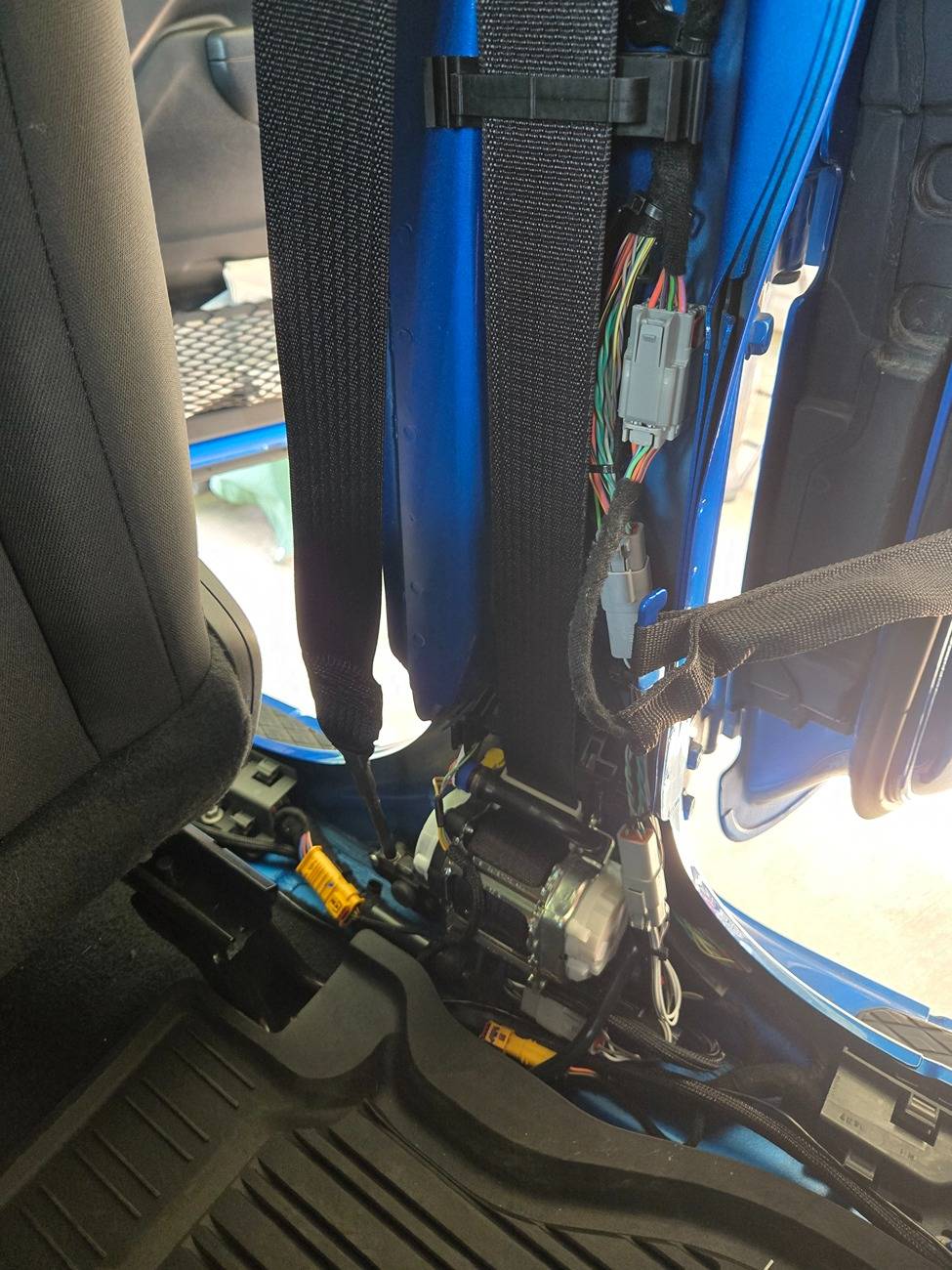

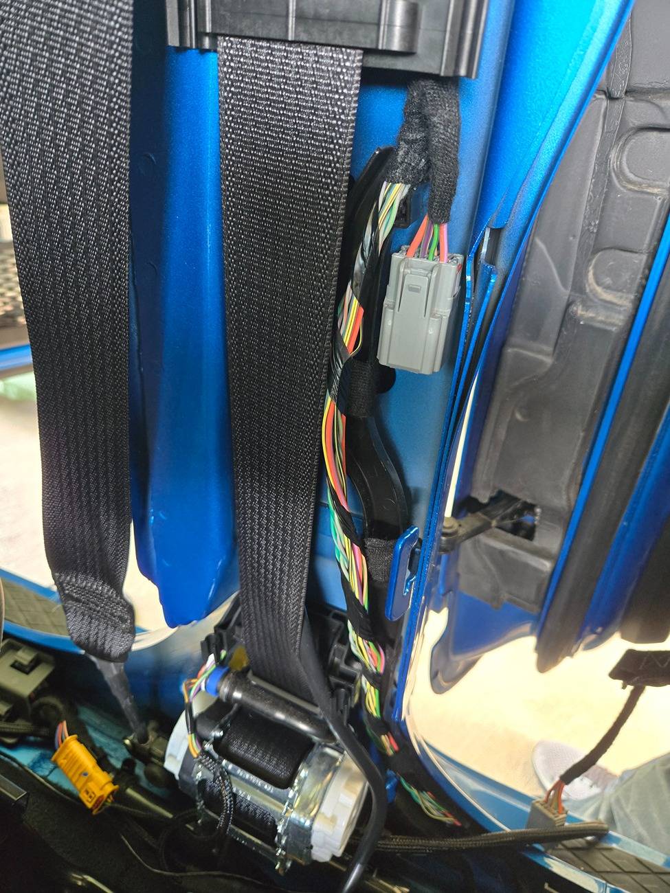

The wires to tie into are located here in the B-pillar. In this photo I already cut the fabric tape that was holding them into the plastic raceway and pulled them out some.
Jeep Gladiator Kicker 51HS10 Hideaway Sub Install (non-Alpine) 20250718_163729

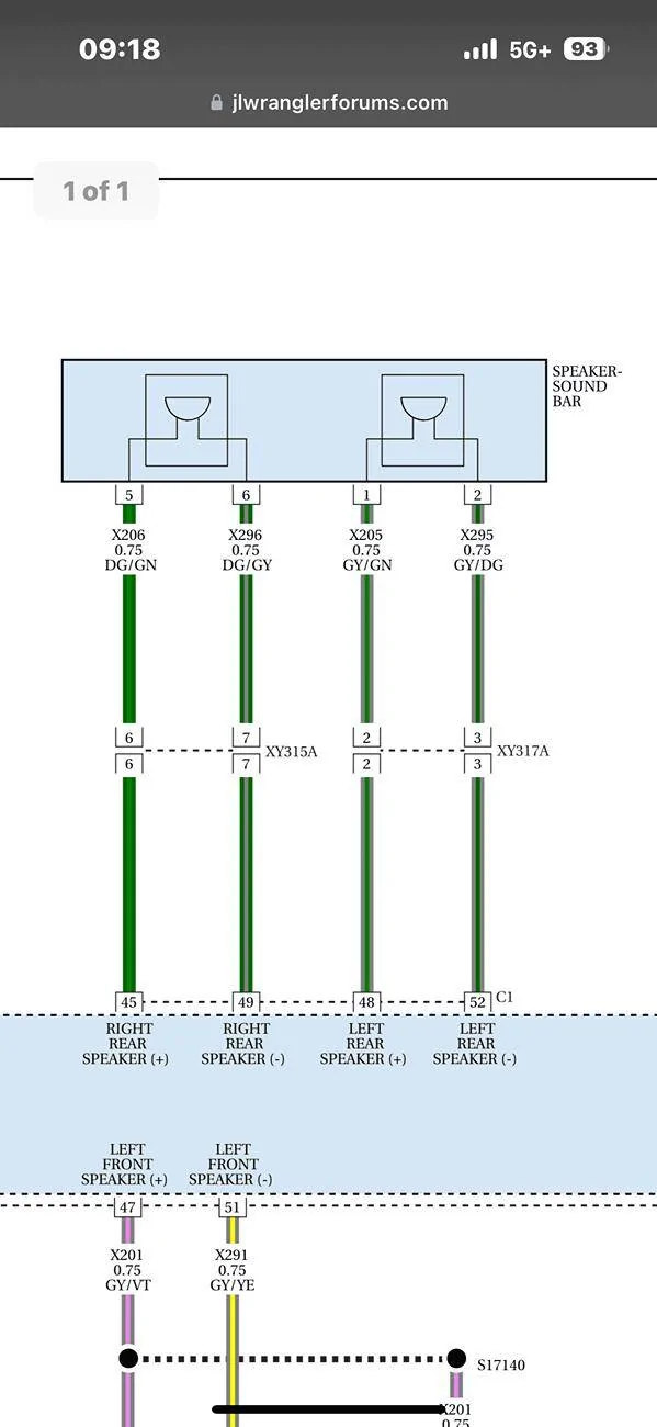

I borrowed this picture from another thread. It's the color code for the speaker wires.

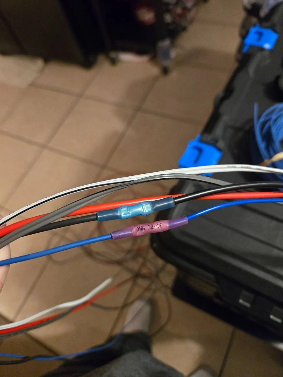

It seems most people use scotch locks or t-taps. I wired emergency vehicles for many years and those were a serious no-no to use. Use what you are comfortable with, but I went with Deutsch connectors and made this Y-harness. If at any point in time I want to remove my sub and harness, I can simply plug the factory wires back together and take my Y-harness, sub harness, and sub out and not leave any wire stubs, or other damage in the harness. Most folks won't have Deutsch connections around, but I keep a supply since I'm the 'hey come wire my hot rod or boat or (insert project here)' guy in my circle.
Jeep Gladiator Kicker 51HS10 Hideaway Sub Install (non-Alpine) 20250718_171507
See, if I remove the sub and sub harness the factory wiring will just plug back together like this.

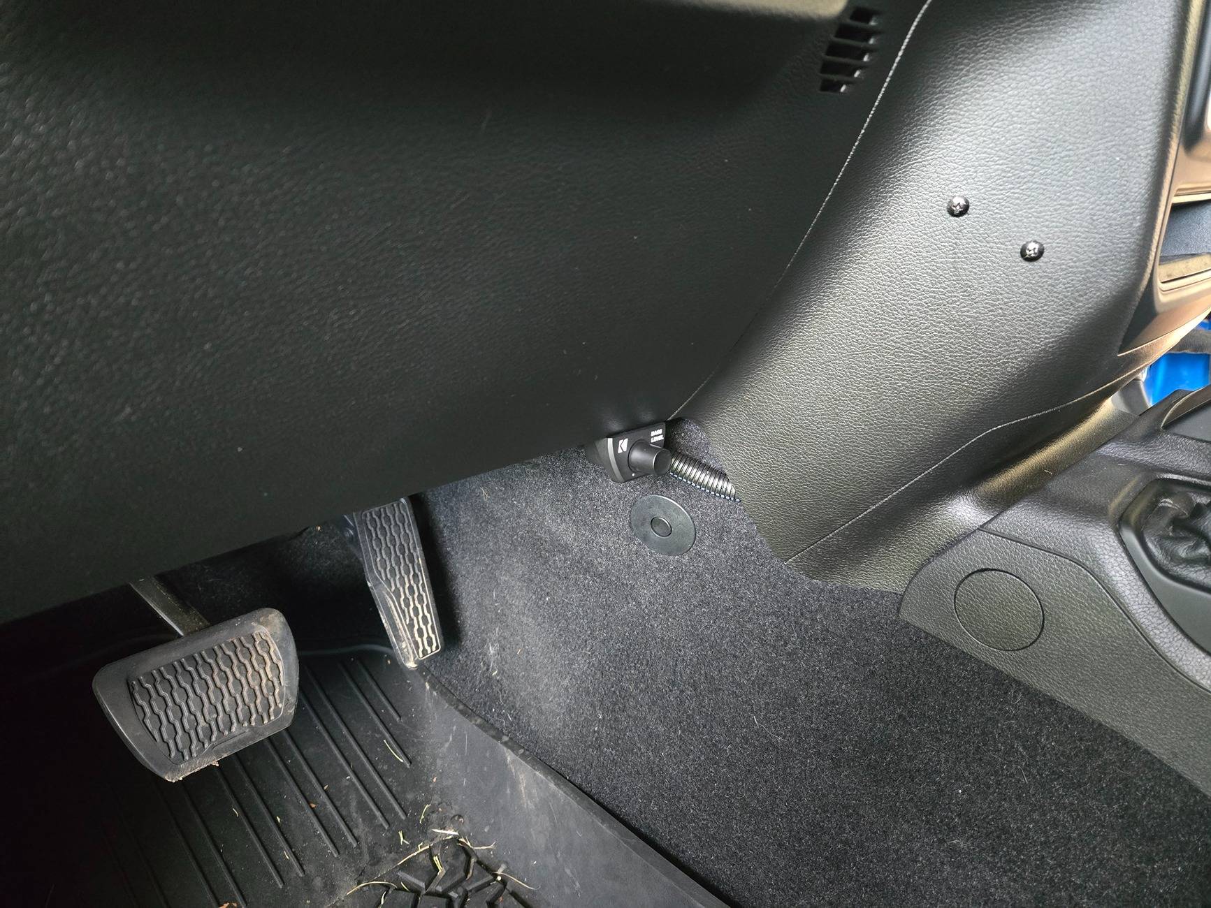

Up front I loosened the kick panel / door sill cover to keep running wires. There is a nut where my finger is pointing you need to remove if you want to move this cover around. The rest of it snaps in.
Jeep Gladiator Kicker 51HS10 Hideaway Sub Install (non-Alpine) 20250718_162946

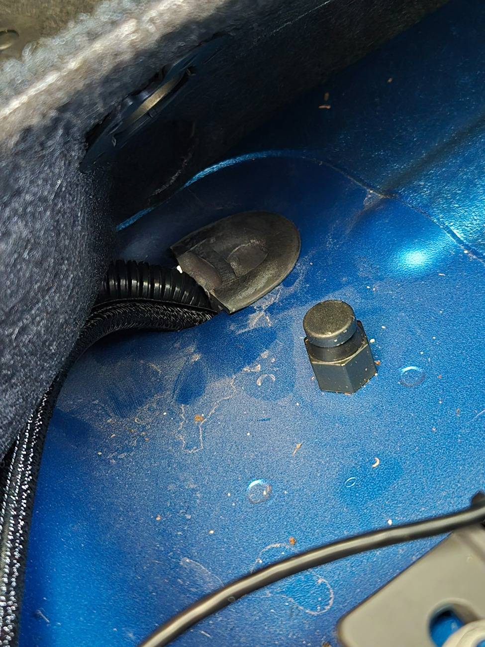

I do not use the drain holes in my truck for draining water, because I don't take the top or doors off and take my floor mats out to clean them. This is the drain hole under the passenger front floor mat.
So anyway I had already used this hole to run the wires for the power outlets I installed in the back of the console. I am now using it for the sub harness. I use the original plug, cut in half, to close up the rest of the hole. There are a variety of other ways to get under the hood including shoving it through the harness boot under the dash or under the windshield frame.
My wire goes under the truck and runs along the frame rail with a bundle of other wires I already have running everywhere then runs up the back of the passenger front fender liner, along the firewall, and up beside the fuse box to get beside the battery.

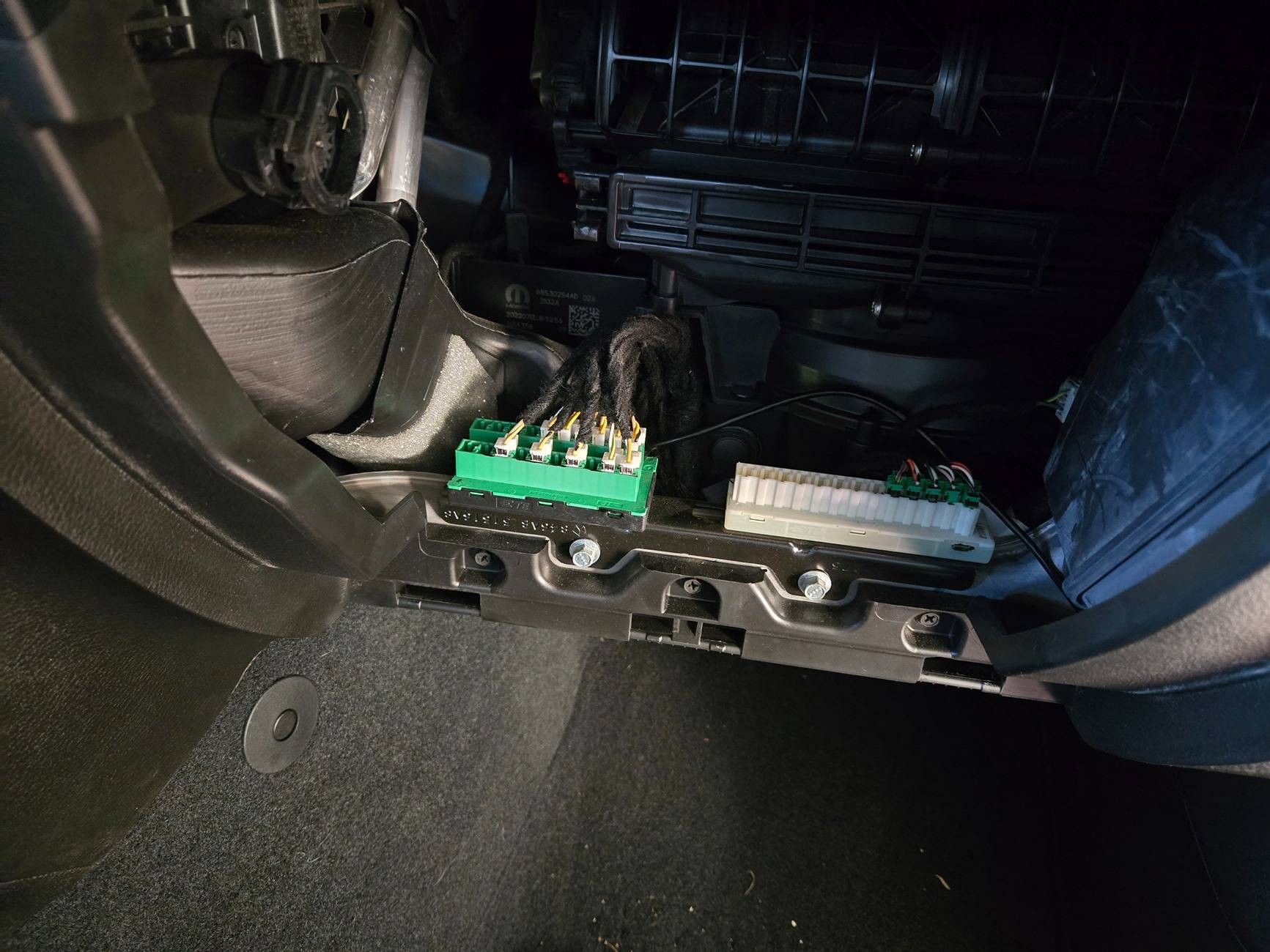

Jeep Gladiator Kicker 51HS10 Hideaway Sub Install (non-Alpine) 20250719_073519

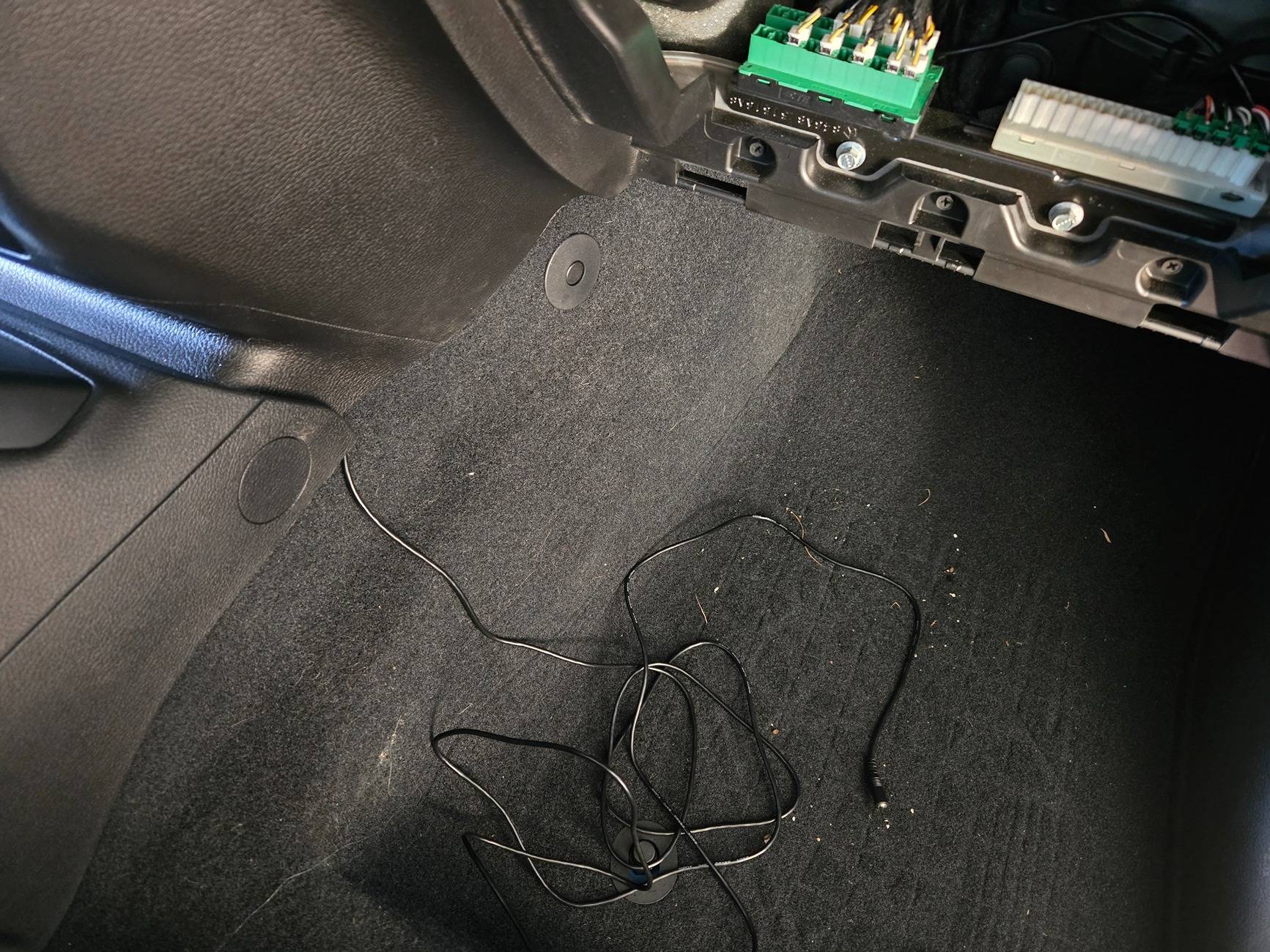

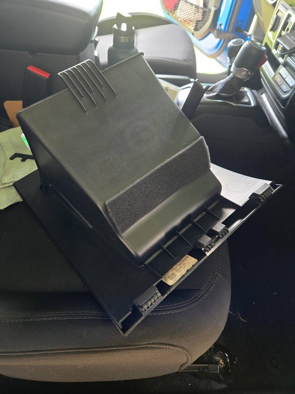

I took the glove box out and ran the bass knob cable through here, behind the CANBUS wires and blocks.
Jeep Gladiator Kicker 51HS10 Hideaway Sub Install (non-Alpine) 20250719_070908
Tucked cable under the dash to this point.
Jeep Gladiator Kicker 51HS10 Hideaway Sub Install (non-Alpine) 20250719_070911

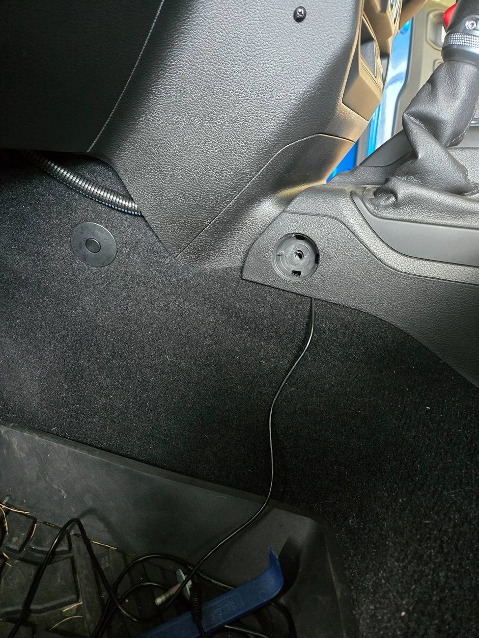

Took out this console screw and ran the cable to the rear of the screw so that it would not fall out of the front of the console so easy. Put screw back in and pulled gently to confirm I didn't pinch the cable.
Jeep Gladiator Kicker 51HS10 Hideaway Sub Install (non-Alpine) 20250719_071315
Same on this side - ran cable to the rear of the console screw and reinstalled the screw.
Jeep Gladiator Kicker 51HS10 Hideaway Sub Install (non-Alpine) 20250719_071551
Bass knob mounted below my right knee. Extra cable bundled neatly and tucked in the void behind the carpet. This isn't my favorite position as I have to lean forward and reach down slightly, but it is fine for now. I may eventually move it to a more convenient location. It's not been a big deal so far.

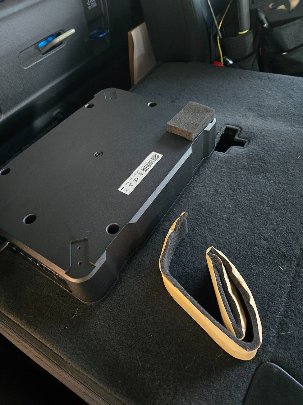

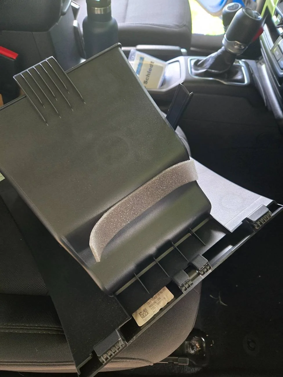

This foam came with a window unit AC but we didn't need it (was temporary while I was waiting for a blower motor for my central air) but I kept it in the 'house box' in case I ever needed it. Well - here it is. I put three pieces on the bottom of the sub to help dampen vibrations.
Jeep Gladiator Kicker 51HS10 Hideaway Sub Install (non-Alpine) 20250719_064914

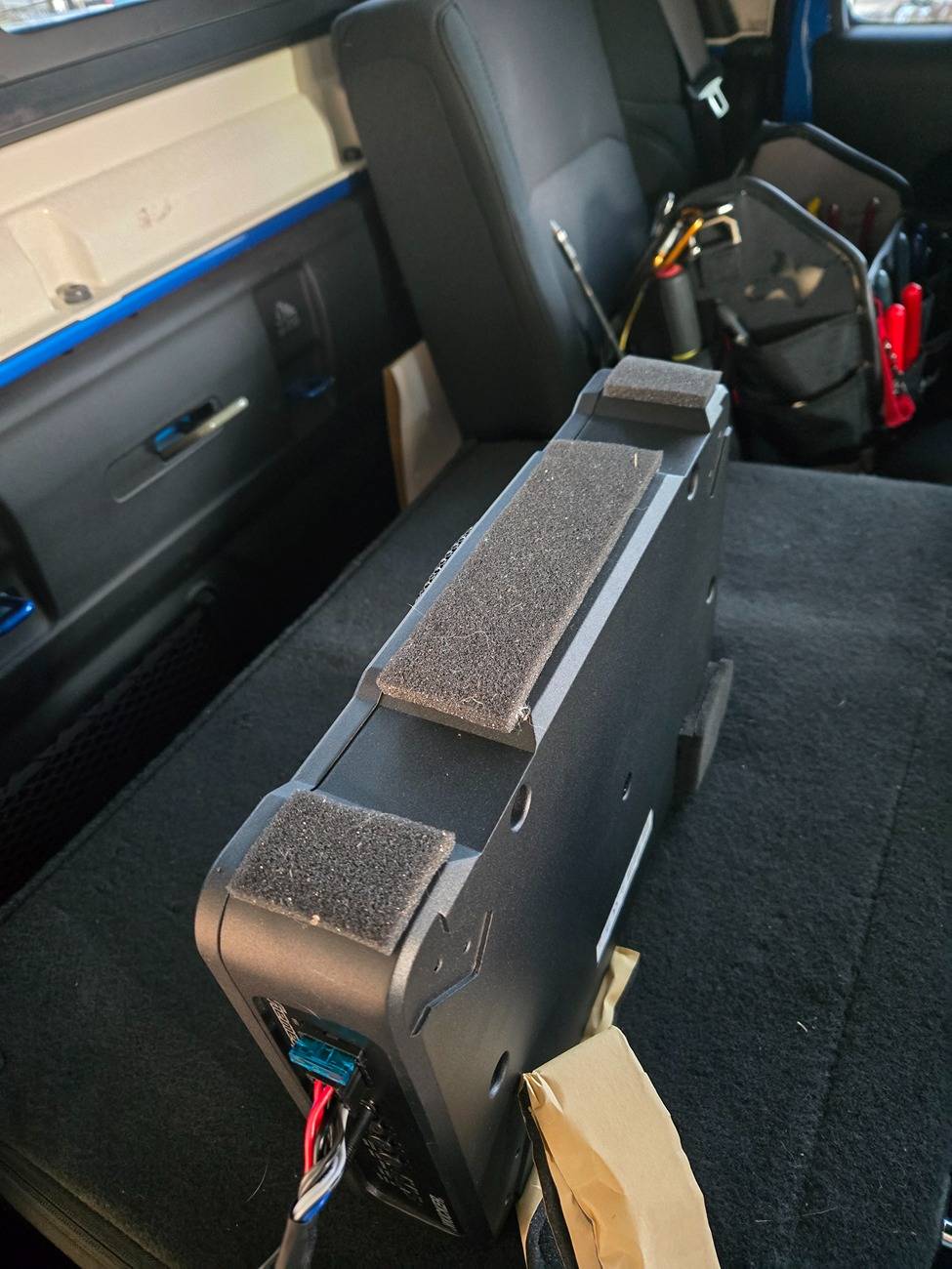

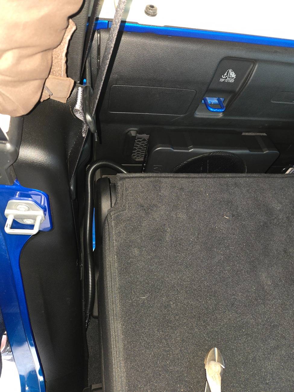

I also stacked two pieces on this corner where it leans against the net mount on the back wall.
Jeep Gladiator Kicker 51HS10 Hideaway Sub Install (non-Alpine) 20250719_064906
This is what the install looks like. I covered the harness and the separate bass cable with another piece of loom to protect / pretty it up. It runs down past the back seat a little until it goes under the sill cover. The sub is just sitting in the tray behind the seat, it's not affixed to anything.
Jeep Gladiator Kicker 51HS10 Hideaway Sub Install (non-Alpine) 20250719_065514

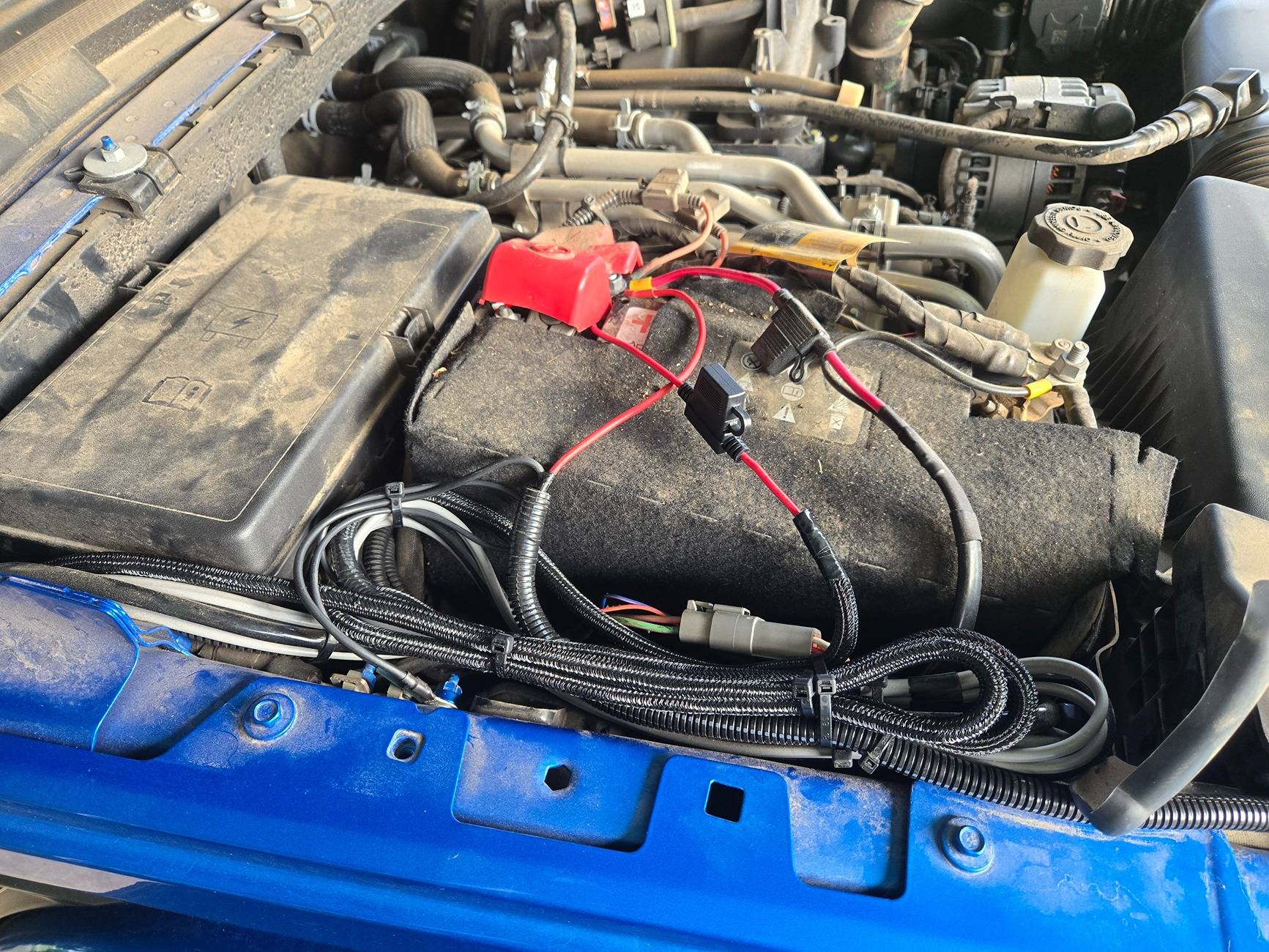

I built mine as three harnesses, all loomed as well, but ditching the flimsy power wires. Multiple times I thought about taking pictures, but then quickly forgot.
-Power from battery down drivers side, ground from stud under passenger crossed through the console to join the power and terminate at a heavy amp plug behind the back seat. Went with 8g OFC wire to give me a little room to upgrade in the future. I considered 4, but didn't want to struggle to find room to tuck it.
-Speakers tapped into a flat-4 trailer plug that travels to the same spot behind the back seat.
-Kicker harness gets cut down to stubs and linked to the other side of both the power plug and trailer plug. The power plug has screw connections and I put bullet plugs in the middle of the speaker side so this harness can easily come apart and adapt to a new system if I ever decide to.

I wired the sub positive DC input directly to the Aux harness under the glove compartment
Yeah, I'm sure this thing will be fine considering the tiny wire they ship it with. I beefed mine up in case I want to upgrade in the future.
Now that I've driven around with it a little, I'm pretty sure I won't need to. When I came home today with it thumping, I walked in to my wife asking "what did you do?!"!". Windows are closed and she was upstairs at the other end of the house, so I guess this is enough. :LOL:
I use the factory ground stud on the fender frame for all my grounds I add except for the winch. I used the included fuse holder to connect to the battery and tied up all slack along the battery. I did not shorten the harness in case I want to use it somewhere else later, and I have plenty space here. I sealed off the blue trigger wire and taped it inside the loom. I am using the DC offset activation that turns the amp on when it senses speaker signal. Turns out, this makes the amp turn on when you open the door and it stays on until the dome light goes out and the truck 'goes to sleep'. If it becomes an issue I will use an add-a-fuse to get ignition from the fuse box. I may do that regardless, but I only have mini add a fuses and the Gladiator uses micro fuses and I wasn't paying $10 for one at Oreillys.
I want to add a Blue Sea fuse block and ground bus here on a bracket at some point as I am up to four or five fuse holders and I don't want this to look janky.

Oh, this foam that helps protect the CAN wires was falling off.
So new foam before I put it back in.

Sweet! I assume you didn't use the PAC audio module. It's like a line output converter, but like $300+. You don't need to tap into existing speaker wires and you can "configure" it to what ever your stock system is (factory amplified or not).
I would be a little nervous running wires through the drain holes though. Exposed to road grime and they may chafe the wire over time. Going through the firewall isn't too difficult.
I'm not paying $300 for what the line level connection does fine. Now, if I get to the point where I add dash speakers, sound bar speakers, and something like the mini Alpine amp I can add in the dash, maybe. But honestly after a few days with the subwoofer alone I am doubting I ever get to that point.
No issues with wires through the drain holes. The power outlets wires have already been in there for three years now. That's what the loom is for (to protect the wires). Next time I'm under there I may slide a piece of loom around the hole for added insurance, but its been a non-issue so far. There is a slight amount of dust under the carpet beside the hole, not worried about that.
As for wires exposed to road grime - not even concerned. I have probably a hundred feet or more of wire ran under the truck at this point, end to end. All loomed or double sheathed, and secured.
It was still way easier than contorting myself under the dash or behind the fender liner and jamming a hole through the factory rubber grommet that I cannot replace once I damage it. This however, I can pull the wires out, throw a new plug in the floor, and nobody is the wiser.
Do you have a manual? I wouldn't trust that rubber grommet method either, but going through the clutch pedal hole was simple enough and easily reversed.
