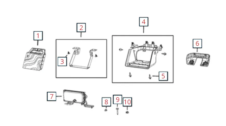

I am about to embark on adding ACC on my 2023 JTRD.
Do I need to purchase new ARB control module and the pump assembly? (Which I do not mind doing to have this function).
- I found the Ram forum document. The answer is yes. New ACC capable ABS modules are needed.
DASM (Driver Assistant System Module), is this the ACC Front Cam that sits over the front?
- Yes. DASM = Front Cam Assmebly.
So far, I learned:
Need trim pieces, DASM unit, wiring for the DASM, Heating element wiring, ABS related components.
Used DASM and ABS components can be used.
ABS unit VIN can be reset with AlfaOBD. While Original VIN value is retained. "Current" value is to be reprogrammed.
