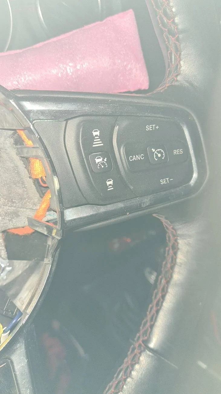

Hi,
I bought Jeep Gladiator Rubicon 2020 but I don't have anything in the box Infront of my mirror (only wires) and I want to restore all missing items. I think it had an ACC because of the buttons on the steering wheel.
Jeep Gladiator Can you add Adaptive Cruise Control (ACC) 1000004795
I am in East Europe and there isn't Jeep dealership. Pls help and sry for my English...
