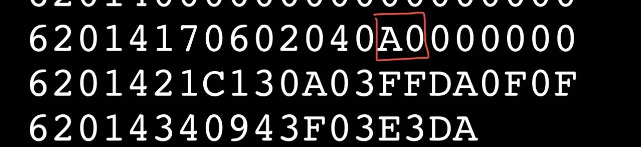

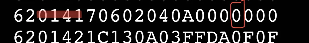

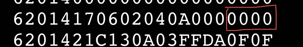

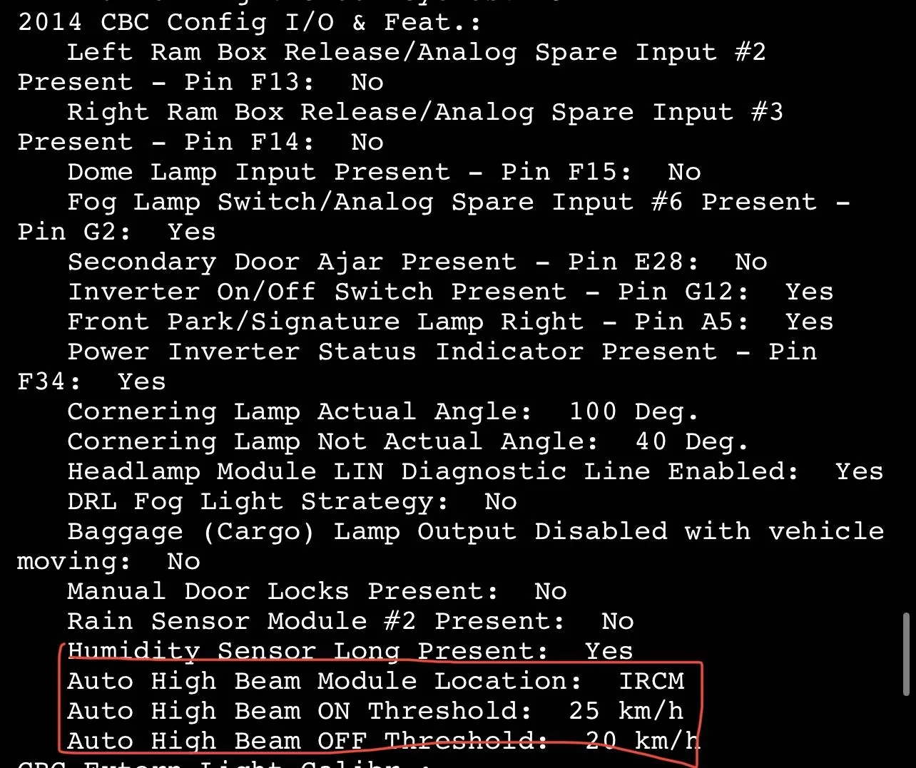

Even though it’s popping up as reserved, it should still be changing the correct bit for IRCM, but possibly not broadcasting it.
Can you post your current AlfaOBD backup file with that setting set to IRCM (this is the file that has a bunch of line items of numbers and letters that all start with 62)?
Do you have a canbus logger?
I have attached the backup file. Canbus logger? I don't think so. Is it needed? If so, any you recommend? I noticed there are also 3 other reserved settings you can select. How does it differeniate between them? Is it based off a number value thats held in a specific memory slot and not the actual verbage?
