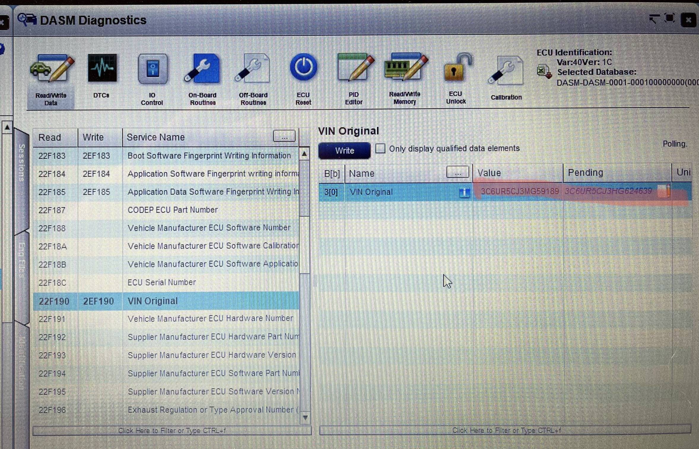

I"m considering trying something like this.
That should definitely do it.
Here’s the issue when using normal means of trying to change the VIN:

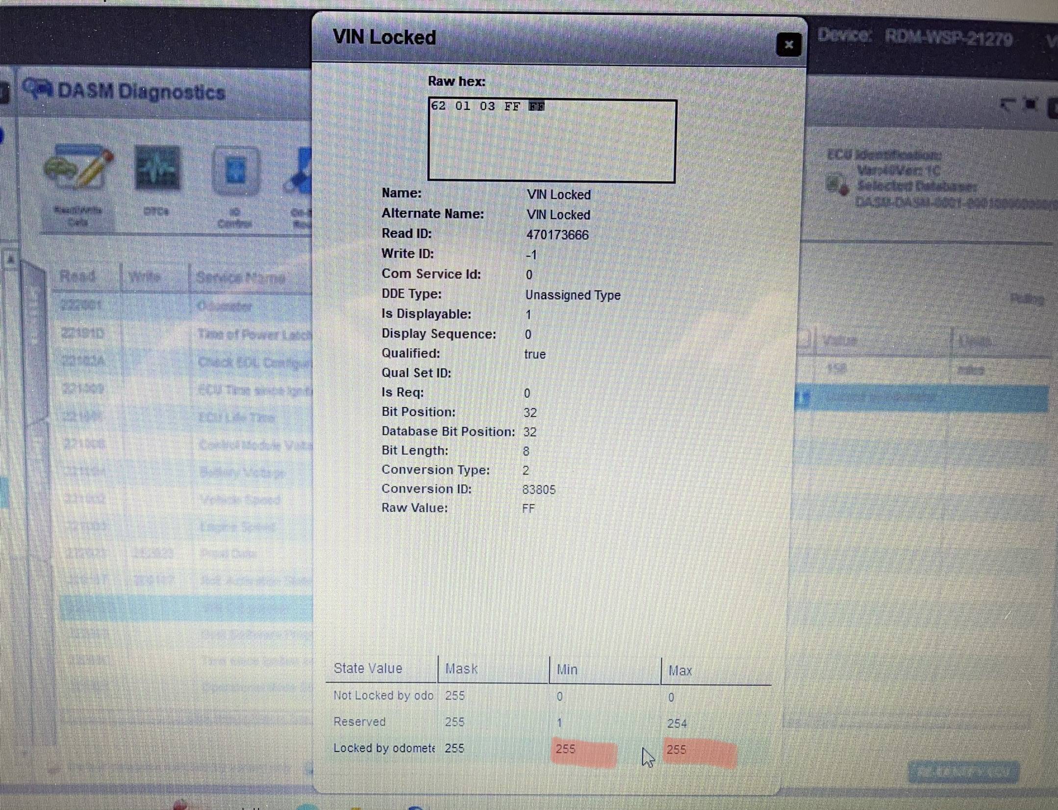

Here, you can see that the VIN is locked, and in the “write” column, there is no option to write to the VIN odometer:
Jeep Gladiator ACC (Adaptive Cruise) Retrofit >> Underway, PSA 5911209A-965A-4F08-8238-5FA7952C7F55

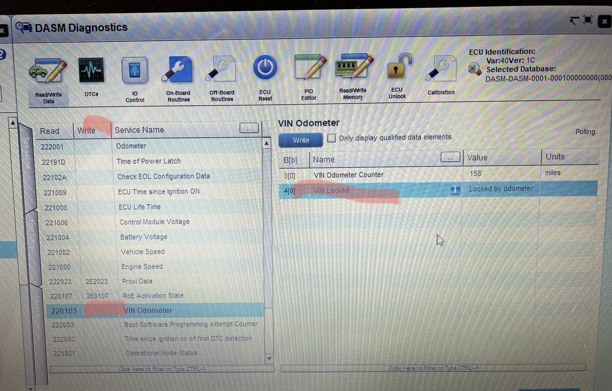

And here is the reason the CPU prevents the VIN from being written to the eeprom, because these values would need to be reset to 0, but since there no write function…
Jeep Gladiator ACC (Adaptive Cruise) Retrofit >> Underway, PSA 18FA56D1-38DA-41BE-9214-FDCF2C036899

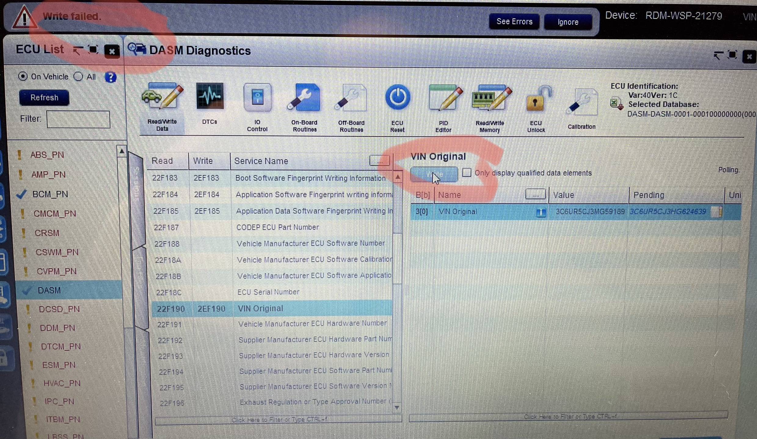

Here it shows that the VIN CAN be written, but since it’s locked, it fails to write:
Jeep Gladiator ACC (Adaptive Cruise) Retrofit >> Underway, PSA 95FBBE6E-F8B5-4668-96BB-E5300E21B460
Jeep Gladiator ACC (Adaptive Cruise) Retrofit >> Underway, PSA 7AF4F924-93ED-4F3D-9F95-02EC3DC2DFC7
