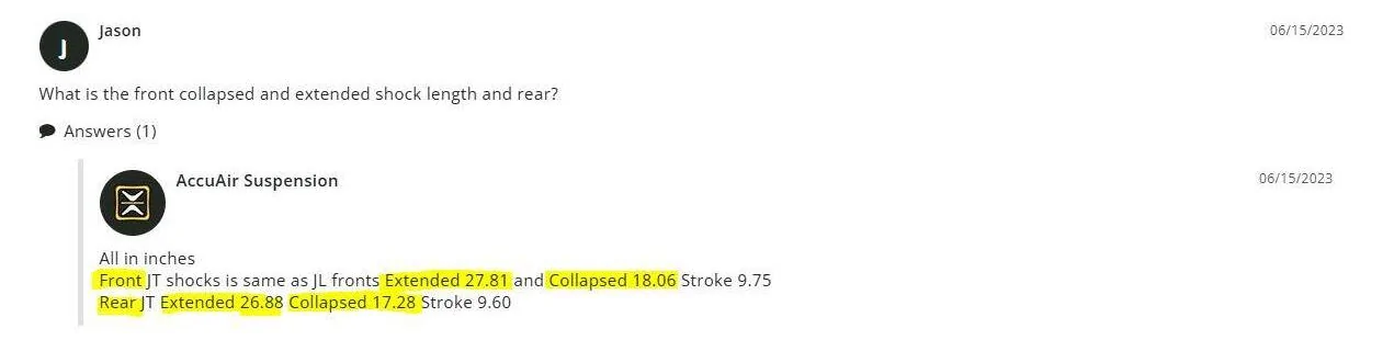

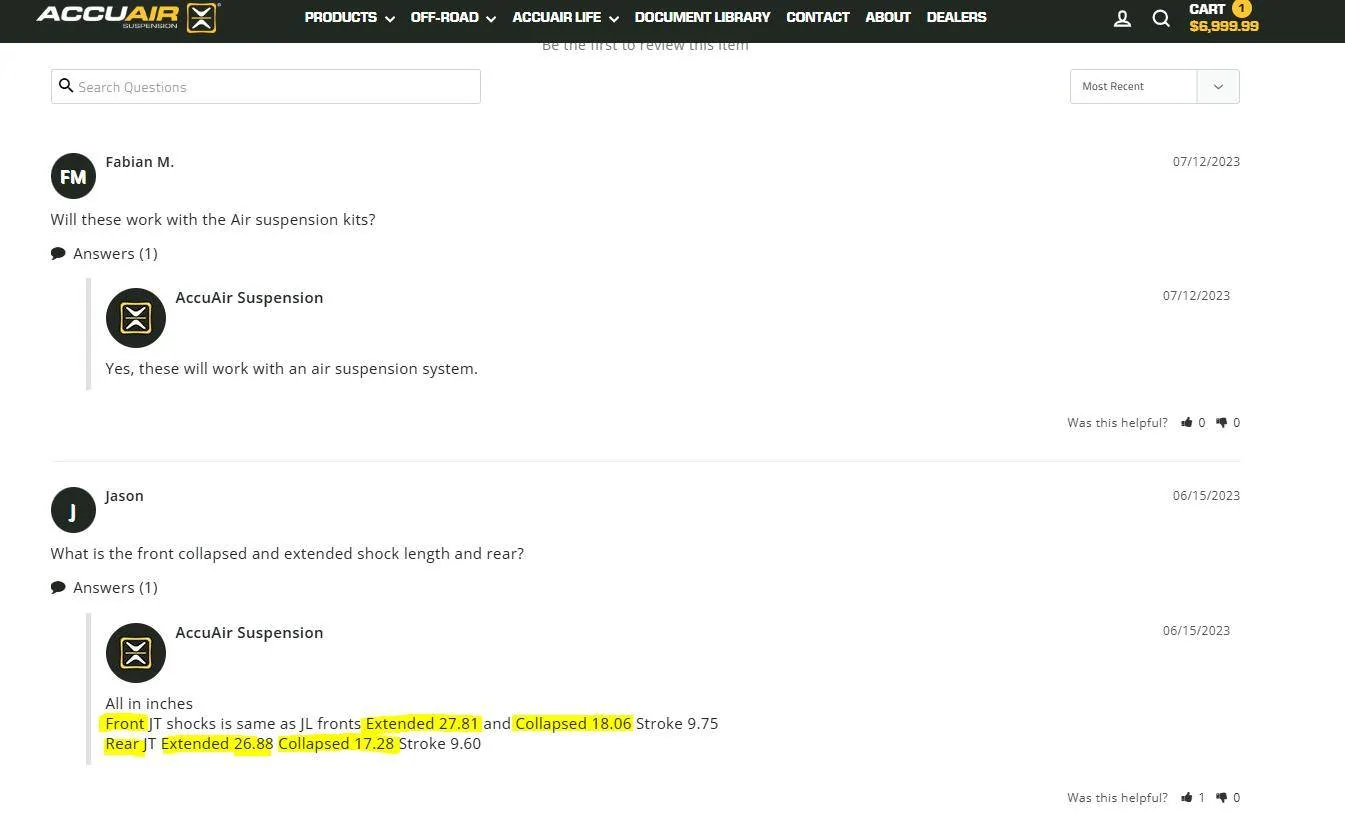

It also prompted me to ask an online question at Accuair's website (because I forgot to ask in person) what are the shock specifications for the JT? They responded with "the JT shock is a 2" shock body with a 27" extended length and a 17.5" compressed."
Also, this is posted on Accuairs website's under the Q&A for the JRi adjustables = https://accuair.com/collections/shocks/products/jri-jeep-jt-adjustable-shock-kit

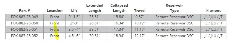

Here's the Fox Elite 2.5 shock length tables from Poly Performance as reference. The rear Fox options all appear to have a longer extended length and would likely require limiting straps to reduce overall stroke travel. The Fox front 2-3" option (26.51" extended) seems in acceptable range but you'll appear to lose over an inch of droop vs the JRi's (27.81" extended)
Here's the Fox Elite 2.5 shock length tables from Poly Performance as reference... I guess pick the closest numbers to JRi?
