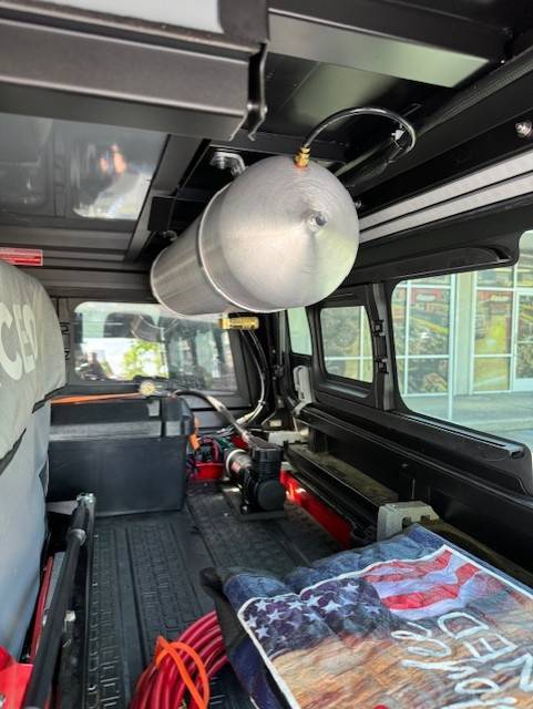

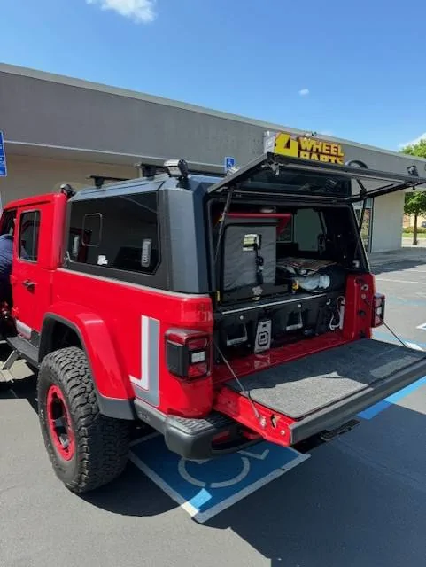

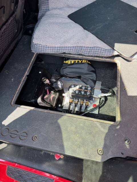

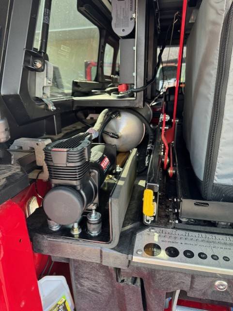

We put a kit on a diesel and put everything in the bed. We did 2 5 gallon tanks and 2 compressors. You will not be happy with less air unless you never plan on adjusting your suspension.
My customer also had a Rsi cap and a deck system. I didn't grab any inside bed pics.
