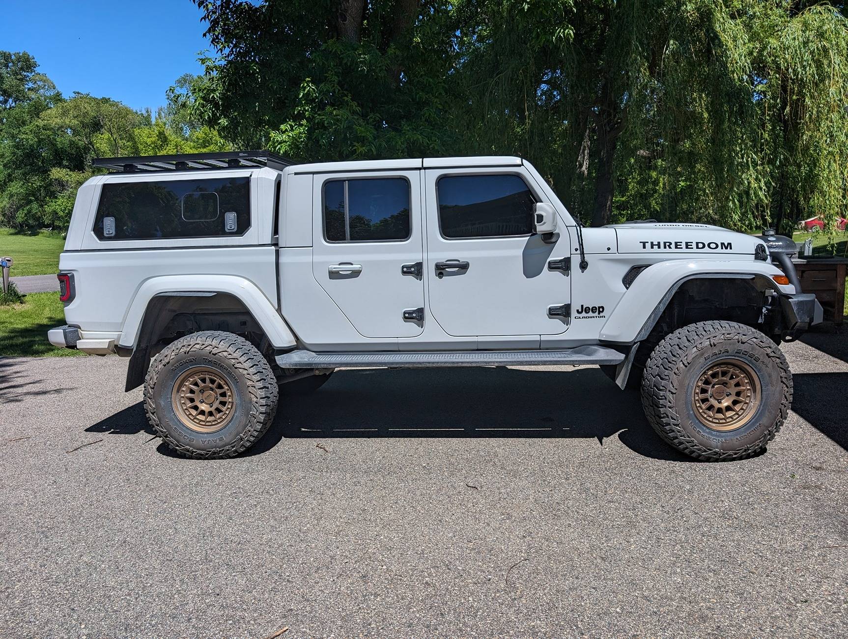

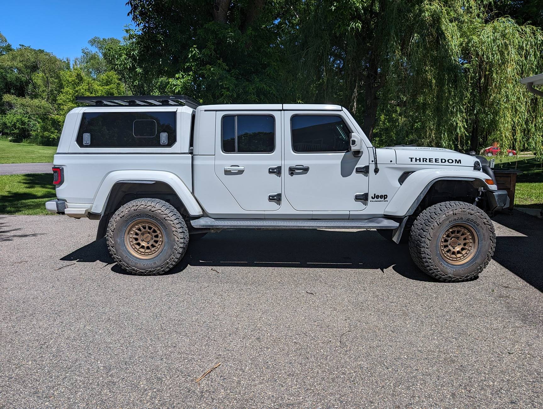

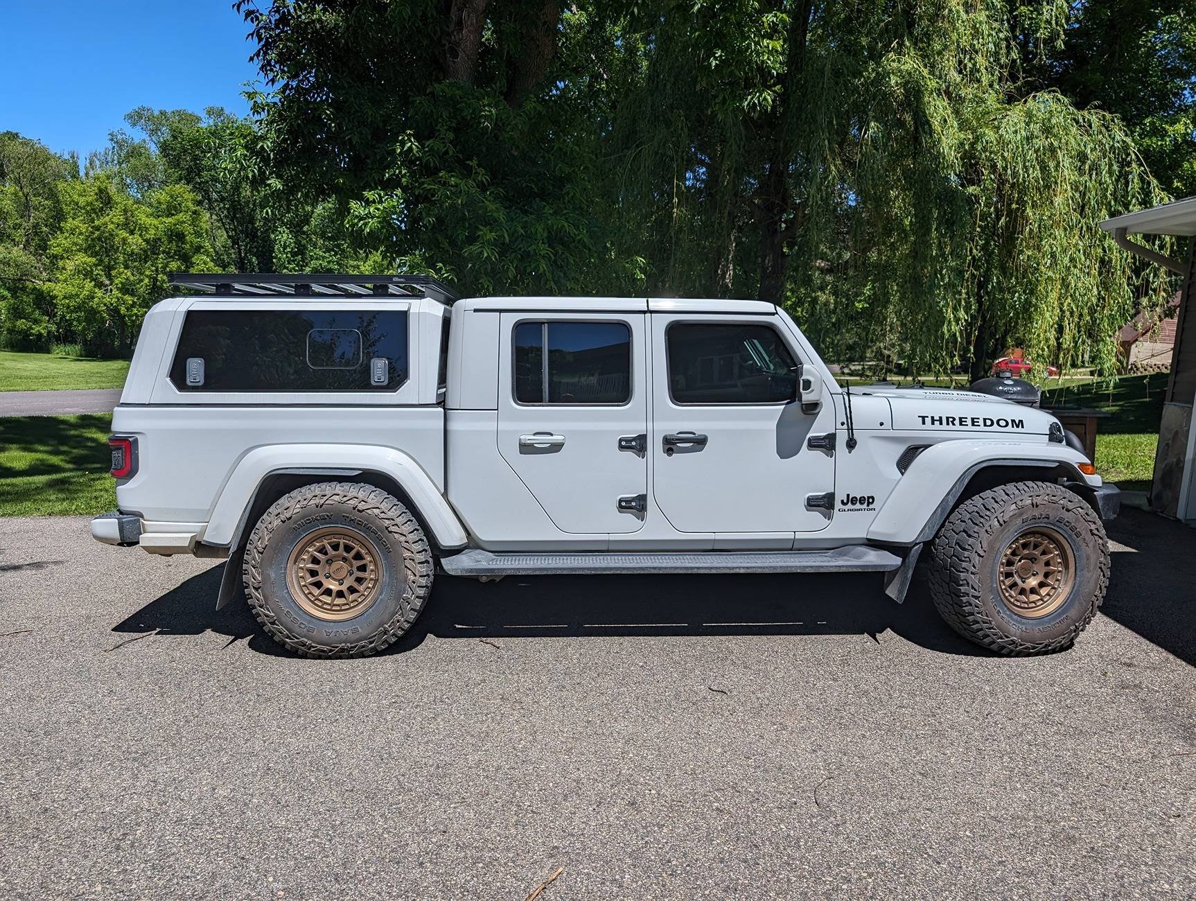

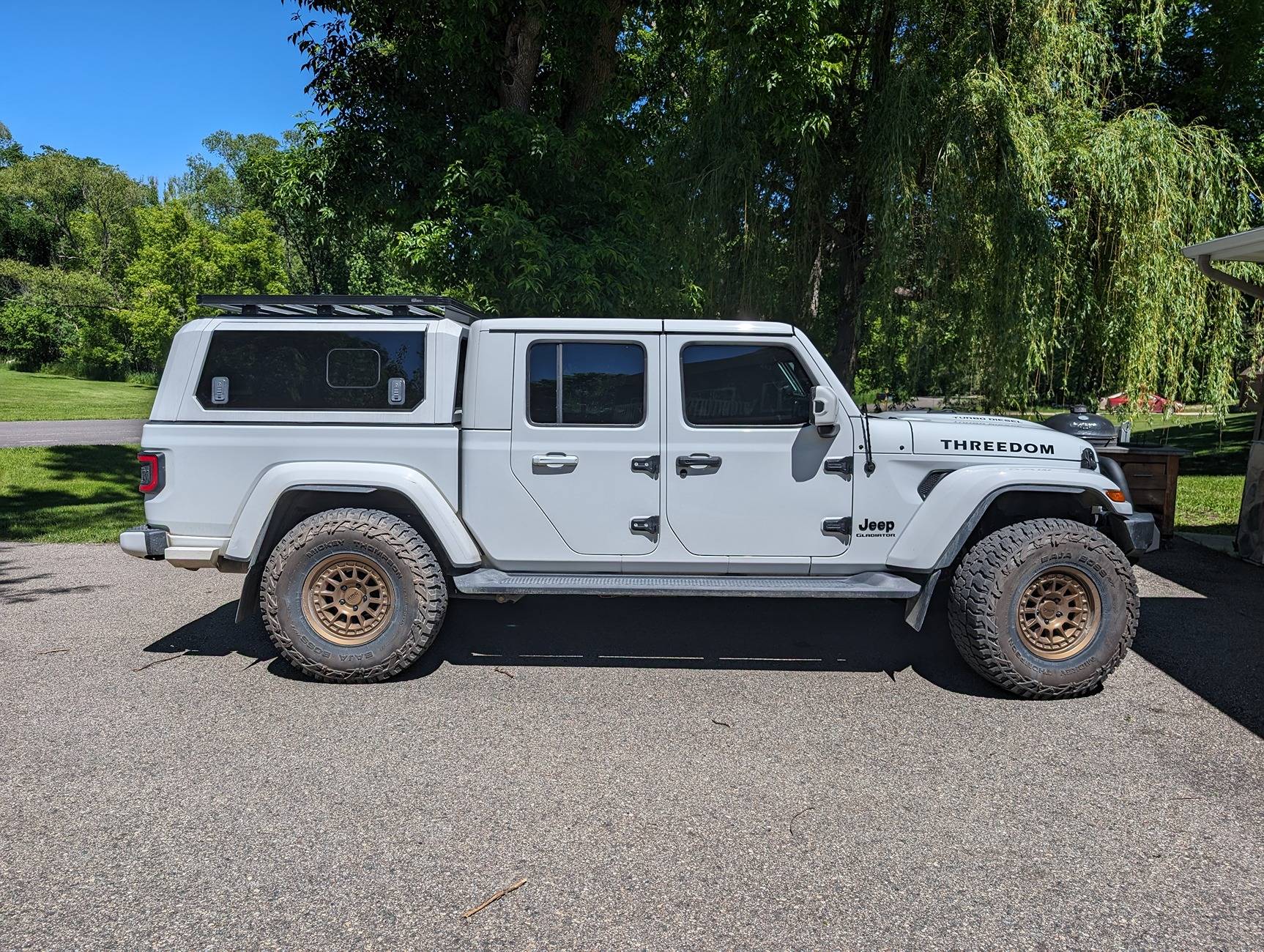

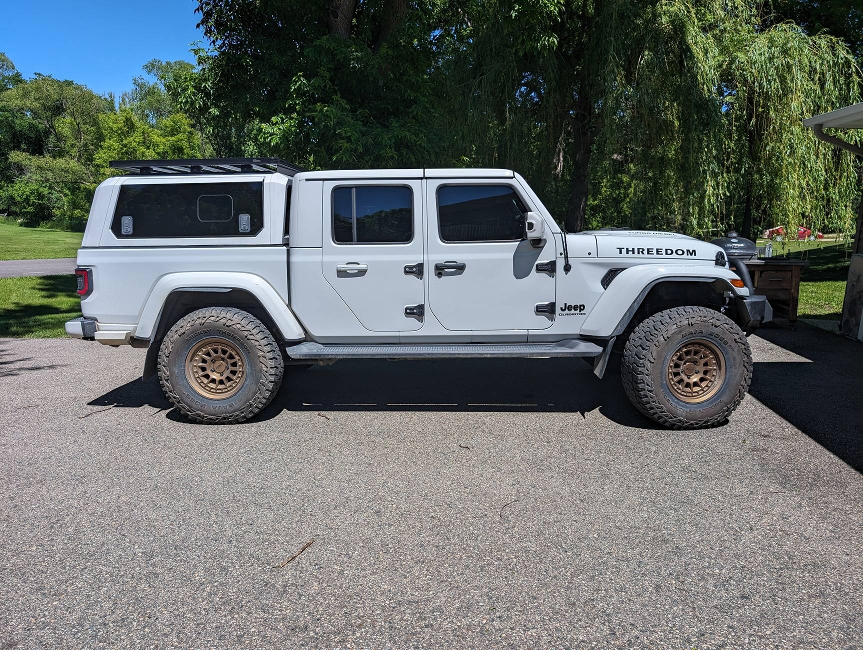

I have had the AccuAir system installed on my JTD for about 5k miles now, and I love it. It's fantastic for towing and hauling heavy loads; the ride is nice, too. Best of all, I can park in parking garages when traveling!
Pro-Tip: Get a second compressor and immediately buy the compressor rubber/spring mount kit from AccuAir.
I'm including a few photos of the Gladdy with the kit. I mounted the controller where the factory Alpine sub was (replaced by the Kicker 10")
To anyone who has the kit installed, have you run into issues with dealer diagnostics through the OBD2 port? I've found the dealer cannot connect to the system with the Mopar VCI and I am also unable to communicate with my Mopar MicroPod. I'm trying to diagnose the issue and AccuAir support is worthless and arrogant.
Lowest Level
Jeep Gladiator AcccuAir Lift System 2024-06-01 12.02.25
Level 1: Lowest driving level
Jeep Gladiator AcccuAir Lift System 2024-06-01 12.02.07
Level 2: Normal driving level
Jeep Gladiator AcccuAir Lift System 2024-06-01 12.00.56
Level 3:Offroad level
Jeep Gladiator AcccuAir Lift System 2024-06-01 12.01.15
Max height level
Jeep Gladiator AcccuAir Lift System 2024-06-01 12.01.41
