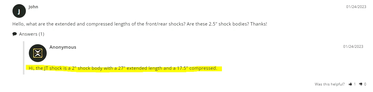

Hm, so the full F&R kits are available only with non-adjustable plain 2” shocks because using anything other than their secret special shocks will void the air spring warranty. But the rear kit does not include shocks at all, nor any specs on proper length. Just a limit strap
No way would I ever go downgrade to non-adjustable shocks. Especially with a system like this
I agree with the shock inquiry (as of 1/18/24 I asked the question on their website section)... per their questions section for the FULL SYSTEM on the website, I'd say as long as you stay within the parameters of the extended/compressed lengths of the JRi 2" shocks then you'd be fine running your own choice. I don't know if that affects any warranty of the rear bags though.

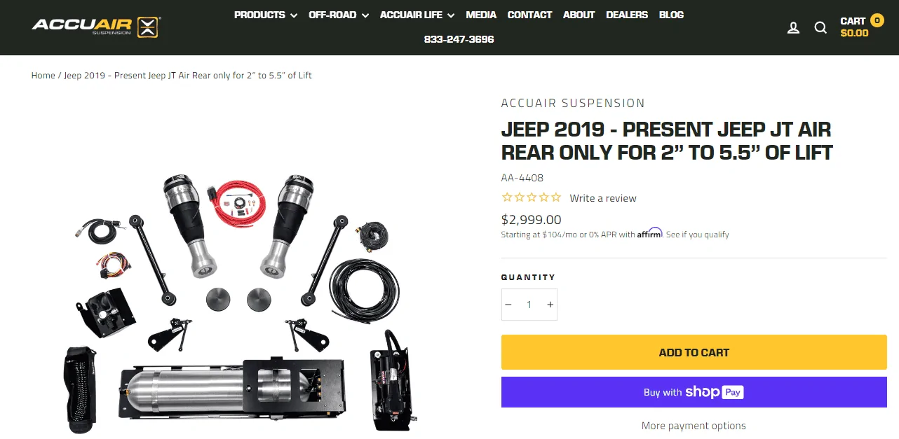

So given that stock Rubi shock lengths are 24 and 25.5, the supplied 27" shocks could be a reduction in available wheel travel if you bump for 37's on a sport. Definitely less travel than a "properly" setup sprung lift....even though most aren't supplied that way.
I want to like this kit and I have been toying with at least a rear air bag replacement.....The complexity of a system that would most definitely consist of imported parts and the possibility of something like a stick puncturing the bag leaving you in a bad spot a long way from home have kept me from pursuing it.

I wish I could remember where I saw the claim that using anything but their shocks would void the warranty, or find it again. Currently the FAQ on their site says:
Are the shocks in the kit required or can other aftermarket shocks be used when installing?
The JRI Shocks we have included in the kit are specifically designed to work with our Dynamic lift kits and we know these shocks are the best option for optimal performance with our kit.
https://accuair.com/pages/frequently-asked-questions
So let's downgrade that to just a rumor. I hate to spread misinformation. It's good that they're willing to share the compressed/extended lengths - I hadn't found that info anywhere before now. I also note this encouraging FAQ:

And huh, the shocks in their kit are straight non-adjustable, non-reservoir shocks but they seem to have added these as an option:
https://accuair.com/collections/shocks/products/jri-jeep-jt-adjustable-shock-kit
Separate low and high speed compression adjusters, reservoirs, and $2400 for front and rear is not totally unreasonable... Looks like 2" all around though, and for the money you can have 2.25" falcons or 2.5" fox. Weird that you can't upselect these in a kit? Probably you can if you call and talk to someone. Good info there too:
Will these work with the Air suspension kits?
Yes, these will work with an air suspension system.
What is the front collapsed and extended shock length and rear?
All in inches Front JT shocks is same as JL fronts Extended 27.81 and Collapsed 18.06 Stroke 9.75 Rear JT Extended 26.88 Collapsed 17.28 Stroke 9.60
I'm in the same boat as wanting to "like" this kit.. a lot. I would feel more comfortable with a rear only airbag setup. I have a Rock Krawler 4-link rear and honestly it's as simple as dropping the rear shock bolts at the axle out to allow the rear end to droop enough for the springs to simply fall out. Not having a trackbar is great :) Not saying I would, but I could easily carry around a set of traditional springs for a trail repair. The biggest hurdle for me with the 4 link is to find a way to retrofit the auto leveling "tabs" on the RK upper links.

I was considering the Timber Grove rear bag replacement kit, but when I pressed the owner for travel measurements, he couldn't give them to me?
Then there was the issue of air management and possible failure 1000s of miles from home while traveling. I thought about carrying a replacement bag, but our trucks are already overloaded and limited on storage space especially on a trip. Manual fill would take better than half the risk of failure from the equation but that in itself is a bit of a pain when your bags are the sole method of vehicle support?
Retrofitting a link with a mount for the height rod shouldn't be all that difficult? A simple tab like this one hose clamped to the tube could work? https://www.ruffstuffspecialties.com/R2596-02.html?gad_source=1 I was even considering just using a manual valve from say a semi tractor suspension.
