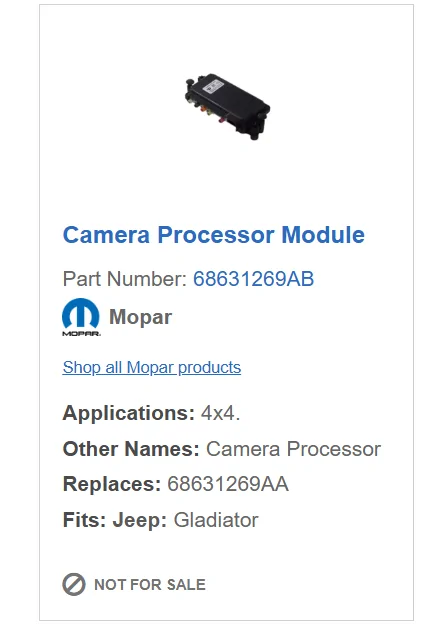

CVPM 68631269AB but shows discontinued....can't find anywhere online. Might be an AC revision coming soon.
Jeep Gladiator Adding a front trailcam 1761076089060-wv
