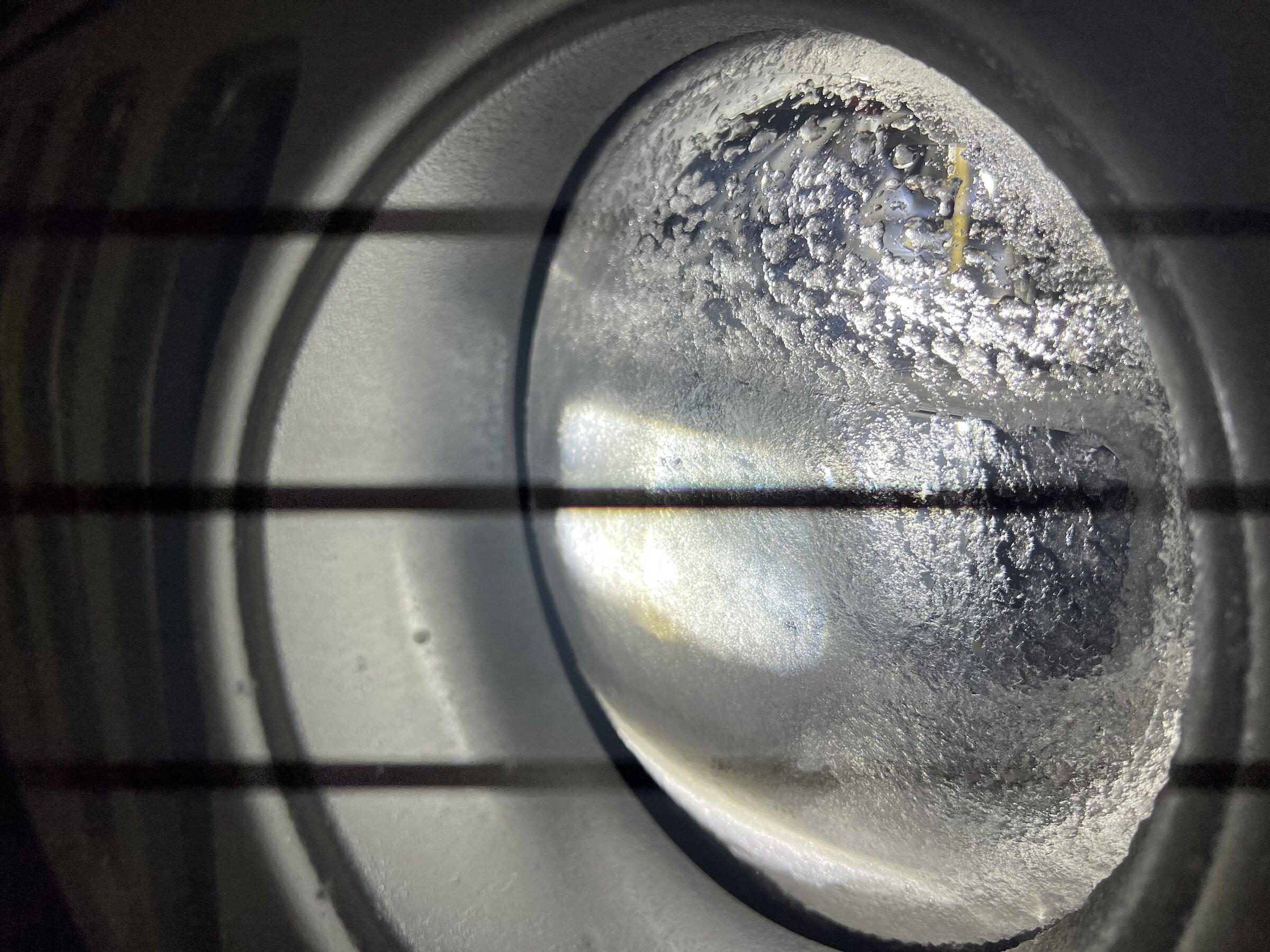

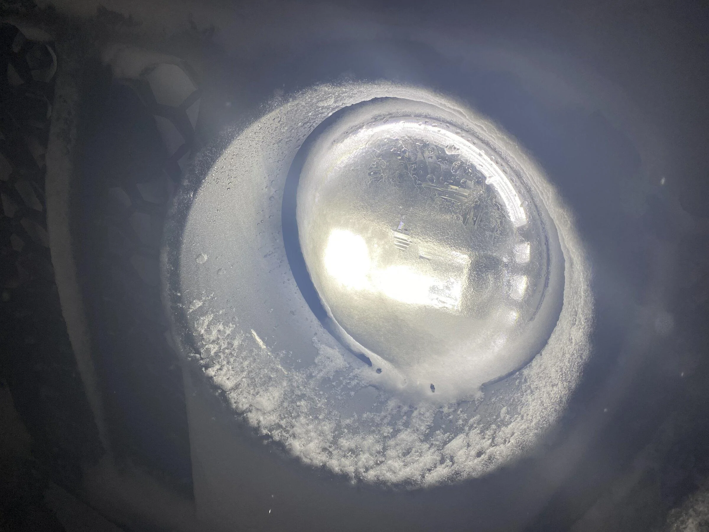

OP It sounds like you just got cheap LEDs which is exactly what I would expect to happen.
Can anyone confirm this happens with oe LEDs?
I am looking to upgrade from my stock halogens to oe LEDs but certainly dont want that problem.

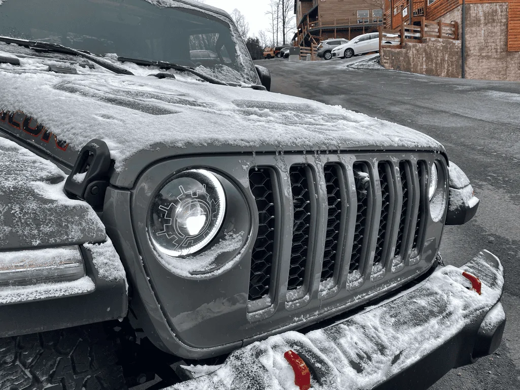

It will happen with any LED headlight due to inherently producing less heat. This is why we designed a heated lens variant of our popular Oculus headlight.

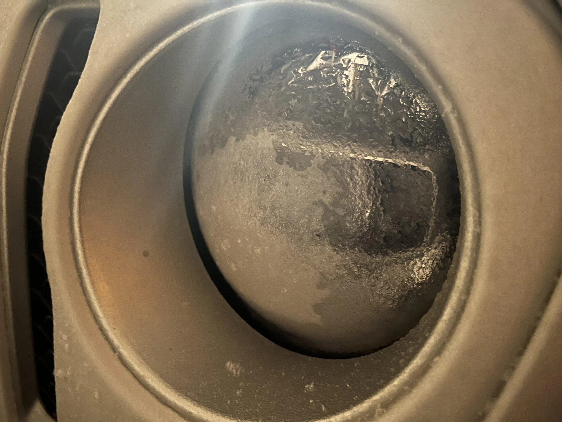

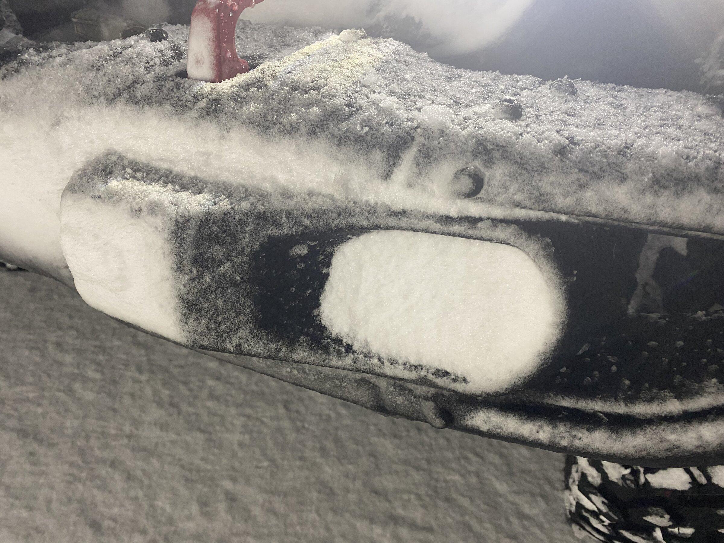

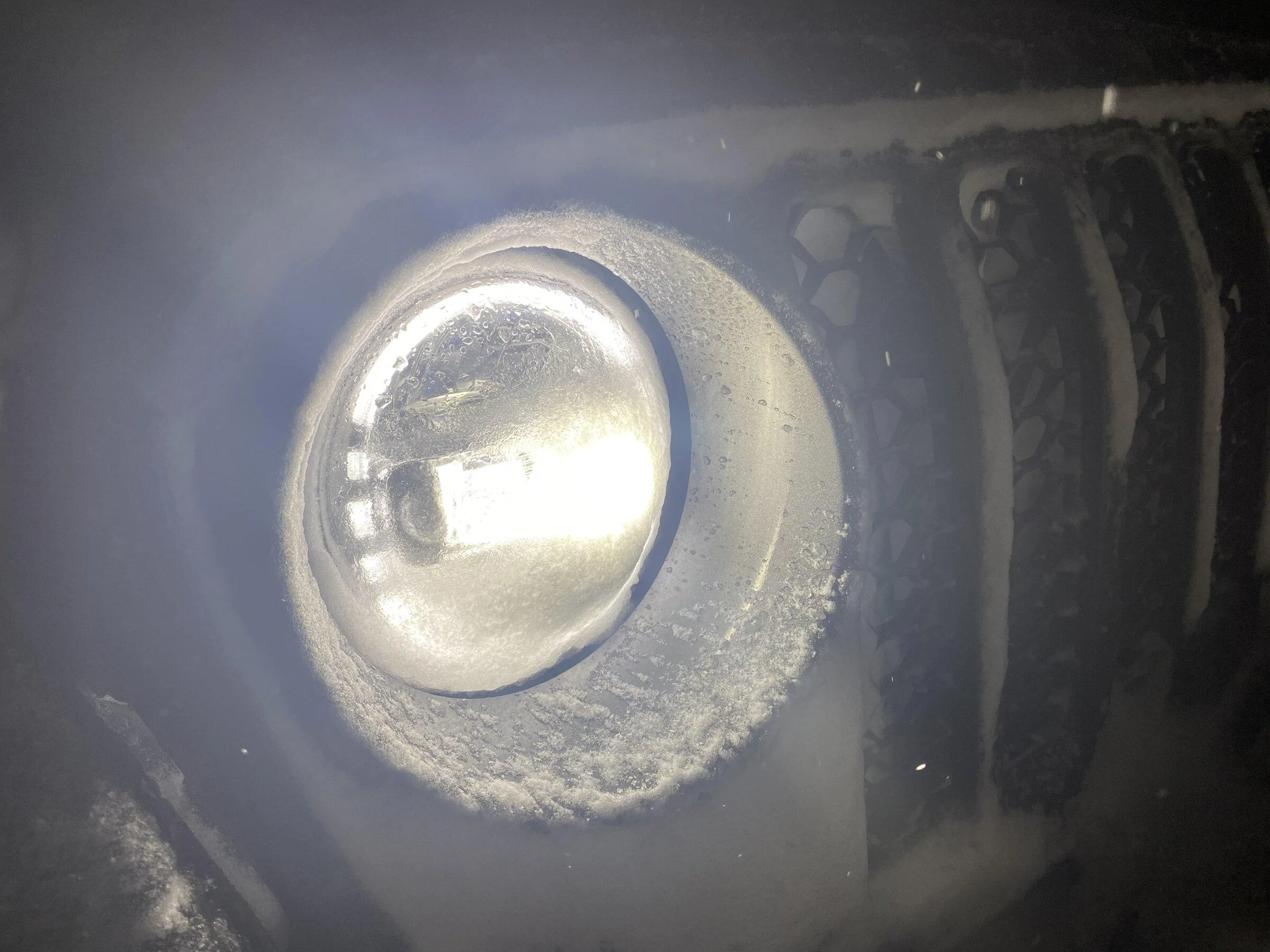

OE LEDs in a minor snow storm last week.
Jeep Gladiator Adding Halogens! Enough is enough! 61882361-307A-4F21-84C6-A2BA315F554B
Jeep Gladiator Adding Halogens! Enough is enough! 4415EC5A-F1D5-4648-A360-567AE249A908
Courtsm3
Courtsm3
Kayle
Nov 22, 2020
504
862
Whistler
2020 Jeep Gladiator Sport S
Thin Blue Line
Yup
Mine do the same. As Oracle states, this happens to ever Jeep LED unless it has a heater element on the lenses

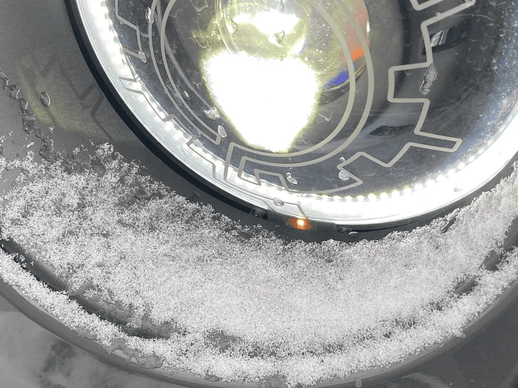

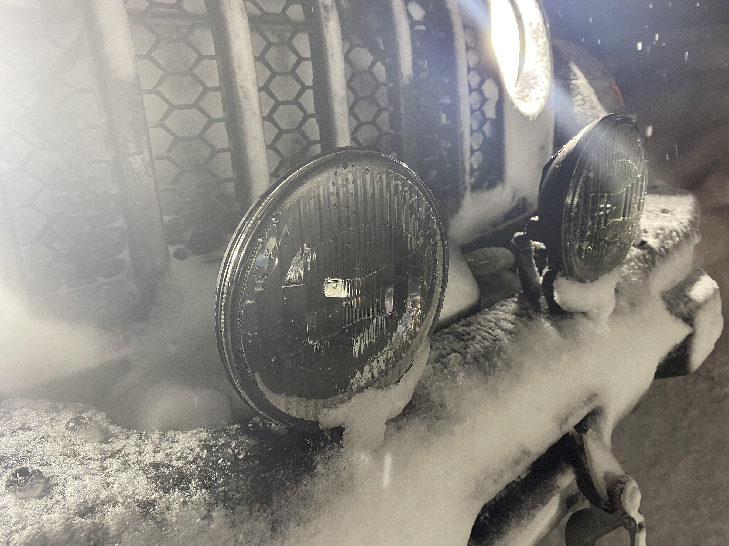

Case in point last night, nearly full white out.
Love my hella black magics. Lights simulate headlight beam pattern, thats what got me home safe without having to stop every 5-10 mins. Look at my fogs!! Packed solid.
Jeep Gladiator Adding Halogens! Enough is enough! 020FEE16-AD64-4705-A85D-937948C392A6
Jeep Gladiator Adding Halogens! Enough is enough! 4357B2E7-5565-4349-8B8B-518C9E84DB2F
Jeep Gladiator Adding Halogens! Enough is enough! 23A3CA19-C798-4D04-B9E0-FCD83E1B53CA
Jeep Gladiator Adding Halogens! Enough is enough! D58C67AD-605F-4235-AABF-902D3CDEDD56

In cold snow, no issues but when its right around the freezing mark with heavy wet snow, it always packs up. This is a known issue in this type of snow and other cars arent immune. My wifes bronco with factory LED headlights did it a few days ago.

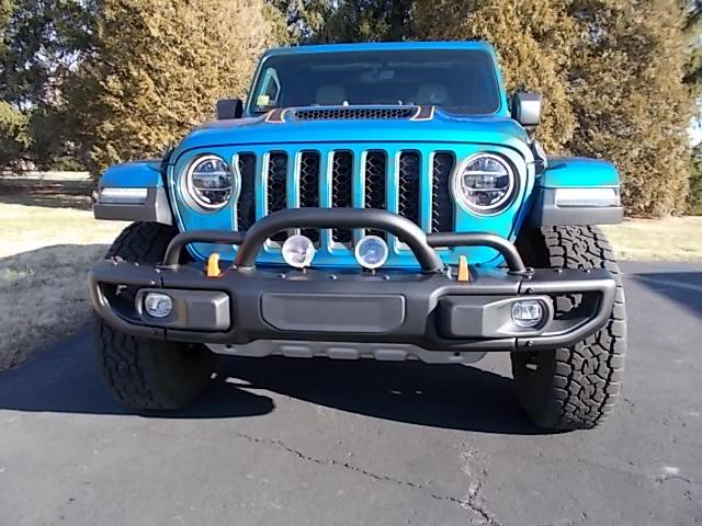

Had the same happen with my factory LED headlights & fogs while returning to my home in NW Ohio from my sister's place in SE Michigan at Christmas.
Heavy wet snow conditions like this are very common in this part of the country in winter.
My similar solution was to use a set of halogen PIAA 510 ion crystal fog lights that I had kicking around. They have a nice tight beam pattern that doesn't blind oncoming traffic, & put out more than enough usable light on their own to see where you are going. Added bonus, they generate a lot of heat to keep the lenses clear of snow & ice.
