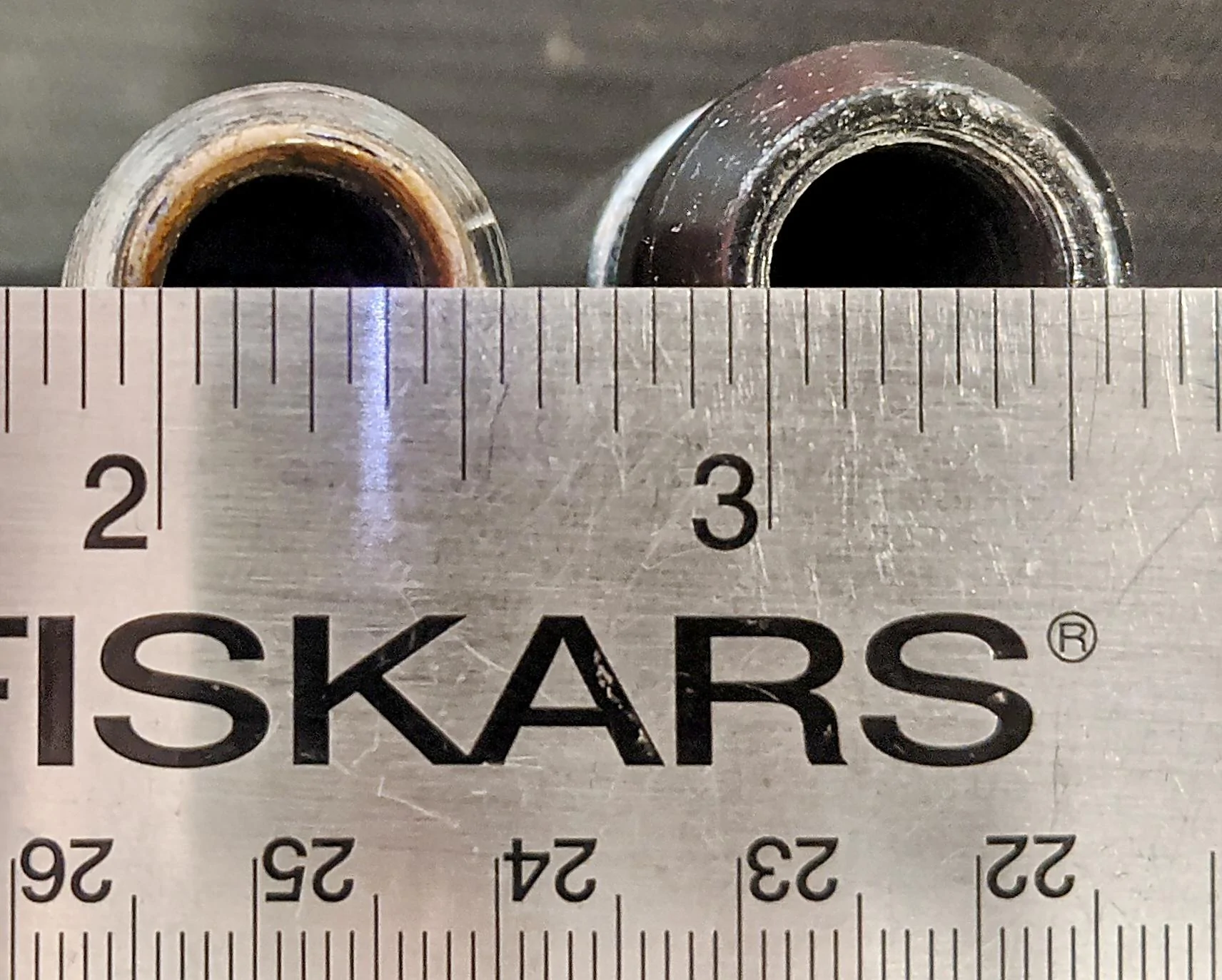

... I wouldn't know if there is a special nut that can convert to that wheel or not, but they refused. I hear the changed the stud size to 3/4" a few years ago. ....
That got my curiosity up enough to go out in 24 degree weather (13 degree wind chill) and pull lug nuts off my JK and JT. I had no idea they were different sizes. They are, but maybe not quite 3/4" on the JT (I know they're 1/2" on the JK because I had to replace one many years ago, and that's what I bought). In fact, at a casual glance you might think they are the same size. Regardless, on my JK I have a quarter million miles with aftermarket wheels that have a lug nut pattern and hole size that would easily fit on the JT (except they are 16" diameter wheels, not 17"). I've never had a problem with loose lug nuts. But, on the JK I did replace the lug nuts with ones for those wheels. Just as I did for the JT many years later.
EDIT: I do know that sometimes the big name tire stores are reluctant to do anything that isn't close to OEM spec. We see this occasionally when fitting larger tires on narrower rims (poor man's beadlocks). Often times, mom and pop tire shops will do the work. Maybe next time you can't get what you want, try that.

Well it looks like the dealership put the wrong size lug nuts on from the get go. The outside was to thick so it was almost imposable to get a socket between the lug and the wheels wall. My mechanic explained what I needed and didn't charge me a thing.
I took it back to the dealer and explained to them what had happened. The parts guy had no idea what lug nuts I was talking about and the service manager told me she could not look at it till Wednesday. I am amazed at how poor some business customer service is.
So today I took my boys car to town and picked up everything I needed to fix there mess up myself. The lug nuts where $50 and I bought a socket set, torque wrench and a breaker bar. Another $50. I was able to switch out the lugs and check for any damage in about an hour. Everything seams to be good now and I will retoique them again in a few days.
